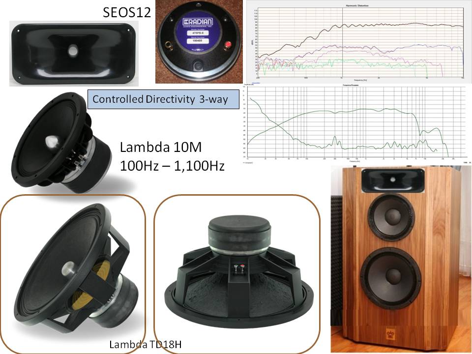

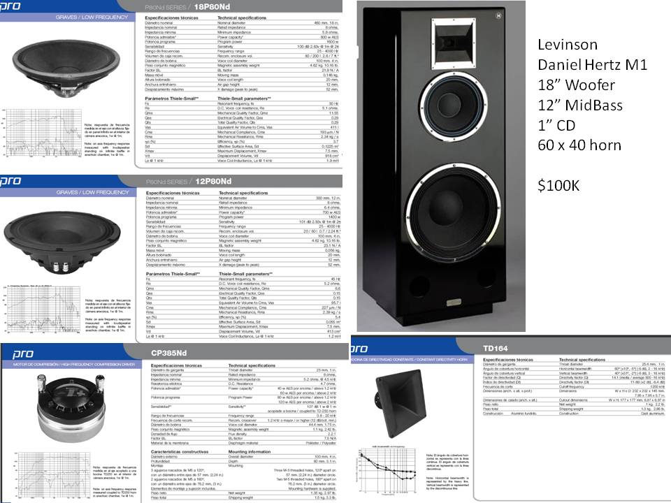

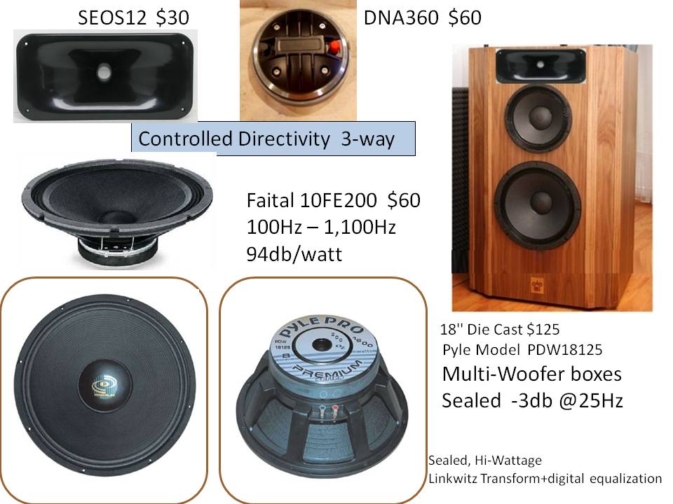

Life demands many compromises. ... your speakers do not need to be one of them.
Consider building a high efficiency 3-way speaker. An 18" woofer requires a large cabinet to generate deep bass, and adding a midbass and small SEOS waveguide tweeter will increase this volume by about 30%. You could also build a bass box and seperate Econowave midbass+waveguide box. These options are smaller than an 18" box plus a LARGE horn covering 500Hz and above.
The Econowave projects combine a 10" - 12" midbass with a SEOS waveguide and 1" compression driver for controlled directivity DYNAMIC SOUND. There are many positive reviews.
I built a home theater center channel using a 15" Lambda TD15M with a SB29RDCN dome tweeter attached to the large phase plug with a section of rubber bicycle intertube. A great vocal range center channel, but a poor full range.
