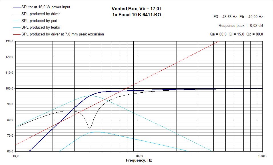

Using Unibox to simulate the 17L vented cab you want to build yield this:
attachment.php

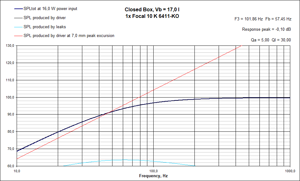

The same 17L but closed is this:
attachment.php

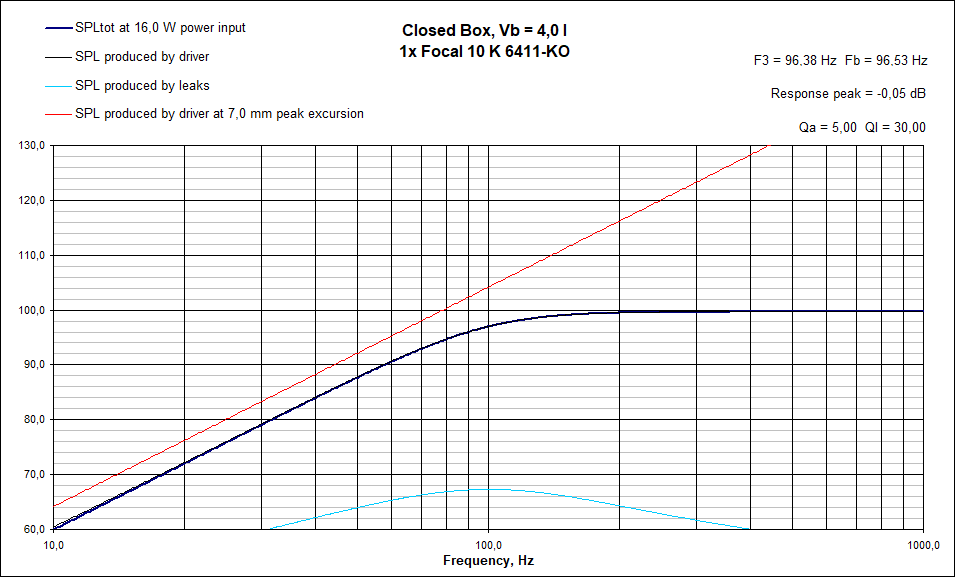

A better closed box is a 4L enclosure:
attachment.php
The summary: the Alpair driver with its Qts can't produce bass in a closed box of any volume. The best closed box of only 4L is useful for an integration with a sub, with a F6 point of roughly 75Hz, whereas the 17L closed box has a rolloff starting at 300+ Hz, and very poor handling as it will exceed xmax at 45Hz with 16W of applied power. The vented box of 17L tuned to 40Hz provides useful bass and good power handling as it will exceed xmax at 35Hz with 32W of applied power.
