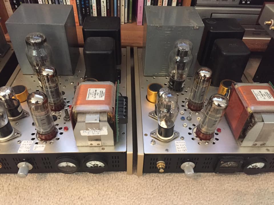

Modified version of Williamson 807 or EL34 PP amplifier
Here the picture
This is my building.
The power tubes are being biased for class A operation. The common cathode resistor works like a differential amp which balance the gain between the two power tubes. The bottom variable resistor is used for DC balance of the power tubes. A 1000uF bypass capacitor is used to avoid AC signal feedback to the grids. This arrangement reduce the THD in the power stage.
Johnny, can you explain the bias arrangement in the cathodes of the power tubes? I'm not sure I understand what you're doing there.
That's the classic Williamson balancing arrangement. By connecting the grid resistors to the 100 ohm pot, you can precisely balance the output tubes, which was considered critical for best low frequency performance and lowest distortion in the original Williamson design. Rather than adjust the cathode resistance, you're actually adjusting each grid's relationship to ground by a handful of volts. The grids are still negative with respect to the cathode, but if you measure grid-to-ground they actually measure positive by 4-6 volts. It's a clever design and is very stable.

Did you consider adding the suppressor circuit mentioned? It could be that using it as a pseudo-triode makes this less of a consideration.
In very high-voltage situations, like transmitting devices, the 807 needs some special care. In the Williamson design, with the plate voltage limited to 375-400VDC, it's never been cited as a concern, and I've never had a problem.
