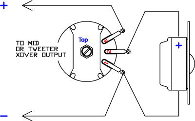

I have all my equipment and parts ready to go, only issue is I am having trouble with the crossover layout. The diagram I drew up seemed simple enough but now looking at the way JBL did their crossovers and utilized the L Pad it’s getting confusing.
I’m looking for assistance on how to layout the crossover using these parts on this fairly simple crossover design? Feel free to draw a picture for me lol.
Thanks in advance!
This is the layout I am going for, just not sure how to wire it all up.
Hard to follow what is going on here. Either replace the components in kind with the same (or close) values in the same spot--maybe this is what you are trying to do or go for a modified crossover such as Dennis Murphy has done for these.
The OP plans to use inductors and capacitors which are close, but not exact, in value to the ones shown in the schematic.
Perhaps a diagram of how to physically wire an L pad would be of assistance?
See attached:

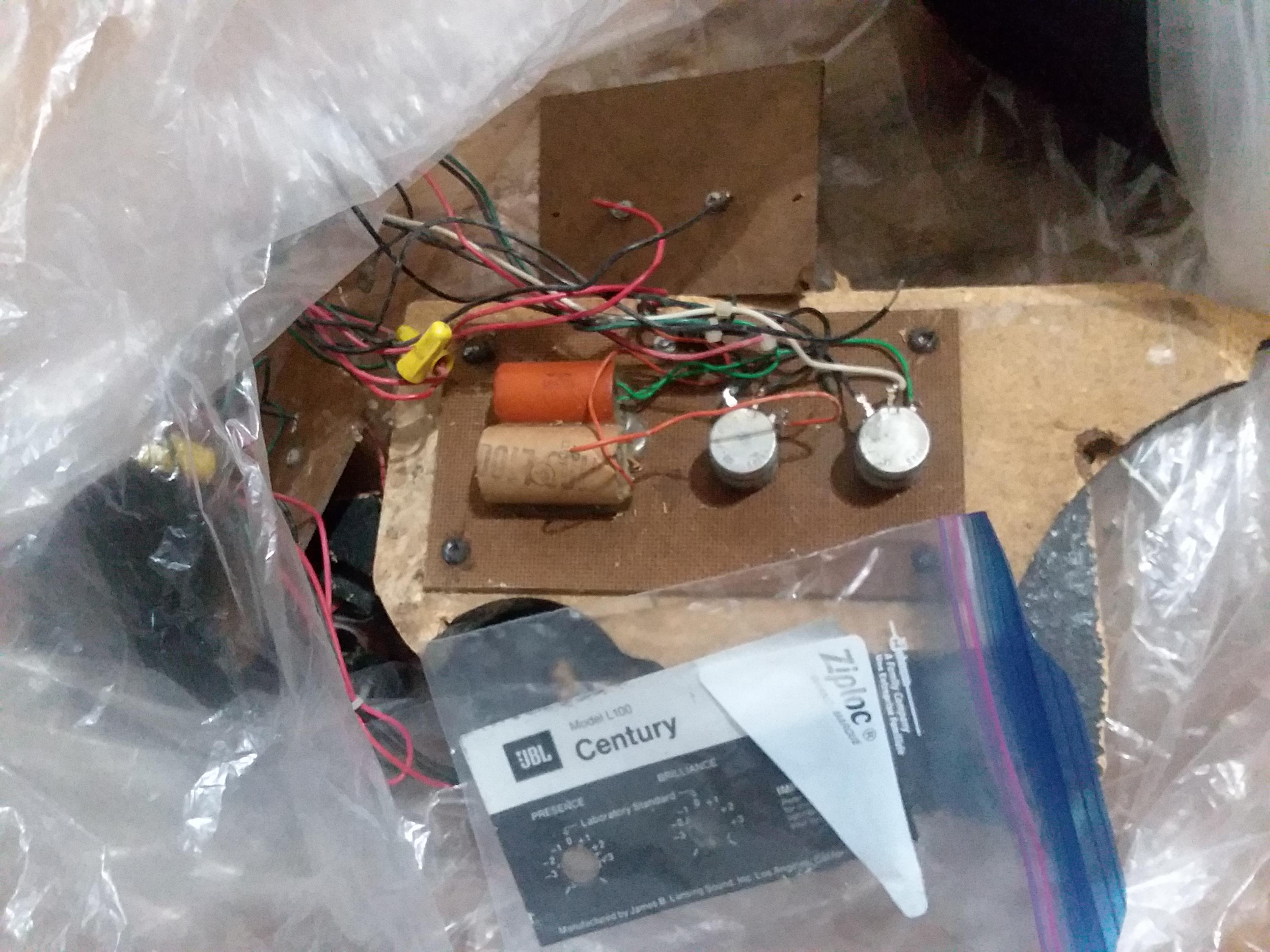

To be honest, why in the world would you want to apply a crossover from another speaker to this one? Strangely enough, I have a pair of the L100 crossovers in my attic. Me, I'd replace the two caps with polyethylene caps from Parts Express (Dayton or Solen) and definitely replace the L-pads, those are very problematic. No inductors as far as I can see, but maybe I missed them when a broke apart and disposed of the cabinet. The audioheritage site has some knowledgeable JBL people, might want to investigate that.

Hey all,
The reason for wanting to apply a new crossover is because I needed to replace the caps and this crossover came with an entirely different crossover than all the other JBLs L100s (L100a). In my opinion it’s a terrible crossover design as it barely utilizes the tweeter at all and muffled the midway to the point that the woofer is doing most of the work.
p8k4uQOJmK3FP9lg9HEDk2Lfw-1lbKHwDwt5qBMbVHZbVHpEHrXk77VaaMBJPAUcQY5aN6IByL5Dhuv7aGW0PQPpf0R5v9LGqtDusZOoTjopPWUmKdXAMGSUQb7cOrq6hNRvm7yXQw3HoEdWAw
I believe the components and crossover design I created will give me an hybrid of the L166 and L100A. Basically an L100a or 4312 without the natural roll off.
Thanks for posting the L-pad diagram it makes more sense now. After watching a couple of videos I think I was making it harder than it really is. Looking at the original crossover design and trying to make sense of it was overwhelming.
