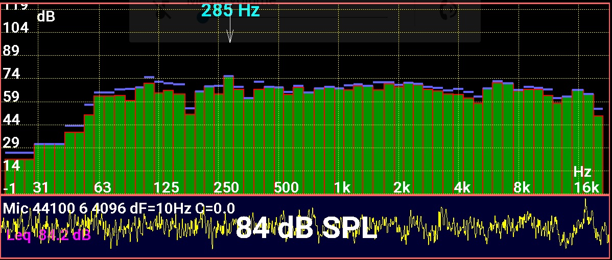

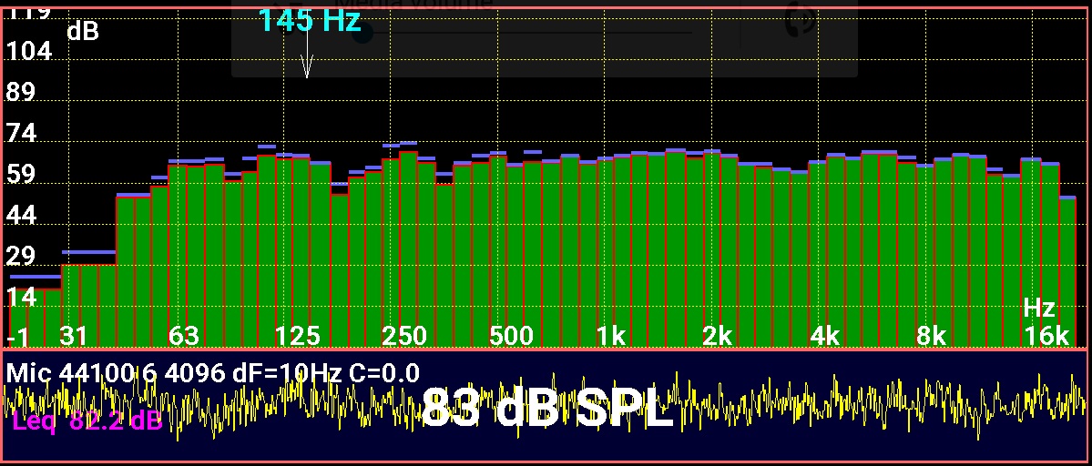

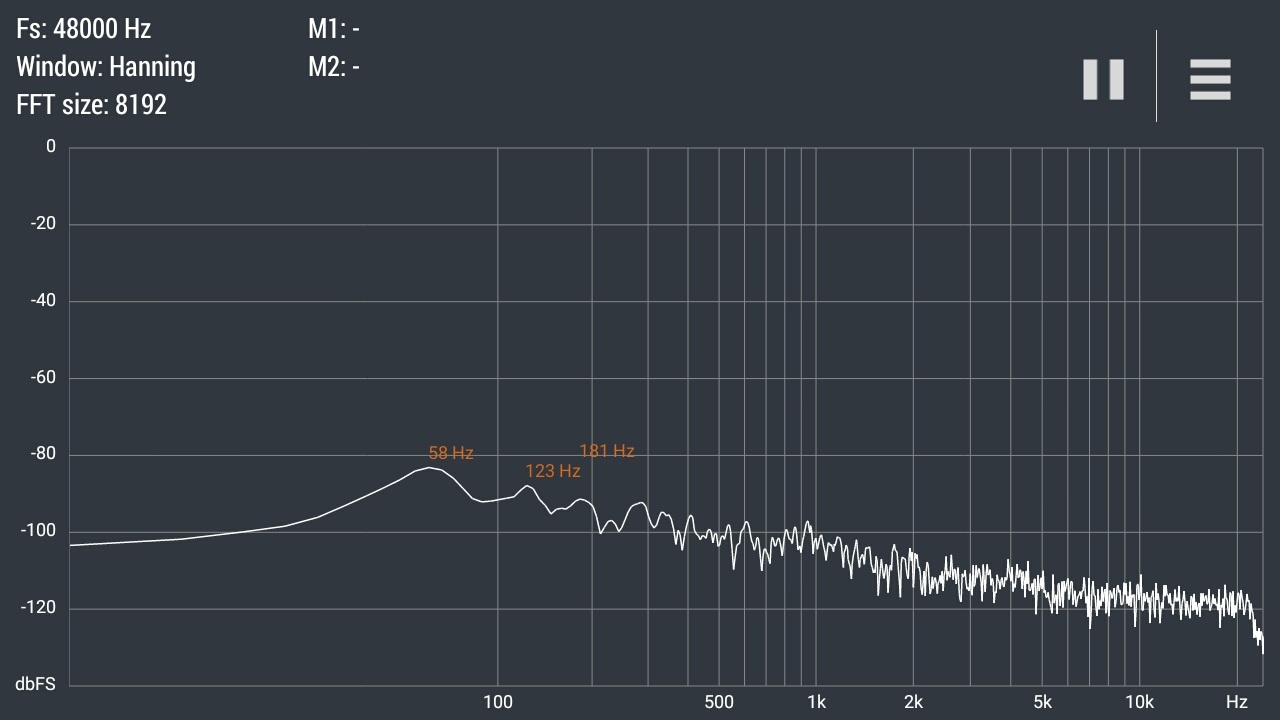

Yesterday, I got my Dayton iMM-6 calibrated mic for my droid phone using an app called Advanced Sprectrum Analyzer and did some quick measurements of both speakers using pink noise, on an Audiosource Amp 3 class A/B amp, without calibrating the mic. The first 2 pics are with the mic about 3ft away. The second are about 10 ft away aimed at the NE123-08. Definately shows a rolloff as it approaches 20kHz. Tonight I'll download the calibration info and retest tomorrow to see if there's any change. The yellow graph is when I used the peak hold function.
At this point, consider them "relative" measurements... The Advanced Spectrum Analyzer App appears to work pretty good, but even in a "quiet room" has the same type of curve as above.

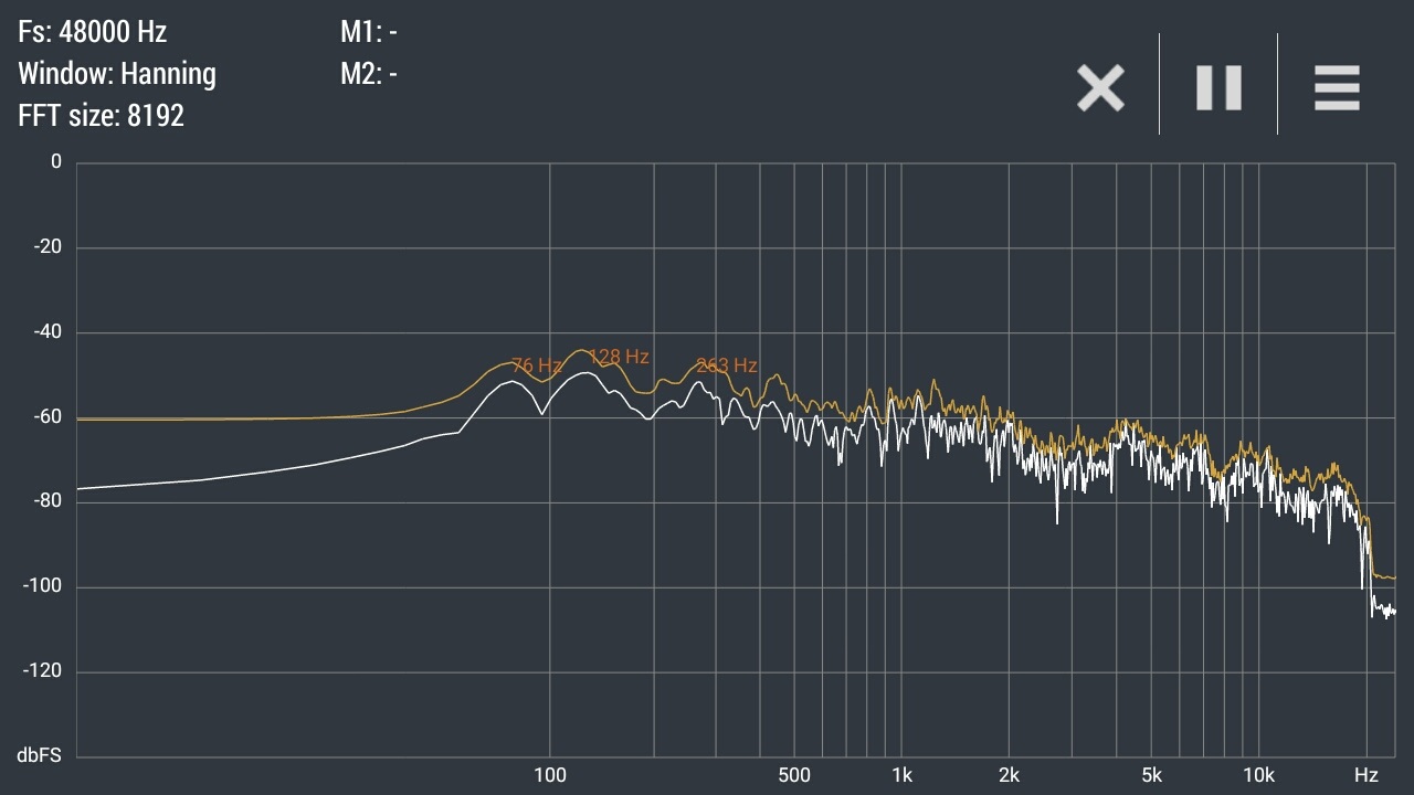

I'm looking into another Android App, called AudioTool. The previous app although free does not appear to accept external mic calibration data.
I'm having trouble making the Audiotool App accept my Dayton iMM-6 calibration data. This app however, does seem much more flatter with the external iMM-6 mic. I did pay the $8US for this app because it was advertised to work with this mic, along with the cal data...

can we trust these measurements?
Oh I think I see from your perspective now. That App has no resolution below about 80Hz... I never paid attention to any frequencies below 100Hz, obviously a critical measurement for these speakers. I'll take some new measurements with the new App called AudioTool. Still haven't figured out how to cal mic.
Also, instead of doing a distance test with the mic, I'll get close enough to where the Analyzer tool reads the Vifa driver SPL average, which is about 87dB abd report the distance.
EDIT: no tweeters in this test.
Left and Right individual measurements about 3 ft away from speaker, level with the Vifa driver. Final, 3rd measurement at listening distance about 10Ft in the middle.

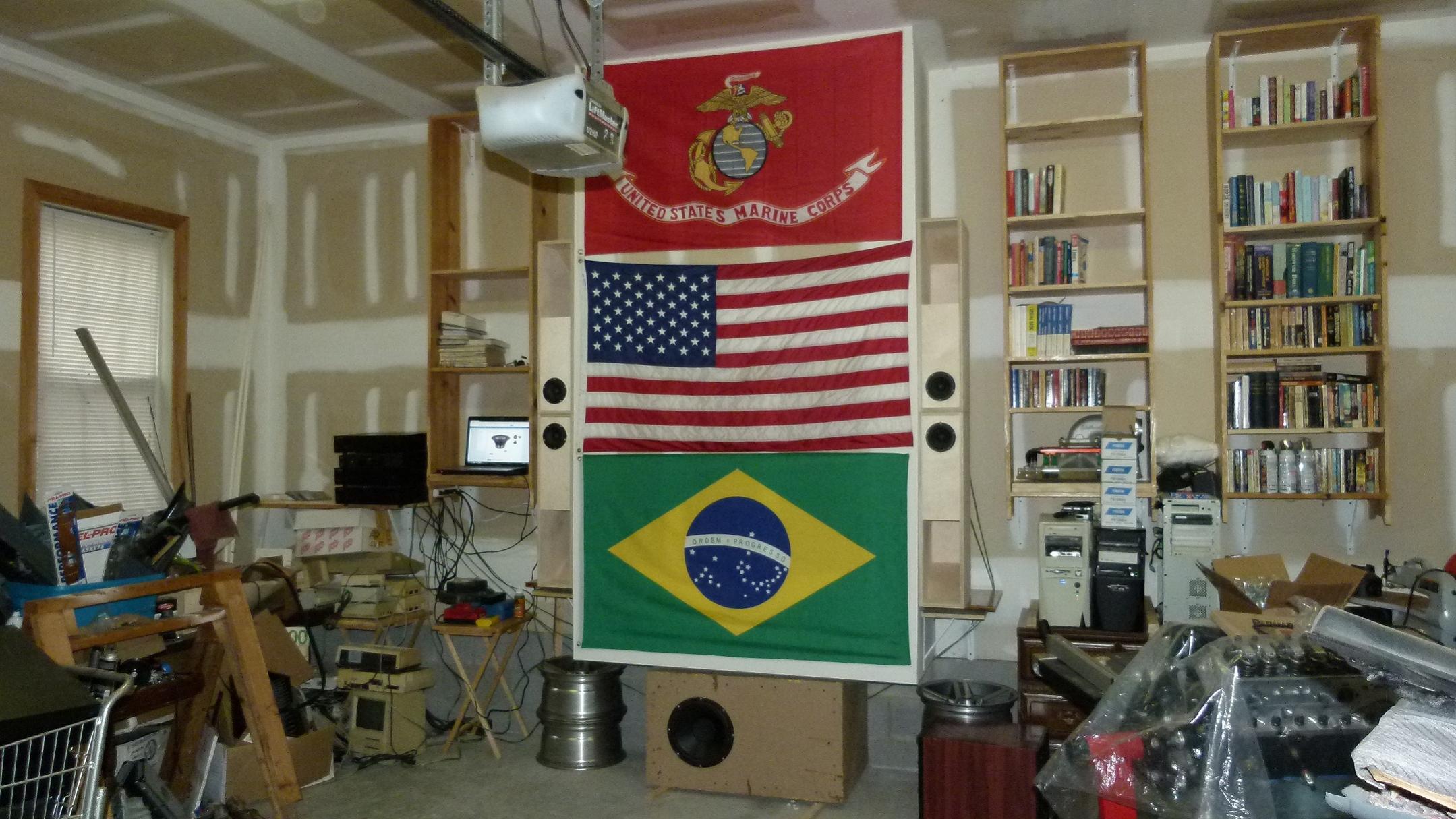

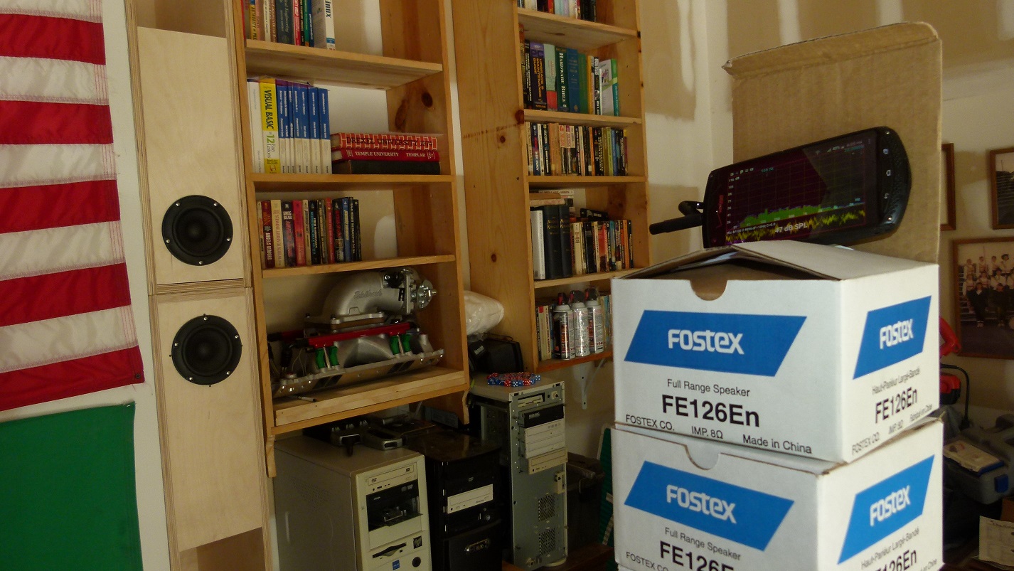

Just assembled 2 more BK12m's last night with 2 more Vifas. Here's how I arranged them in my man cave, i.e. garage without the '86 IROC. It had to go, sadly. Temporarily, for the pic, of course!

You might want to try and reduce the reflecting surfaces from that stack of Fostex boxes the mike is sitting on

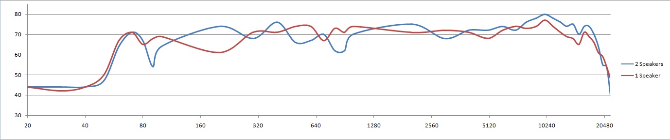

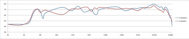

I loaded REW into my laptop and what a program, I will for sure donate to the developer! The frequency generator was used to produce sin waves from 20Hz to 22kHz in order to test the right channel only. Mic was 3.2ft away from the speakers. I have 2 amps powering each L&R pair of BK12m's, so it's easy to shut the top amp off to disable the top speakers for measurement.
I measured and recorded SPL values on paper and 'attempted' to use M$ Excel to make a graph. I partially succeeded. Some very interesting stuff. I love the science of it, and the connection to my brain that says I hear that.
Right, I see what you're saying. Those boxes are surely resonating at lower frequencies and transferring energy to the mic. I'll try hanging the cell from a string attached to the ceiling and retest.
