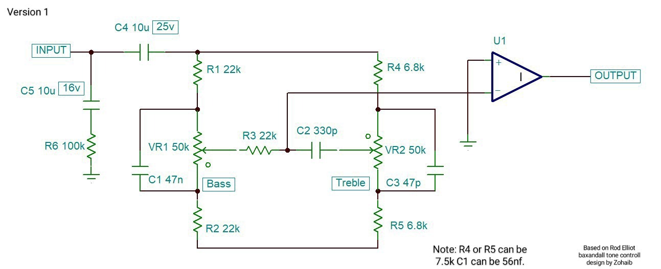

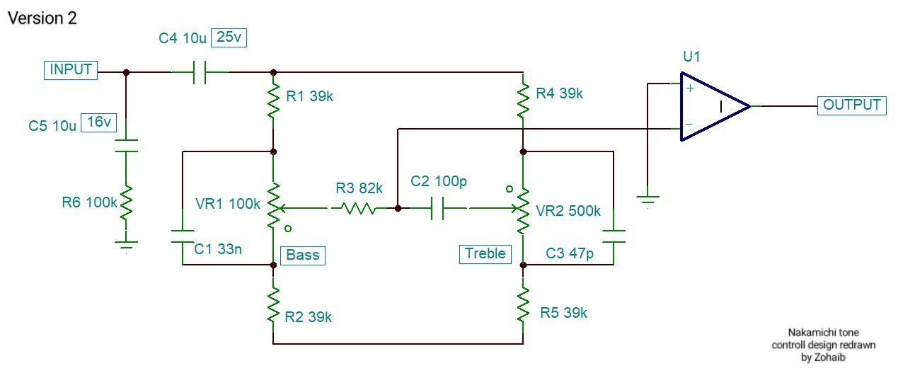

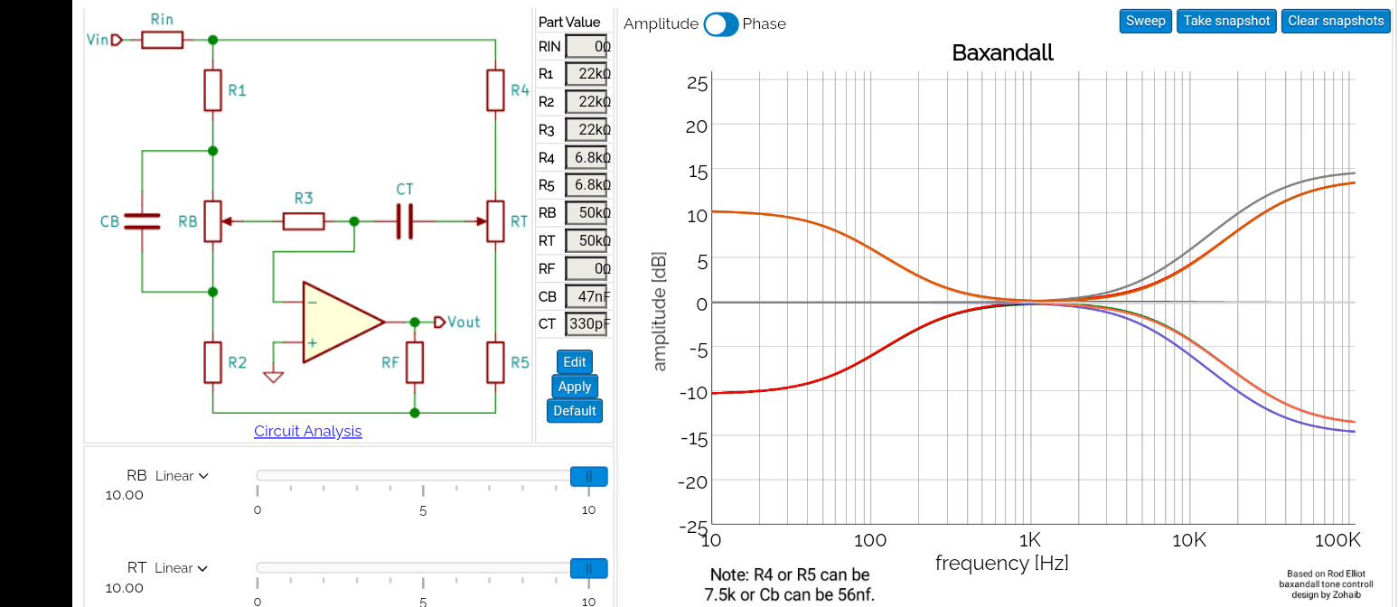

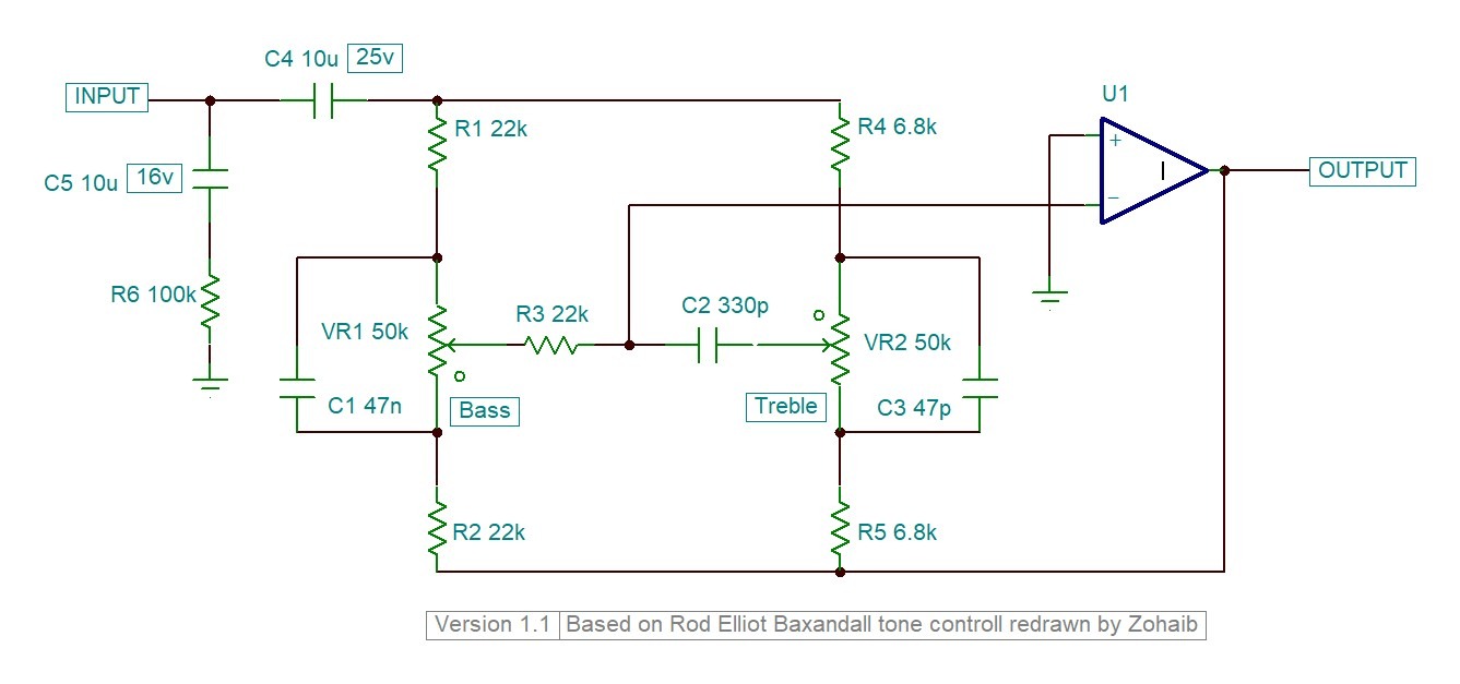

Modified Baxandall tone control
Modified baxandall tone controll using b50 k linear pots for bass & treble.

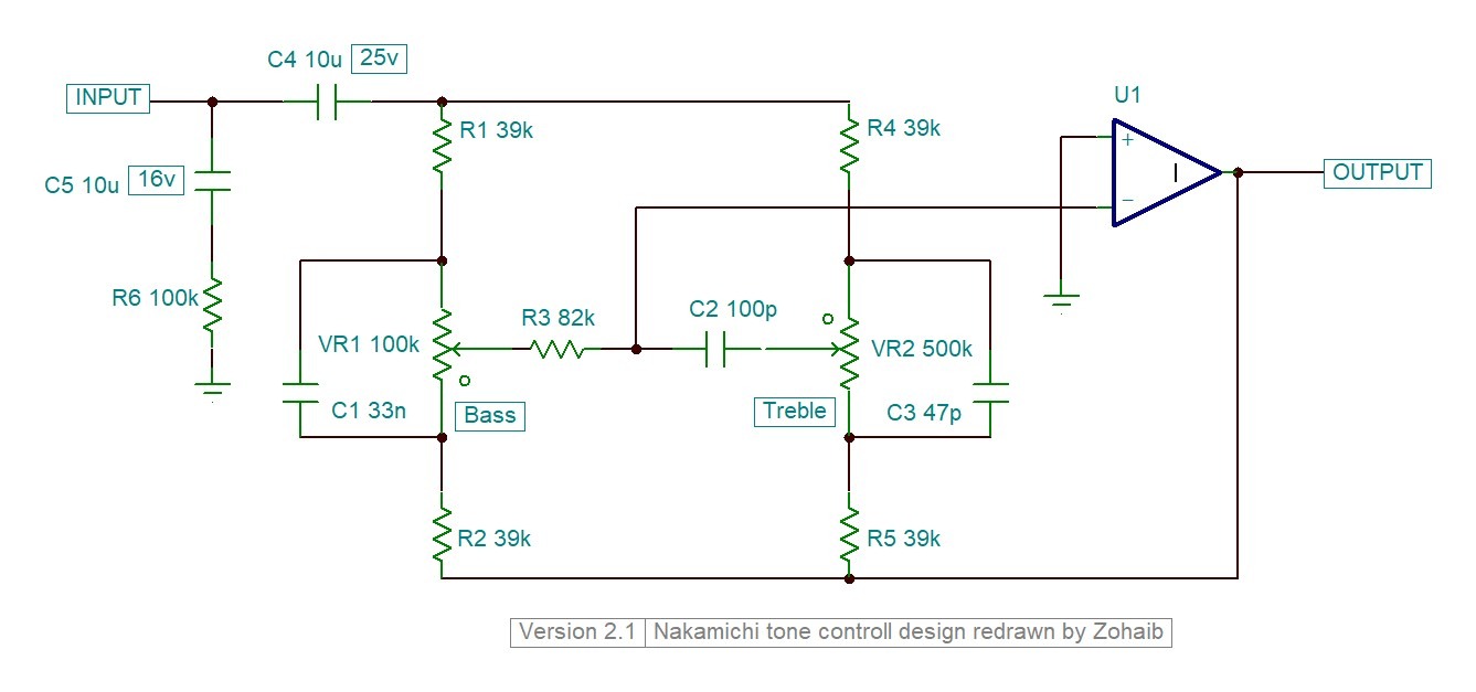

You might find an issue with the opamp feedback connection in V2🙂.
Using 50K pots will make it easy to drive, but it will be a bit noisier and more prone to hum and noise pickup than designs that use smaller value pots. The smaller caps may be a bit cheaper though, so good for a lower cost design.

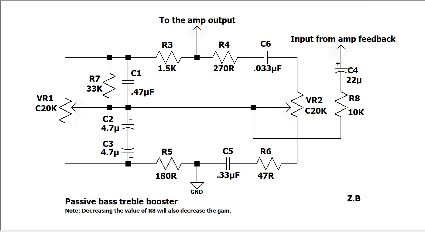

Can’t see anything active about that from the segment you’ve posted.

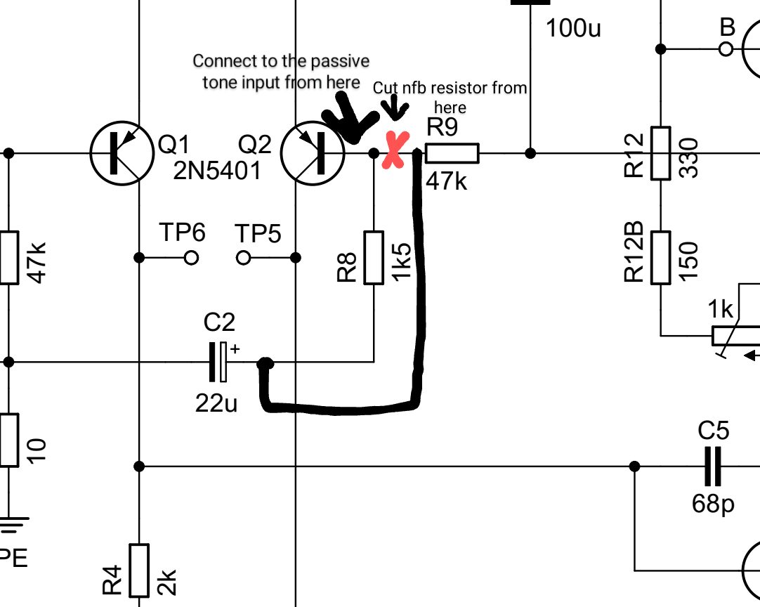

This is only passive tone but actually it can work with active tone. If u have already active tone controll in your amp then you can add this one to your amp. Then your amp will have dual bass & treble controll. It will boost your amp bass and treble. It will give you sub bass.
But you have to cut off your amp nfb resistor and connect it to the capacitor then it will work. But di it safely.🙂
Here is example
If you already have sn active tone control why do you need this? I still can’t see anything that is either active or Baxandall about it. Please explain
This is not active or baxandall type tone controll. This is a different from other tone controllers.
You are asking that if we have already an active tone then why we need this?
Let me explain. This type of tone controller is basically uses in class A amp to improve the dumping factor of amp.
If you have an amp like class A or you are already using an active tone controll with your amp but if your amp has low bass & dumping factor then it try to add this tone controll. This will give you bass like sub. I think you should try this at least once.🙂
