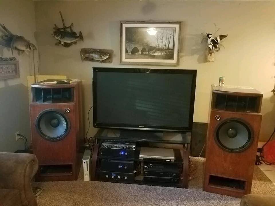

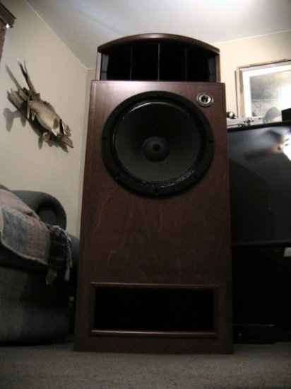

Hello All,

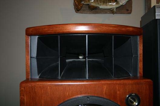

My brother and I built some modified Altec Valencia speakers several years back. Woofers are 416-8a in a 10cuft vented enclosure (thanks GM). 806-8a's on 811-b's. The horns are mounted and coupled to the inside of the cabinet which quieted the ringing, and bloom, down quite a bit. We tried various dampening and we didn't find it helped nearly as much as coupling the horn, then minor dampening. Tweeter Fostex t90a. He also has my Horn Subwoofer hooked up, bought off of John Sheerin many years ago.
Crossover is stock Altec n800-8k. My brother is looking to possibly rebuild the crossover with new fresh parts. But he doesn't want to take that big Altec voice away.
I've read through hundreds of threads on Altec crossover redesign and I keep getting hung on the fact that I don't know the posters preference for music reproduction. When they say improvement I've really got to know what they like, and what they're after in sound improvement.
What he likes, and doesn't want to lose, is the big Altec live sound. When comparing my brothers system to my DIY EdgarHorn system I always thought of my stereo as being similar to a live concert sitting center room. You get the instruments, the musicians and you get the room in the presentation of the sound. On his, it's like that same live event, but sitting third row...right up front.
My abilities electronically are a could read a schematic, wire, solder, etc. I could build, just not design. We've tried changing out a few crossover points quickly in his system, putting a simple 1st order on the horns. It took all the like away. This is what I want to avoid...I don't want polite Altecs! I certainly don't want them honkey either.
I appreciate your time reading my post and look forward to any advice you have. I understand that this very topic has been done so many times before.
Any crossover recommendations are appreciated. As are component choices or crossover points that you believe will help us get to our goals
Thanks,
Dan

Greets!
Then just clean the pot [or better to replace with a fixed grid resistor assy.], any terminals and swap out the caps with good quality PIO [prefer 'motor run' caps myself] to get a bit more vintage [arguably 'more'] Altec.
Most folks migrate/recommend the M19's 1200 Hz XO, but this takes out the horn's PA/cinema 'bite' ['bark'?]/'presence', so strictly for HIFI buffs to my way of thinking.
GM

Dan, you are certainly right to be cautious about "improving" the crossovers. Too many people who modify their old crossovers with modern film caps especially end up losing some of the magic of the original design. I find that modern parts can make a good first impression but you only notice the loss of musicality after using them for a while. Unfortunately most of the euphoric posts talking about how great the speakers sound with new caps are written before the new parts are even broken in.
I don't see anything wrong with experimenting with different crossover parts; just make sure you keep the old ones so you can put them back in if you end up disappointed. I would feel safe replacing old sand resistors with 12w Mills wirewound resistors of the same value. I would also feel safe about upgrading the binding posts and simplifying the wiring in the crossover. I did this with the crossover from an Altec 9849 and there were a number of jumper wires and unnecessary solder joints that I was able to eliminate through better wiring. Then I would consider swapping in a couple caps to see if you like the sound of them vs the originals. In the case of my 9849, the old Non-Polar electrolytics actually sounded pretty good; they were just a little edgy and not quite as detailed as some other caps I tried but still very musical and dynamic. After trying a couple caps, you could try replacing some of the iron as well. Again, the Altec chokes were pretty decent in the 9849 but they did add a slight edge.
