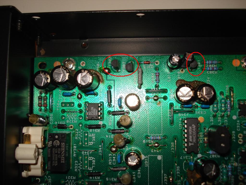

Then investigated removing attenuation components (free common tweak). Which does not appear to be applicable for this player as it uses a relay with zero effect on the audio
http://www.diyaudio.com/forums/digital-source/36610-muting-transistors-rotel-rcd-975-a.html

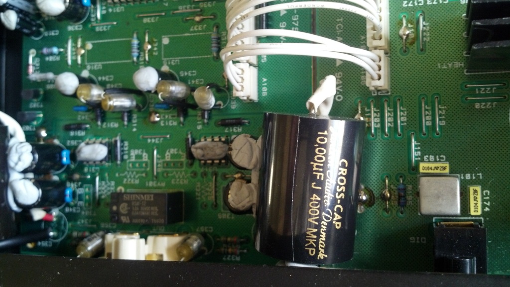

Replacing caps in output stage of CDP
17. Replacing the caps in the output stage for better quality Auricap caps (same V/uF values?).
Are these:
- the C356,C357 (see-through type next to output sockets?) CAP POLESTYRENE 160V 1000PF?
OR
- the C354, C355 Black Gate Elec. 16BGF1000 (16V/1000uF)? Which ones are most critical to change in the case of the RCD-975?

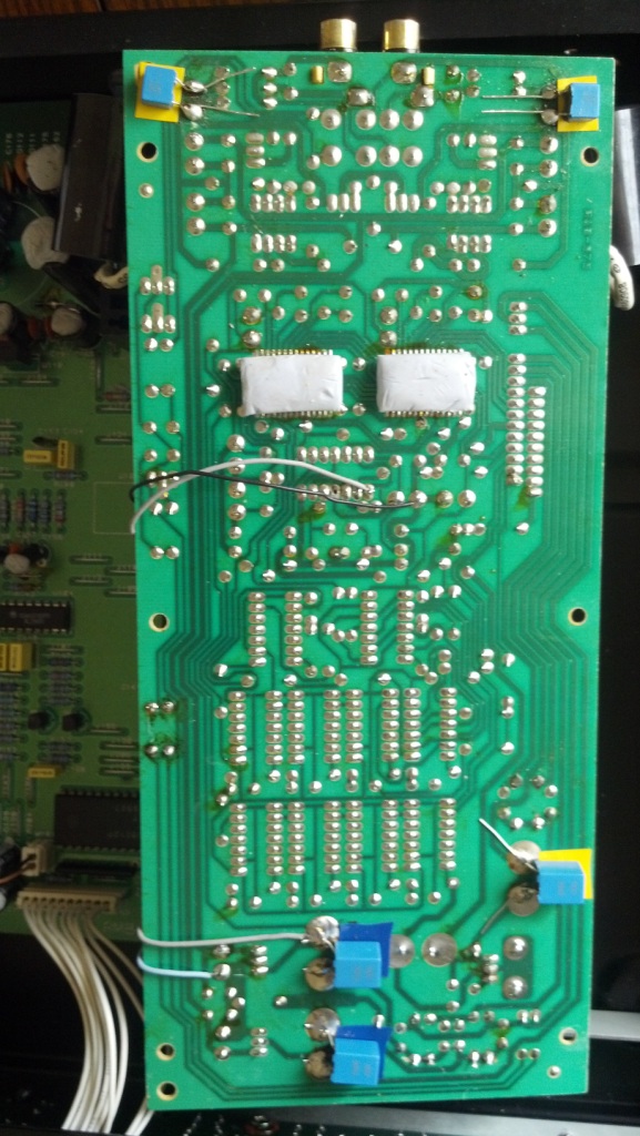

Phase A of mods:
A1. Main board p/s c185 & c187 to 4 x Panasonic FR 2700uF 25V (2 in parallel for each replacement). The FR claim to have same low FSR as the FM series, but with up to 10000 hours lifetime @ 105°C. Bypassed with VISHAY ROEDERSTEIN polypropylene cap 0.1µF under board.
A2. DAC p/s mods; d301-d304; d305-306 & d311-312 changed to Schottky 11DQ10 diodes.
A3. DAC p/s mod: c305-6 to Panasonic FM 2200uf 25v up to 7000 hours @ 105°C
Impressions after only a few hours running are: sound is more neutral, has an airer (lifted ceiling) feeling to mids, less shrill to high frequencies. Although the latter could be partly due to a 1 ohm resistor on tweeter added recently. Some additional depth to low frequencies although drums were always very "accurately fast". Had perhaps expected deeper bass with slight increase to 2 x 5400uF (combined) paralleled caps on p/s, but probably limited by 7" woofer and characteristics of amp (Cyrus 8vs2). Pleased with improvements so far of an already very good sound.
Phase B of mods:
B1. OpAmps u317, u318 changed to AD797ANZ
B2. Main board p/s c183,188,189 changed to Panasonic FR 470uF 25V (meant to have done as part of Phase A).
A little clearer, more detail and separation between instruments, base string vibrations more naturally prolonged. Also confirmed with Fostex T50RP headphones plugged into amp.

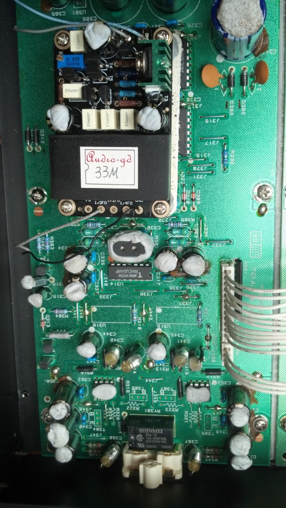

Phase C of mods:
C2. Installed the Audio-gd JZ-1 module (with combined Low jitter clock and Class A supply)
- Disconnect pin 4 of U314 (TC74HCU04AP IC). I.e. unsolder and pull/bend up
- Wire 1/3FO (11.28MHz setting on 33.86M Type 1 module) to pin 1 of U314

Mod photos
Modification photos showing:
1. Audio-gd low jitter clock (TCXO and Class A PSU)
2. Wishay MKP 1837 bypass caps and power feed for clock
3. Jantzen 10uF output coupling caps (Cross-Caps)
Plus lots of blue tack 🙂
