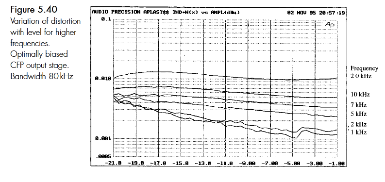

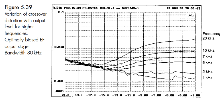

I do have the book. Just read through that portion again.CFP has significantly higher THD at low power than an EF2.
Note that the optimal bias for EF2 is about 100mA, with 0.22Re, For CFP, it is about 11mA.
Thus, at -16dB Watt, EF2 is in pure class A. You see everything converges to the noise floor before -16dB. Can we over bias CFP? In general, no, it exhibits more distortion if you over bias CFP as it widens the crossover region.
Yes, CFP do have slightly higher distortion around 1W based on the book. I think it is a good trade off to have a cooler amp.
