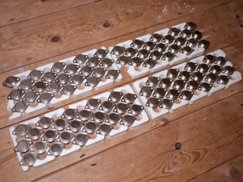

T05 can 2n3055 - do you mean T03.
They are very easy to source.
Here are over a hundred of them for £2 on E-Bay.

KatieandDad: T05 style 2N3055 were used in the original with those small "crown" heat sinks (Hatfield #207, discontinued, to be exact). I've seen the T03 and with a heat sink they're too large for the 4" x 6" PCB area with which I have to work (it's also a dual circuit, so two per PCB). Thank you!

You are correct! Dang, thank you, very much...that was a deal-breaker right there...I should have known something was wrong when I found no trace of 3055 in can form...Mouser have the 3053, TO-39 all day long. I thank you. (The rest of the components are clearly visible and values identifiable on the PCB photo I have, thankfully...)
