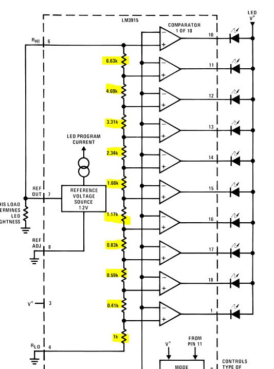

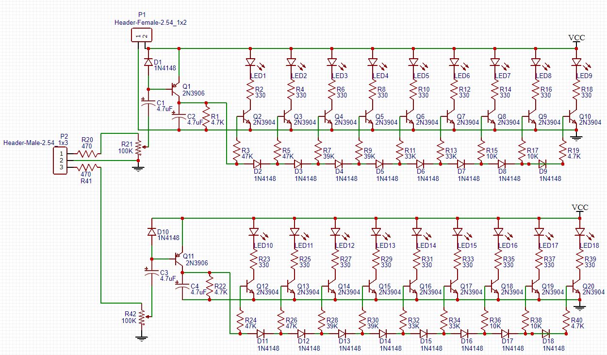

Greetings, ive been months trying to find a new solution for amplifier power output meters. since the LM3915/16 have been axed, and i have no idea how to program a microcontroller, its hard to find a new solution. so im here looking for some design help. LM3914 doesnt work for audio, been there done that. ive looked at a few VU meter IC's, im just using the LM391x as a reference as they are the most common and work well. ones ive looked for are the A277D, HA12010 and LB1411.
after about a month of one and off searching i found this design, which i copied into a stereo version on my EDA program (see image) but would like to add more "steps"
Stereo VU Meter
i breadboarded it but only had enough parts to make 5 leds. but i cant tell in that schematic, is the detection type linear, like the 3914 or is it tapered like the 3915/16? if its close to an audio taper, boom ill get some boards and try it out.
2nd idea, this one would be much more difficult i think, but would give the best results. Looking at the 3915's internal block diagram (see image) couldn't one just copy that design using descretes? just resistors and comparators basically.
3rd idea, does someone else have another good idea to get decent power meters that reads close to the purpose built IC's? ive seen a handful of pure discrete designs before but they behave like a 3914 where they raise to max level way to quickly.
as a last resort i started to snoop inside my tape decks and all i found was another dead part. The Sharp IR2E02. which would work, but i want 10-15 levels and not just 7. picky picky
ive been using this video has a side by side comparison between the 3 LM chips
YouTube
in the end i want to custom order PCB's for it. so i have no issue using chips, SMD parts or whatever else it takes.
If i forgot anything, let me know.
Any takers on this probably going to be way harder than it needs to be project?

Are you looking for a solution for volume production or just DIY? If the latter then there's no shortage of the discontinued LM3915 on eBay and Taobao.
A thought occurred to me - easier than doing a full discrete design, how about chaining 3 LM3914s in series - giving 30 linear steps - and only fitting LEDs to the steps you actually want to be displayed?
These days an Atmel/PIC solution would be much easier. Some of these have a 10 bit ADC, so a log scale is easy.
Probably use less parts using 4 LM339's and would have two more steps to boot with having only one string of resistors to contend with and no diodes to match up.
But as mentioned a simple PIC chip can do this function with even less parts and more resolution, A PIC18F2550 has a 10bit A/D and 24 I/O's all you will need is a full wave rectifier for the input, This could easily give you a 20 step delay or a stereo 10 step display and with a simple mux trick get a stereo 20 step display.
All with just one chip for $2-$4 and maybe on opamp.
Some PIC's have an on board opamp that could be used for the input rectifier stage as well all done with one 28pin chip! 😀
Just a few thoughts. 😉

a new DIY design. i grabbed a few eBay 3915's but they all dont work very well. such as at NO input the first lights will flicker and in bar mode at higher levels like the 7th or 8th the first bottom lights will begin to dim and flicker again.Are you looking for a solution for volume production or just DIY? If the latter then there's no shortage of the discontinued LM3915 on eBay and Taobao.
but chaining 3 3914's together would probably work PERFECTLY! just need to figure which 15 steps from the 30 would i need to select. just checked mouser as i was trying this, the DIP LM3914 is just now marked EOL. the SMD PLCC-20 is still good....for now
i like the idea of using 4 4 LM339's. just al long as we keep that log reading scale. cheaper than a bag of chips too!

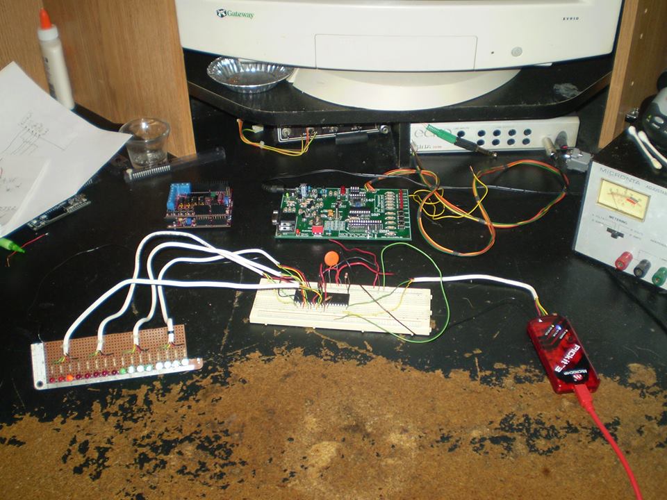

Ya, I haven't signed in to Chegg yet I may give it a try later.
I didn't realize until after I made the post that the code was incomplete /buggy or something.
Anyhow as far a extra parts go using the PIC18 there is one Bypass cap and that's it.
They have a built in osc. so you don't even need to use a Xtal, unless you you want to build a clock or something that requires precision timing .
If you look closely at my set up there is no Xtal !!
I may have a video of the thing running on my FB page, I don't remember its been a few years since I had gotten it out again.
I started it because of a friend that had bought a couple of LM3915 boards for some ridiculous price and ended up destroying the boards trying to solder them, ( Newbie 😉 ) .
So, I was going to build it for him but his whole project kinda bombed (Big 4 channel 150watt chip amp) and put it away for a while.
Multiplexing the banks of LED's is a very simple straightforward piece of cake as the pins can either sink or source the current.
There are many ways to do that as shown in the EDN link I posted earlier, or by using the MCP2317 16 bit expander GPIO port, there are two types SPI and I2C and 8 bit wide versions as well.
Just click on the Fig.1 and other blue print (link) in the PDF and it will open up the code and schematic pages for you.
