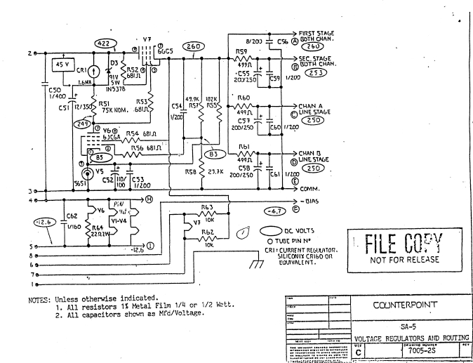

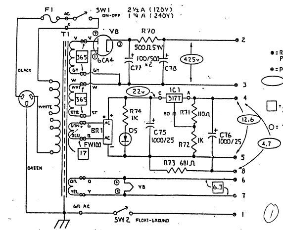

These are the PSU and Voltage Regulator schematics of the pre:

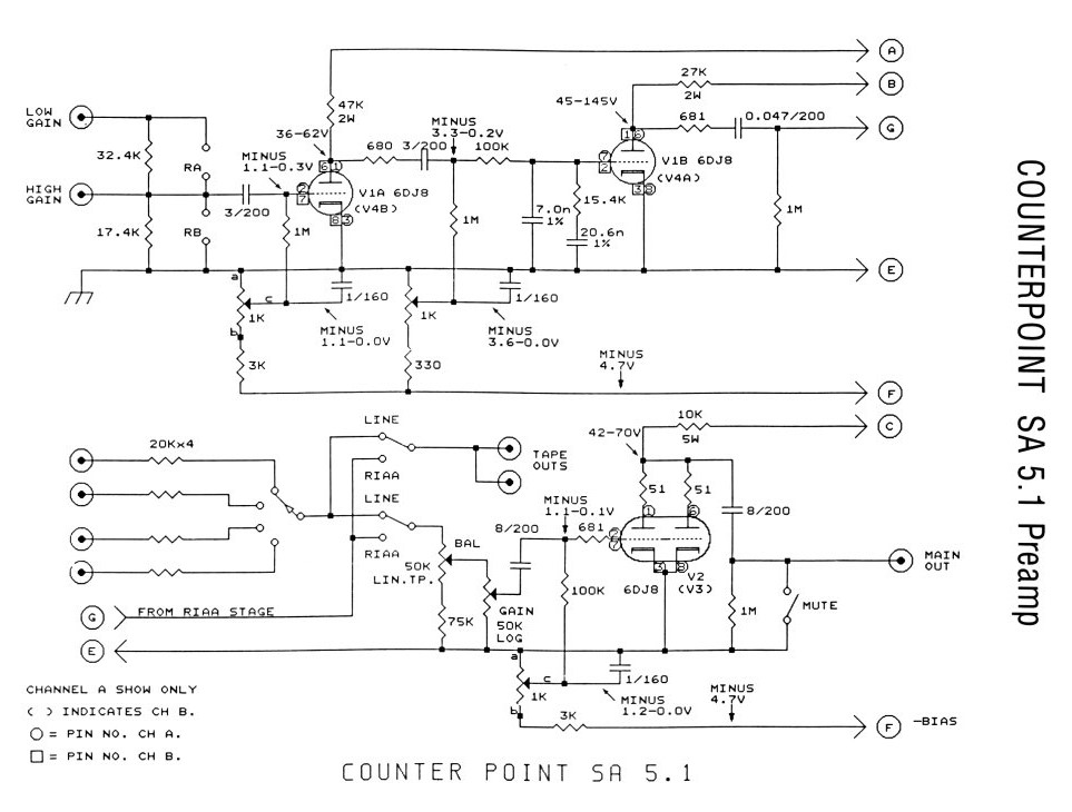

And these are the line level and RIAA sections:

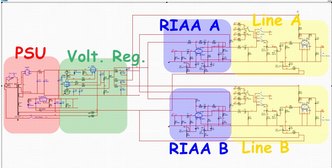

Now, what I did is combining all these schematics in one model:
Is this the preferable method of working?
