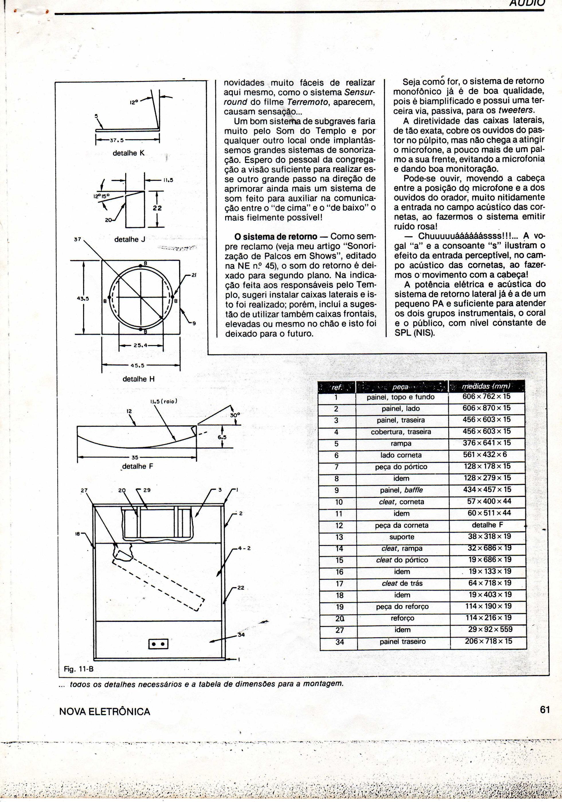

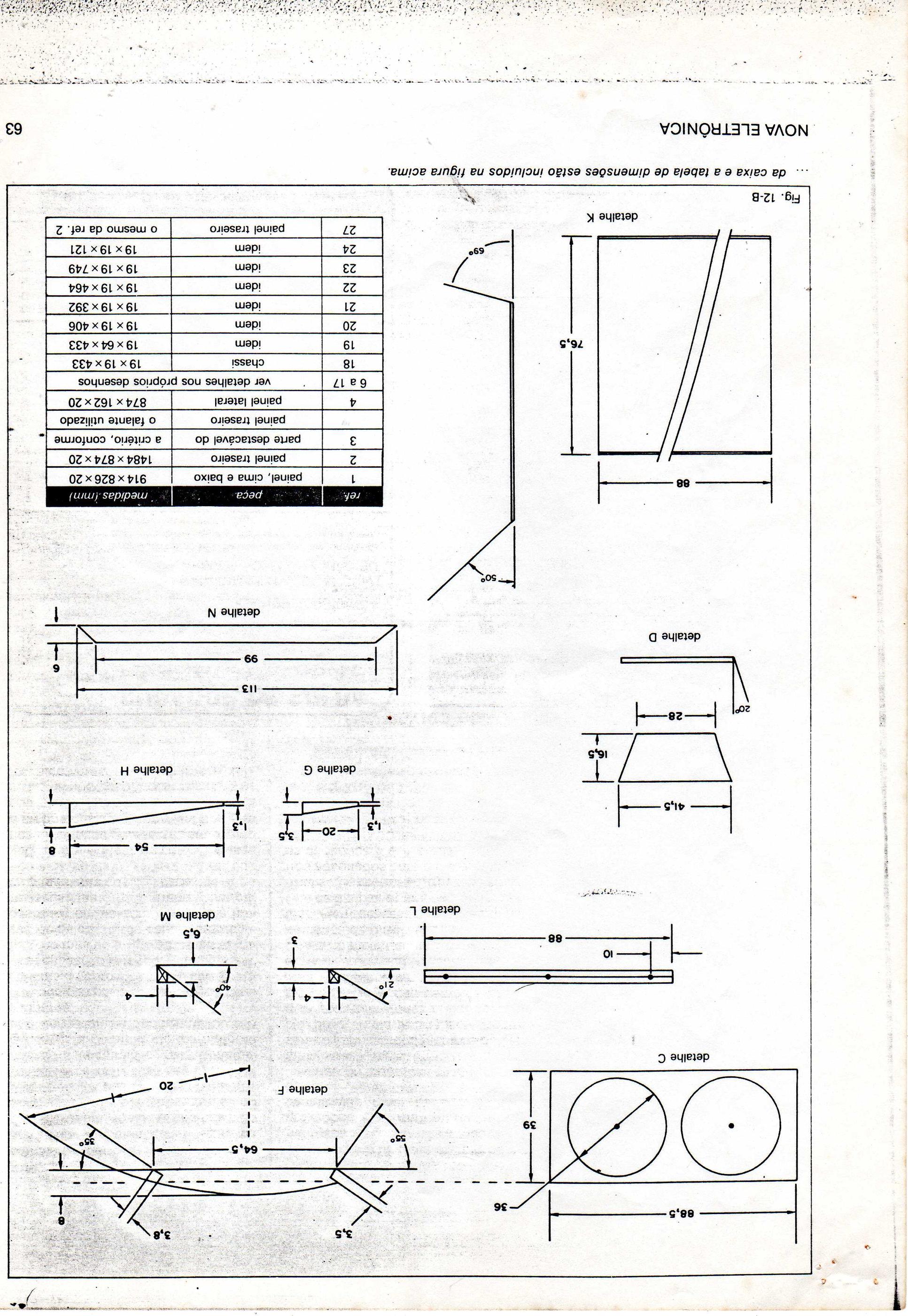

Thank you _very_ much for the contribution. This is the first time I've seen plans for a 4550 on the Internet. Can you tell me about the source of those plans? Also, does your literature say anything about the reason for the section between the two 15" drivers?

hey i got a pair of giants very much like those, in my garage. they have long vertical slots in the far right and left sides, instead of the square holes, cut for stacked 15s like those. whats interesting (i think) is they have a (fiberglass dual horn insert) and heavy duty fiberglassed woood houseing, wheels and handles, very difficult to move, and barely squeeze (with kicking and cussing) through a 3/0 door, ill try to get pix up
Yea I'd very much look forward to pics of those. What you're describing is very similar to what I already had in mind - add removable wheels attached via T-nuts on the bottom, and handles on the side. All panels would be reinforced by epoxy and wood doublers on the inside, both at the joints and along the panels. The vertical slits that you describe are similar to the Altec 817 cabinets, which incidentally is how i'll be building these. I tried desperately to make a pair of Altec 816s (single driver front-loaded horns) work with similar results as the 817/4550a style horns - they just don't. Using the "multiple speaker" wizard in Hornresp, dual stacked 816s are still 5db lower at 40hz, and 5db lower at 600hz (crossover frequency) than the dual cabinet version. So I'm pretty settled on this style.

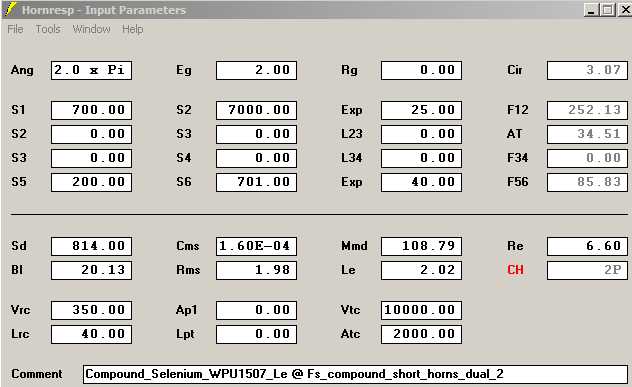

Hi letsbangout,
For a while there was some real interest in the compound horn enclosures, enclosures having a short front horn, and a large rear bass reflex enclosure. These enclosures are quite driver specific, you can't just stuff any old driver in there, and expect any positive results. The good thing is that compound enclosures can be modeled in Hornresp, I'll attach an example. Also, you may google for "artec france onken" for some examples and drawings.
