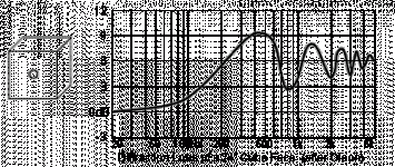

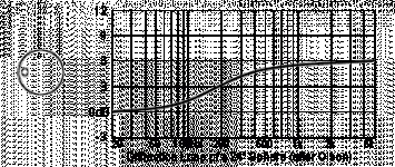

Baffle step involves wavelengths, which vary with frequency, proximity to room boundaries, and the size of the front panel of the speakers. Only the latter is perdictable. Speakers placed very close to walls will have a very different need for correction than speakers placed a few feet away from walls. If you know where they will be placed in a room, you can take a guess at what correction would be optimal. It's rarely an exact science. Personally, I rely on my four section Baxandall tone circuit to help me fine tune it in by ear.
The shape of a perfect sphere is well known, but it is
a small driver in a big and ugly sphere. A big driver
in a small truncated sphere is very different.
Consult the references on diffraction, and estimate.

My understanding is that a sphere is no different than any other shape in terms of baffle step loss - all of them exhibit a 6dB loss in free space starting at a point that is dependent on their dimensions (width or radius). Where they differ is in the amount the baffle affects the response above the baffle step. A sphere produces the least diffraction effects above that frequency compared to any other shape. See examples below. So regardless of whether a sphere of a given size has a large or small driver in it, the baffle step loss will still be the same.

I get the impression that the you might not be clear on the mechanics behind BS.
What is happening is as the baffle reduces in size, its ability to support lower frequencies is reduced. BSC is an attempt to lower the spl of the frequencies (wave lengths) that the baffle can support. These are radiated forward with a perceived increase in spl as the frequency rises. As the frequency rises, more of the wave length is supported "on baffle" ... so you hear a greater proportion of those frequencies. The lower frequencies aren't "lost" ... it's just that they are not fully directed forward to your ears at the listening position. To regain that "wrap around the cabinet" loss of spl you need to increase the baffle dimensions such that the baffle can hold/support longer wave lengths.
Diffraction is a relative to how kind a given baffle shape is to acoustic wave lengths. It only to do with the period where those wave length begin to leave the baffle and "diffract" off its edges.
There is no way to prevent baffle step loss in free space (4pi) regardless of shape. The only way to do so is to return to 2pi space which is something like an in-wall or infinite baffle speaker.
However the loss in 4pi can be mitigated by effectively reducing that space by using very wide baffles, putting the woofer closer to the floor, and/or moving the speaker closer to the side and back walls. Jeff B's diffraction program can show you these effects.
But still the loss for any shape will be limited to 6dB. So to say that you are getting more loss from a sphere than a rectangle doesn't make sense unless:

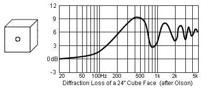

That's an excellent description by puppet. I also found the following helpful when I was starting out:
True Audio Speaker Topics: Spatial Loading
True Audio TechTopics: Diffraction Loss

Clearly for two speakers, both with indentical 6dB baffle step,
but one centred on 500Hz, and the other centred on 250Hz
the latter will sound like it has more bass, not that it matters
really if you correct baffle step correctly for both cases.
A low diffraction / low ripple design is always going to
have a high transition frequency and there is nothing
you can do about it, there is no bass you can save.
rgds, sreten.
