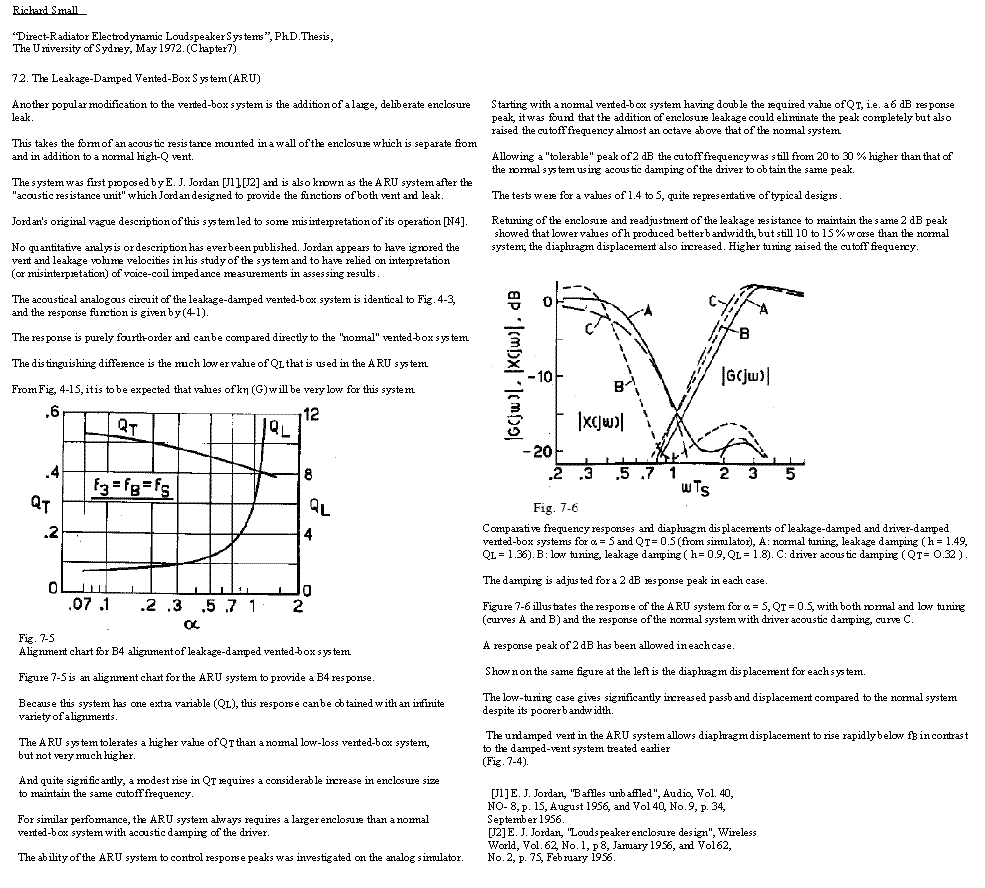

and I found another reference to an old Jordan WW article.
But,
A warning must be issued when reading this article: ARU Article
Arguments: chapter 7.2. The Absorption-Damped Vented-Box System by Richard Small.

Thanks for the article bjorno. Was the warning to do with raising f3 by an octave? That hasn't been the case here, otherwise I wouldn't have bothered. In fact the 8" widerange in converted cabs appear to go well below resonance. No measurements yet, I'm improving the top end, just needed some cabs for listening tests.
All my effort has been on small cabs. The ARUs were large.

Hi Geoff,
Not only but more of general nature and, sorry, this matter takes time for me to explain why, I also had to think more than once before I could reply to your question.
The flawed view is that Jordan presents the ARU concept when trying to interpret the ARU function mostly from looking at the impedance curves.
The impedance curve reflects only what the driver senses and not the system impacts that’s really the target when designing a speaker.
This shows that he at that time didn’t fully understand the acoustics behind the whole speaker transfer function.
Otherwise I don’t wish to give offence against Jordan, he is one of my favourite driver designer.
Today when good acoustic simulators are available to anyone, I think also Jordan regrets the article and for his defence, the year was 1956 when he wrote the article, nearly 10 years earlier when I bought my first acoustic literature, Leo L. Beranek, Acoustics and made my first DIY speaker.
ARU has pass band drawbacks, high excursion and poor bandwidth.
For drivers with Qts over 0.5, the alpha values shows the need for extreme high box volumes and for normal Ql values, it’s impossible to use high Qts drivers in smaller boxes.
This also implies that its impossible to align ARU’s for third order alignments, its always of forth order and that’s one of the reasons why the excursion plummet sky-high below fB.
As Jordan didn’t investigated the vent and leakage volume velocity’s, he missed the huge increase for very low frequencies were almost no SPL is produced.
I believe that of the possibilities to apply acoustic dampening, the concept is the poorest of all and the ARU article very out of date.
