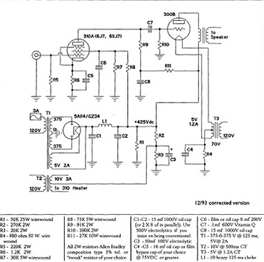

Does anyone know where online I can find a schematic of the Western Electric "model 91" amp? I can't seem to locate one.
I hear it described as a classic. The single pentode voltage amp/driver stage is interesting. Any thoughts on a #32 pentode driving a #45? I have two laying around.
I can't decide whether to do that, or just use a 6F8-G direct-coupled.

WE 91
I've got the circuit diagram of the WE91B and also a french adapation in some books.
Everything is in French though.
The B uses an input xformer,a 310A penthode (you won't need this stage) followed by another 310A driving a WE300B loaded by a WE171A OPT.

Thanks guys.
Robert - that was an interesting page. Thanks.
Boy, they sure weren't afraid of stringing a whole bunch of stages together. They aren't "minimalist", that's for sure.
Lots of iron in there too.

Definitely interested, Frank. I haven't seen those articles.
A group of nine of us are preparing to build amps based on the revised WE91 (SP#1 or Angela circuit), so any and all info is helpful.

Thanks Frank, I'd be interested in any extra info you have as well.
And also if anyone has any experience with the DHT pentodes, 24-A, 32, etc. please chime in.

The penthode + triode combo is generally a good sounding recipe.
I often noticed the penthode adding a bit more life and sparkle to the DHTs.

Joel said:Does anyone know where online I can find a schematic of the Western Electric "model 91" amp? I can't seem to locate one.
I can't decide whether to do that, or just use a 6F8-G direct-coupled.![]()
Joel
I've built the WE91 circuit using several different input pentodes. I liked the 6SG7 best (keep it biased away from it's remote cutoff region.) The 6J7 and 6SJ7 were pretty good too. I preferred all of these to using the C3m, which is pretty highly regarded. The 6C6 (which I haven't tried) was the original valve used in the 91 circuit and they are plentiful compared to the WE types. The 6SH7 looks interesting, too, but I haven't tried it yet.
A very nice improvement in sonics for all of these pentodes is to use an 0C3 VR tube to supply the screen. Give them a try.
Sacrificing maximum power, I'm really enjoying a simple paralleled 6N7 triode as a single stage driver for the 300B. It works really well for a 45, too.
Attached is the revised 12/93 schematic from SP #1 where Joe Roberts spoke very highly of this circuit. He got rid of the first 310 stage and feedback loop, and added a choke in the power supply.
Another popular revision is the "Angela 91", you can find the info here. http://www.angela.com/catalog/how-to/model.91.html
Apart from these I haven't found that much info (considering how many people have apparently built these). Look forward to the info/articles from Frank.
Noam
