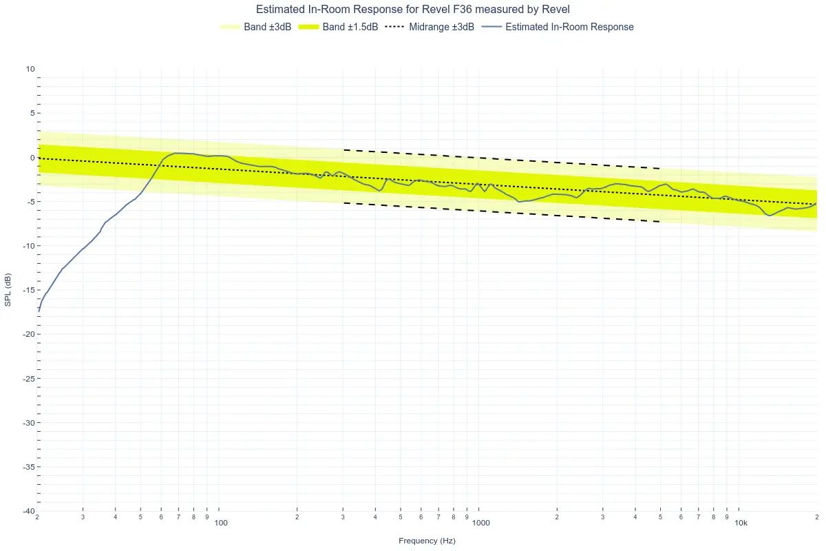

1) Revel F36 blew my speaker budget for the year ( $1200/ pair, lol) and yes I have read , reread, all the reveiews , data , spinorama on all the revel/harman speakers I could find.

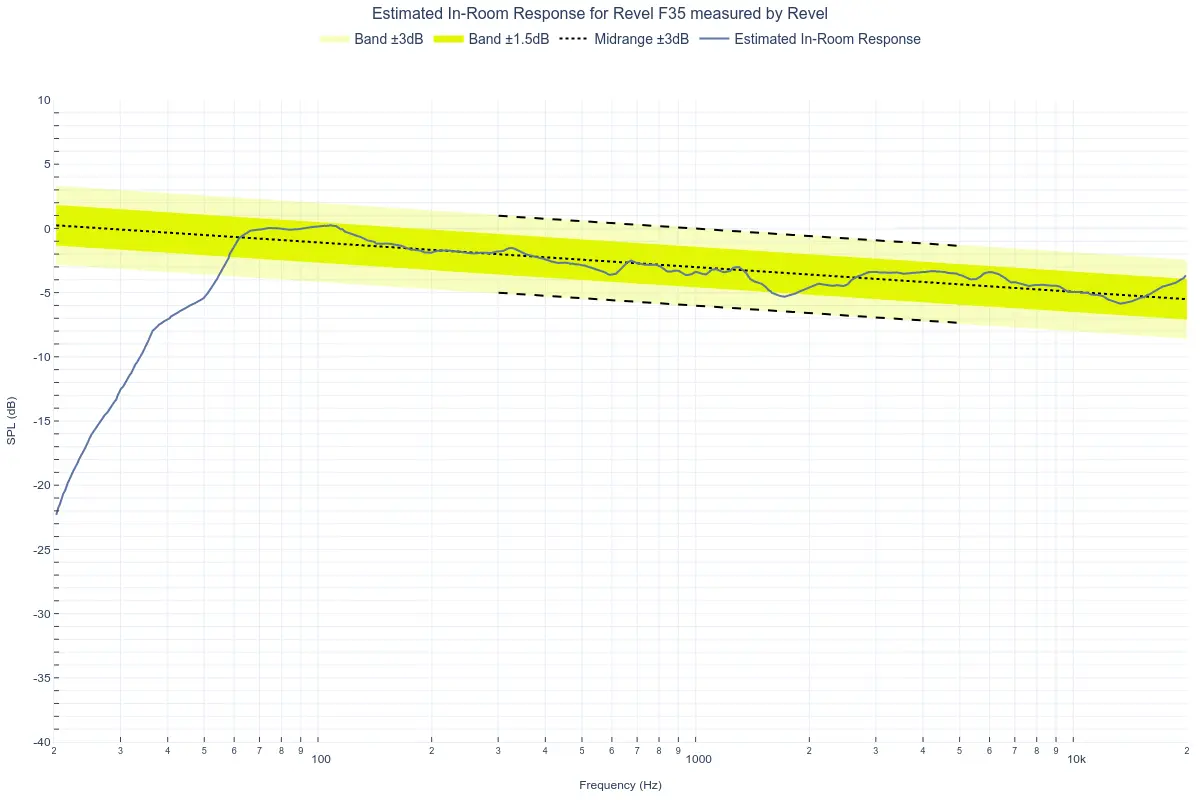

the only thaing that bugs me abotu the F 36 is that 4 k broadband hump, esp when compared to the F 35 and others that hit the target curve a bit better,
I have a very large room and high ceilings and sit about 13' away but that hump is still noticible, not enought to make me not love the seakers,But..
There has to be a easy way to DIY those factory crossovers to get rid of that hump. I know Revel had to cut costs somewhere.. I have seens some pics in a vid of the x.o
and it doesn't look like too many components and maybe even bi-polar caps>??
So anybody up for a project? I have Holm RTA REW a nice focusrite DA , calibrated mikes old 50mhz scope ,etc.
I'm thinking, just pull the board, put a R that matches the DCR of the tweet and measure it then work to get a shelf filter in and upgrade the parts while I am at it?
Few hundred$ would be worththe investment to really amke these beauties sing?

That would give you rubbish. The xover needs the unit(s) and box to behave anywhere near what it does in real life. (ie in the speaker) Your bump is almost certainly an artifact of the interaction between the box, bass unit, treble unit AND the xover.

It's unlikely Revel will release a speaker with a bad sound 4kHz bump. You might just not be listening to it as they intended.

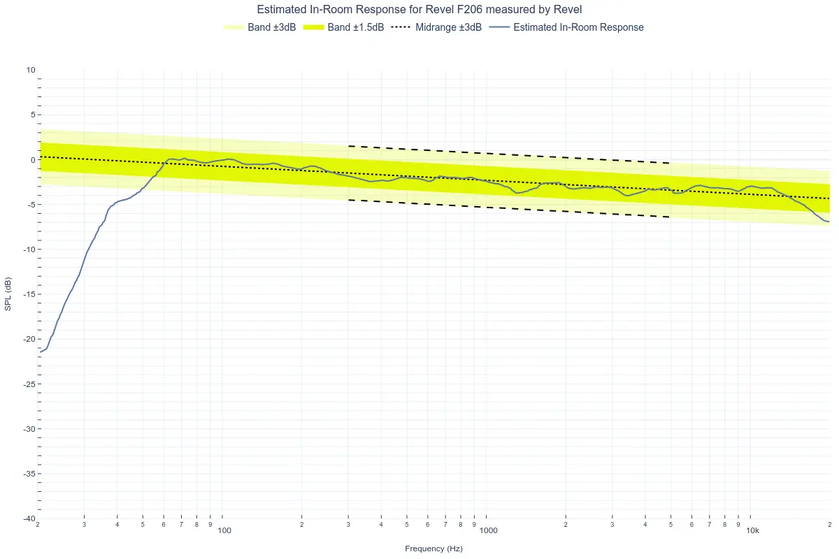

do not want nor have a place for any and one is this system, analog only hence the desire to tweak the crossover.. for the spinorama link been there seen it no compare it to the F 35 and other highter end revel speakers. I still use the dcx for testing purposes and have already tried it and eq'd out the hump and it does sound a touch more like the higher end Revels but it nor any digital is goin in my system, as far as Totally redesigning the crossover.. not.. just the tweeter section has to be touched, unless it s series crossover... but i'll fin out soon enuff

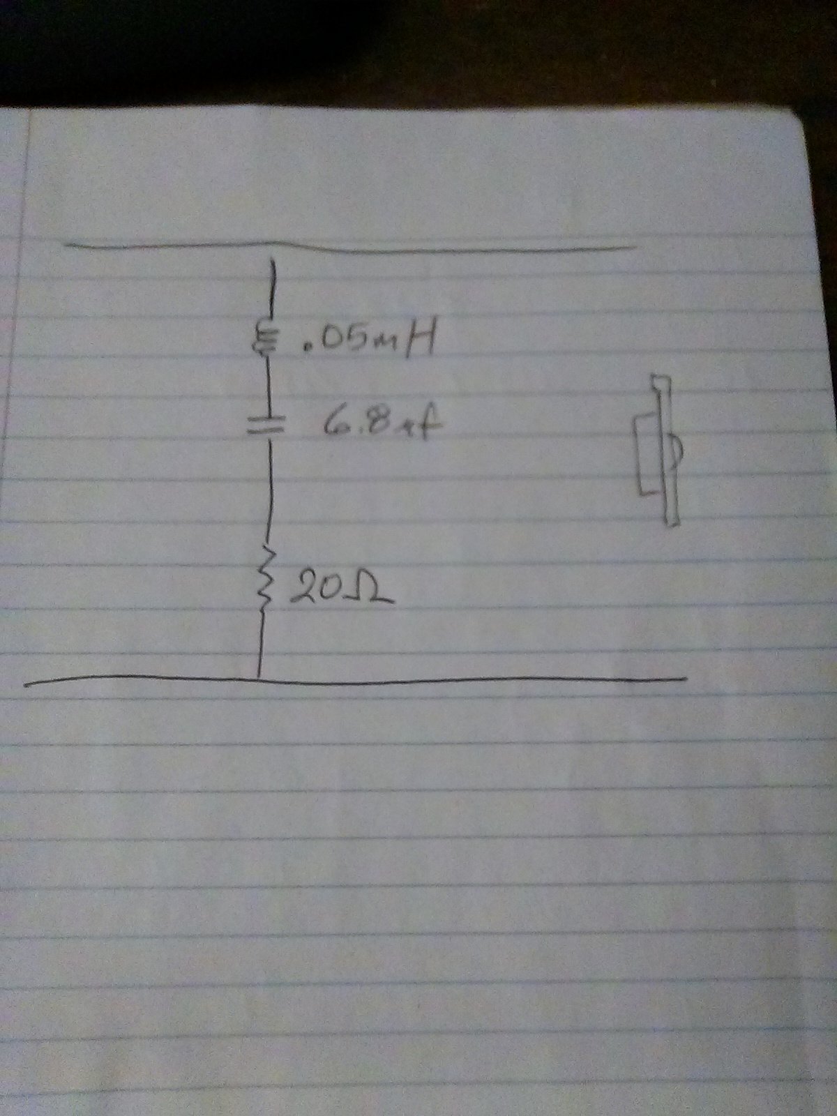

It's not difficult to shape the response to your liking. Draw the complete x/o filter of the tweeter unit.
Prepare to measure tweeter only at desired angle/angles and distance.
Load frd and zma of a raw tweeter to a simulator and introduce passive parts you found in original x/o.
Some sort of rlc network should do the job.

VituixCAD.
Take frequency response measurements and impedance measurements of both the midrange and tweeter, and import those into VituixCAD. Use an IR window that closes before the first reflection (probably the floor reflection) to keep room reflections from interfering with the measurements. The more off axis angles you measure, the more accurate will be the prediction of the estimated in-room response, if that is important to you. Assuming you only are tweaking the tweeter's filter and do not change anything in the Woofer's or midrange's filters, that should be sufficient.

This should be close. It shaved 2dB off the response at 4k in my sim.
After looking again I'd probably shift the notch slightly higher in frequency. Changing the cap to a smaller values shifts it higher.

temp 25 thanks you very much .. on the right track with my thought process and for the naysayers yes the mid might effect it some but its x/o is one ovtave below where we need the correction so,,,,, hopefully just the tweeter and that's where we start... TEMP 25 thanks! be a few weeks before I can tear into it.. got to finish house painting first i'll post pics valuse and measurements soon as I can get them
