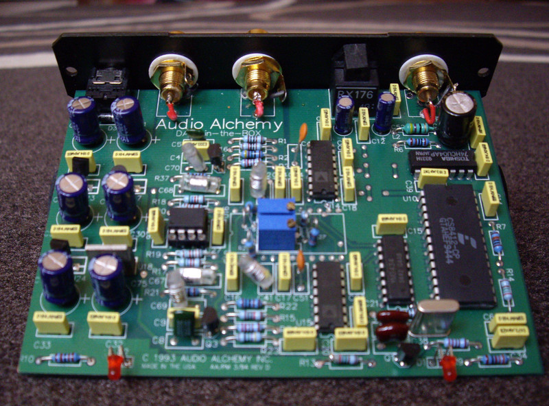

I'm trying to find multibit d/a converters (not CDP) from the 90s to modify to accept 96k direct.

Device shortlist so far (open to suggestions or alternatives).
- Audio Alchemy Dac in a Box (converter: AD1860) (PCB pic)
- Denon DAC-500 (converter: PCM1702)
Audio Alchemy is a good contender - plenty on ebay. portable too, but would modding one to accept 96 be possible/viable?

Could it be that the professionals realized they didn't need more than 48K? In the 90's the difference between 48k and 96k carried a real cost factor in terms of processing power and storage/memory, unlike these days when CPU power, memory and disk space is so cheap that you might as well do 96k anyway...
The AA DITB does look to be a good starting point. But its using the Crystal CS8412 receiver which the DS says only goes up to 55kHz. So that'll need replacing with a more modern part. As you say you'll also have to bypass the oversampling filter chip - from the picture I can't work out which one is fitted, perhaps its a Yamaha part.

Early Audio Note NOS DACs with CS8412 and AD1865 can be updated to 96K with the substitution of a CS8414. Or, substituting a CS8415A with a little glue logic can take it to 192K. Although the CS8415A is spec'd to 96K, the ones I have tried do go to 192K.

I now realise older receiver chips can also be upgraded with 'drop in' mods.
see audiotuning.de
In turn with bypassing digital filter, should considerations be made regarding mismatching word lengths with this approach?
For example, replacing YM3623B (16out) with CS8414 (24out), prior to a 16bit dac I can imagine would result in problems, so ultimately it would be up to the user to pad/condition the signal to the correct depth, prior to SPDIF transmission, am I right?

Obviously 24 into 16 can't work, so user would need to pad the data prior, is my point...

The Denons I mentioned use the YM3623, which is not supposed to be capable of beyond 48/16, but it seems that it is governed only by what format coding bits it sees, so can actually process 24/96, at least properly enough for the SM5845(custom-for-Denon version of more or less an SM5847) digital filter to make sense of it. It is certainly possible to upgrade the input receiver to DIR9001/CS8414/WM8805 with an adapter/daughter board, but there isn't much point, since the ladder dacs used are far less sensitive to jitter than bitstream dacs.
The word length sent to the dacs is controlled by the digital filter chip, with the SM5845 in the Denons being configured to send 20bit out to the PCM1702 chips.

However if the digital filter is bypassed, larger words would need to be padded out at source, right? Something the DF chip would otherwise do on it's own...

The YM3623 was not designed to accept 24/96, but it somehow does it.
I am absolutely not an NOS believer, so have never looked into what it might take to get 24bit words truncated to 20bit for 20bit dacs, or 20bit into 16bit dacs, etc. I don't think that is a simple thing, by any stretch.
I did find my Denon DA500 dac service manual last night, and it does use the same YM3623 dir & SM5845 df as the DCD3000/S10, so should also do 24/96, but just has one PCM1702 per channel, rather than push-pull 1702's per channel.

I think it just a case of padding the word length using software, some playback programs can do this I think.
I actually have a dac/amp with ym2363 already so i'll experiment and post results when I get it to work.
