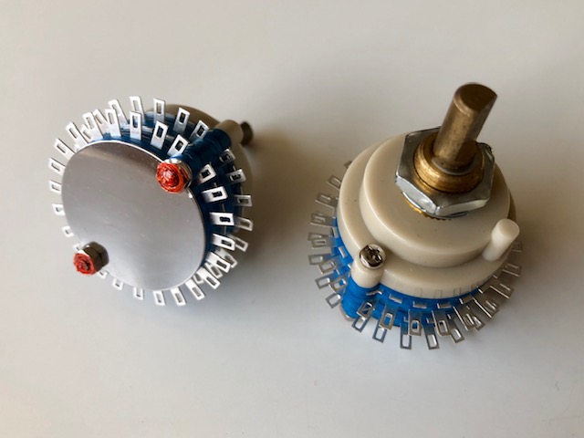

Ever felt tempted to buy one of those cheap rotary switches from China to use as a base for a DIY stepped attenuator? I was and I did just to find out that the detent mechanism was way too stiff for a stepped attenuator. So I had to figure out a way to mod it into something useful with a smooth tactile feel to it. I documented the mod as a blog post if anyone else run into a similar situation:

all what you really need is applying some quality graphite based grease in detent plate holes , and some audio-approved grease (I'm using same as on detent mechanism) on contact plates ......same as drop of car engine oil on shaft
that will ease rotation , make it smooth and if you use big knob , it would feel as 1M $

It was not enough on these switches that's for sure. They where really stiff, stiff beyond anything that any lubricant alone would fix. The new springs is what makes the difference. They are now really smooth comparable to the stepped attenuator on my vintage Technics SU-8600. A big knob makes it even better but is not needed after the mod.
