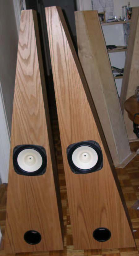

I built these for a friend, using FE206's and I really liked them. They required around 4 ohms of series resistance when paired with a SS amp...a SE tube amp will need less. The same design would work with the FE207 and no series R.
I now have the same drivers in Ron's Dallas II horn, which I like better, but is harder to build and weigh 140lb per side.

It depends what you call a Voigt Pipe.
The generic shape / cabinet style, where the sealed end is narrow and the open end (or end with an opening in) is wide is simply a Tapered Quarter Wave Tube (TQWT). See Jeremy's picture, or Martin King's Project 2 ML TQWT which remains my all time favourite budget ported enclosure, TL or otherwise.
The specific cabinet I believe you're refering to, the Lowther Club of Norway 'Voigt Pipe' is a loathsome contrivance in unmodified form. Not because it comes to a point at the top, which is the most common objection, but because a) it really doesn't have enough cabinet volume for the drivers it's allegedly designed for, and b) it's vent size is far too large. You can make it work by reducing the vent size as I suggested in the thread linked above. It'll reduce efficiency by a few db, but flatten the response out, and also give you an extra 20Hz LF extension. Not ideal, but it's much better than standard.
Would you be better off with a Buschorn? Depends on your priorities. The smallest version of the MK2 works with the FE83E, the larger with the FE103E, FE108ESigma, and also apparantly the FE126E with minor modifications. They have a great reputation for the midrange and top end, though they obviously have limitations in the low-frequency range.
Me, I'd take the middle approach, go for the 6 1/2in FE167E and use in Martin's Project 2 ML TQWT cabinet, particularly given that you like the appearence of the TQWT. (The 167 is a drop-in replacement for the the FE164 originally used, and if anything works a bit better). I've built 3 pairs, 2 of which were, er, borrowed by musician friends who refused to give them back. Solid performance from 40Hz-20KHz.
