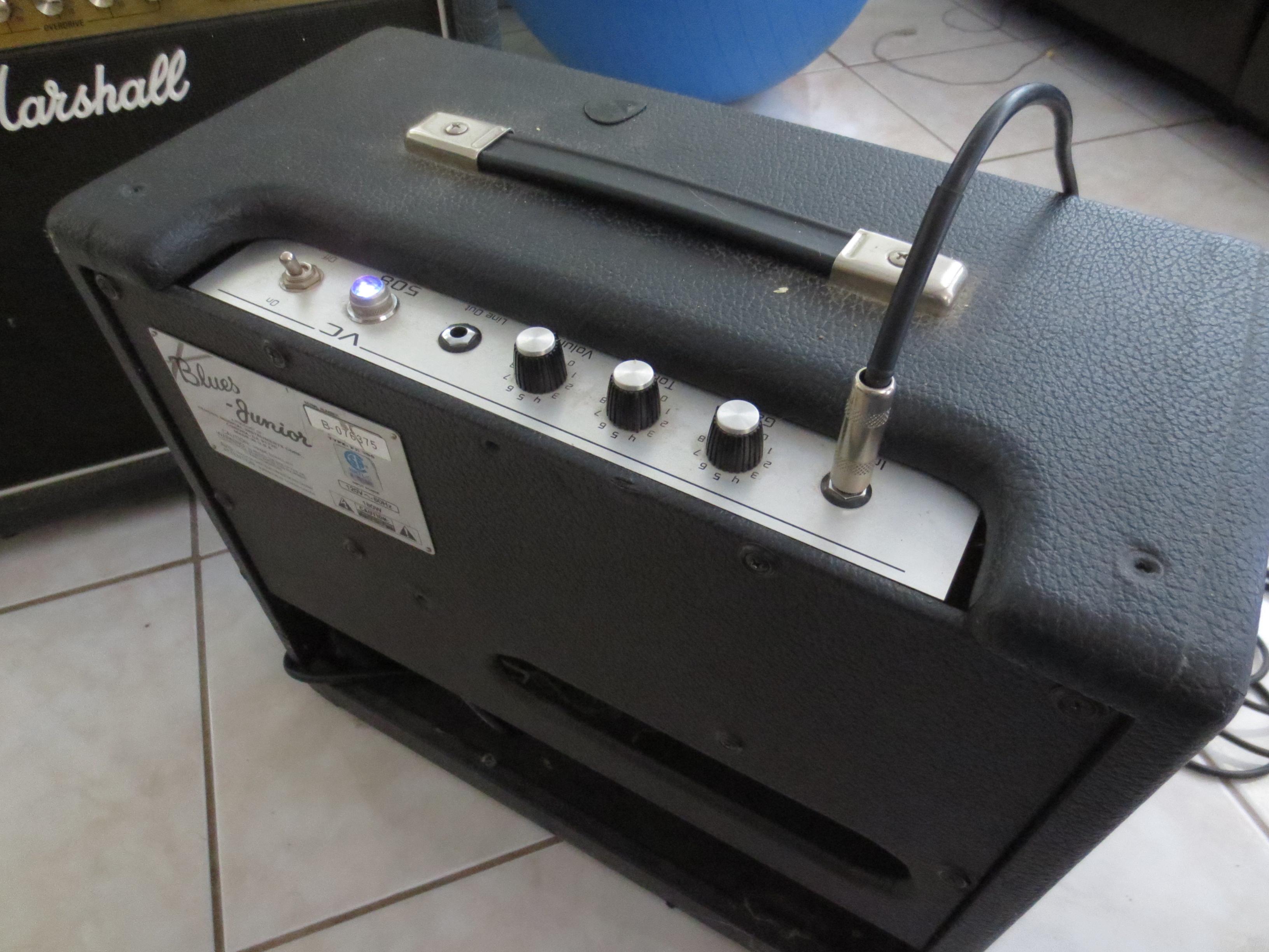

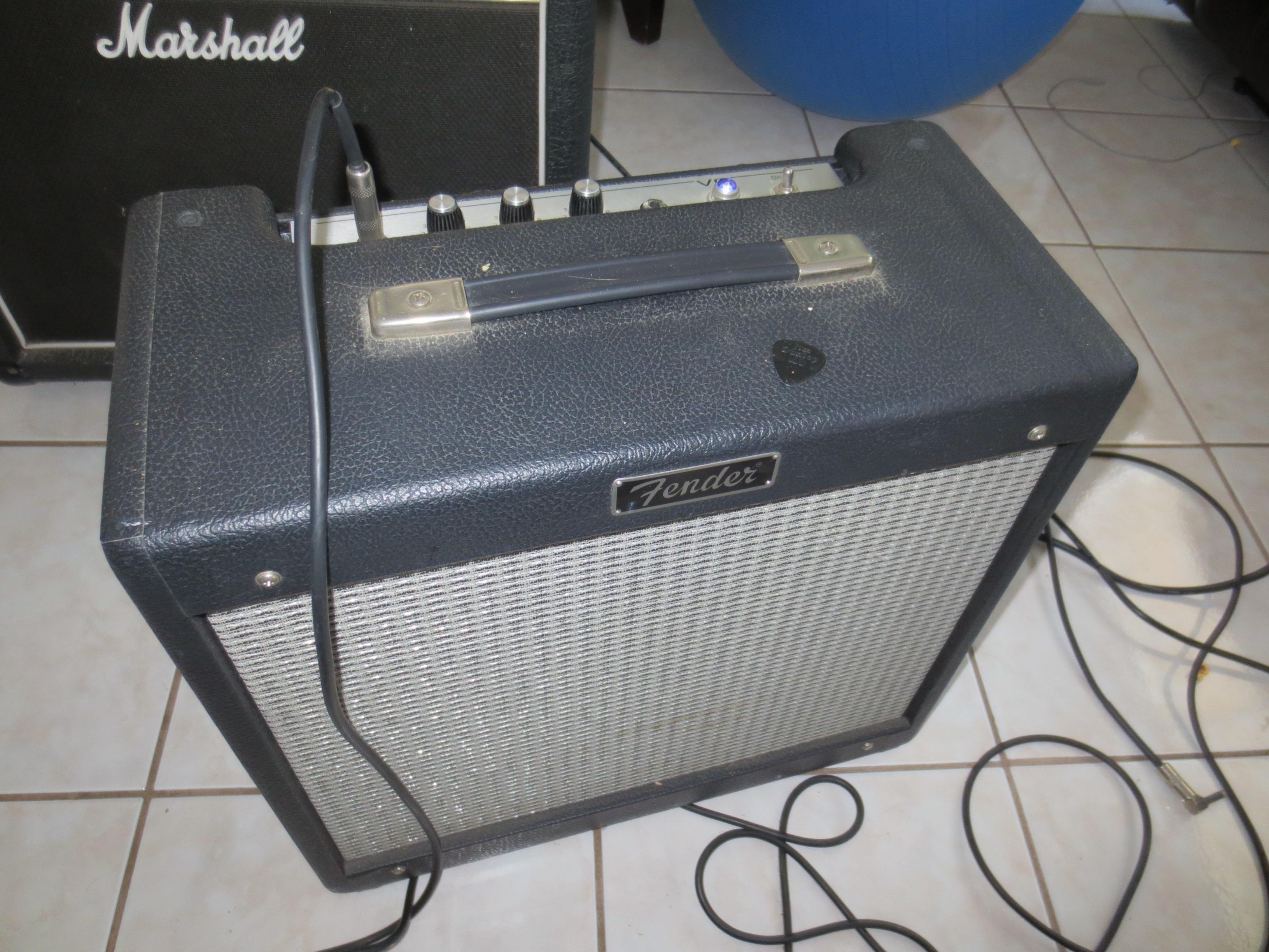

Great info on possible mods for the VC 508. I modded mine by simply placing the brains of the VC in a Fender Blues Jr. I bought on ebay for $60 and added a Celestion G12 M Greenback I had lying around. I love the sound and pure power of this little monster.
