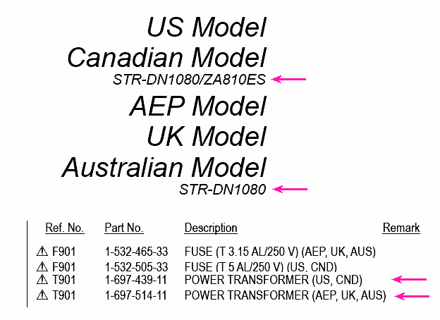

Find service manual.
Sony STR-DN1080 Multi Channel AV Receiver Manual | HiFi Engine
Hmmmm.... first page shows two models, US/CAN and AEP/UK/Aus. Different model numbers. But could it be converted?
Deep in the drawings and parts-lists we find two different Main transformers for the two markets.
There is also a small Standby power transformer with specific V and Hz design.
IMHO, the most practical answer is a 230V:115V stepdown transformer at 250VA-300VA.

Thank you all for your replies and comments, and thank you PRR for providing the service manual for my receiver. So, probably will look to sell it.
From my poor understanding, it seems it is not viable to rewire the power transformer, as it seems 110v and 220v versions use a different transformer, and not just the same, rewired.
