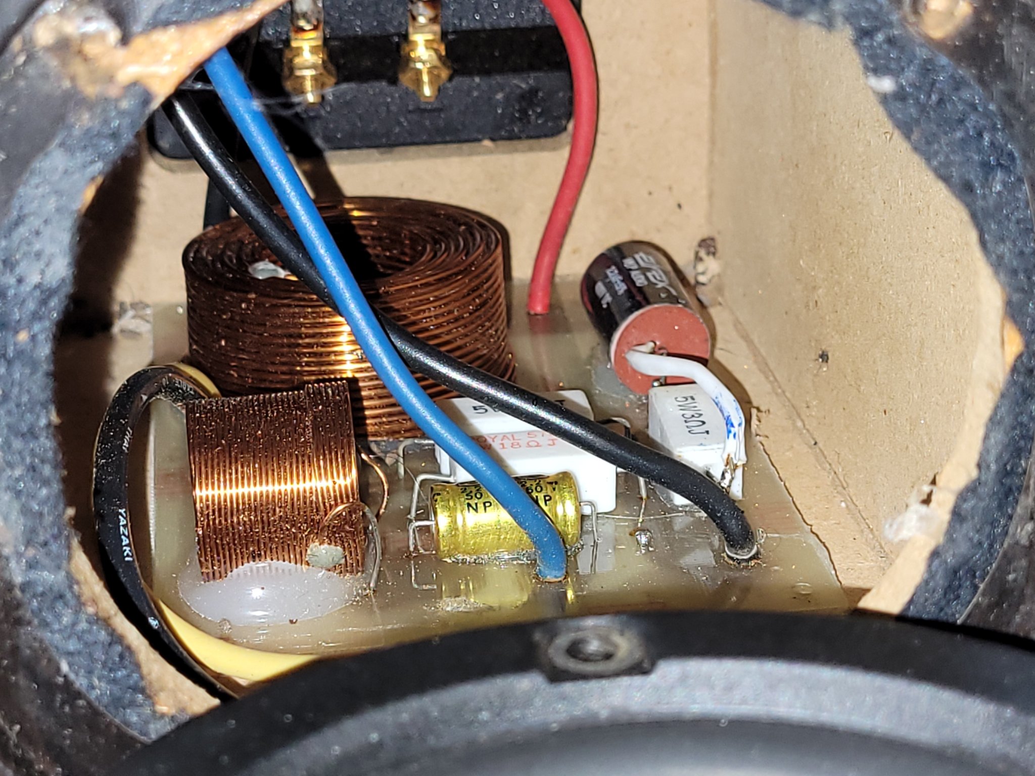

Thanks all. Unfortunately, the crossover board was glued in and quite hard to access. From what I understand, I should keep impedance the same so I should use both parallel and serie resistors (using L-pad calculator). I probably can change value of R1 by parallel it with another resistor.

Does it seem like hot glue or something like silicone, urethane, etc.?glued in
If it's hot glue, you may be able to soften it with a heat gun and get it out.

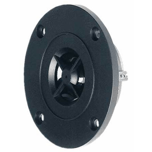

Is this one available in your area? Looks pretty similar.
Visaton DTW72
https://www.parts-express.com/Visaton-DTW72-1-2-Polycarbonate-Dome-Tweeter-8-Ohm-292-676?quantity=1
Cutout Diameter 1.96
Tweeter Type Poly / Mylar Dome
Power Handling (RMS) 70 Watts
Impedance 8Ω
Frequency Response 2.200 to 23,000Hz
Sensitivity 91dB 2.83V/1m
Thiele-Small Parameters
Resonant Frequency (Fs) 3000Hz
Mounting Information
Overall Outside Diameter 2.83"
Depth 0.83"

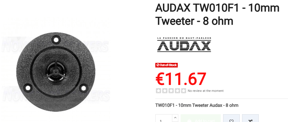

TW010F1 - 10mm Tweeter Audax - 8 ohm
High Energy encapsulated magnet
Compact and round light design
Ferrofluid cooled voice coil
Brand Audax
Series Tweeter
Magnet Material Neodymium
Diaphragm Material Polymer
Diaphragm Diameter [mm] 10
Ferrofluid Yes
Free Air Resonance [Hz] 3000
Impedance [Ohm] 8
Sensitivity [dB] 90
Power Handling [Watt] 25
The Visaton is not available in my area. There are few OEM Harman, LG-branded drivers. I plan to replace tweeters in both channels since the Audax is hard to come by. I don't want to mess with cabinet so I need a 3-inch drivers for drop in replacement.

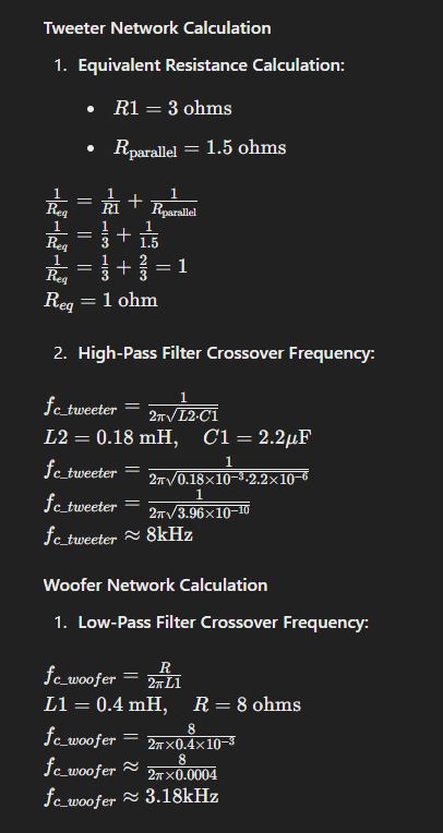

I admitted that I'm not keen in crossover circuit design and mostly use chatGPT to help in design. The AI suggests 1.5 ohm resistor in parallel with R1 to use with 4 ohm tweeter driver with -1.9dB attenuation (compared to -2.7db in original 8 ohms design). I'm not sure AI calculation is correct or not since previously I use it on PSU design but their design is not entirely correct. Here's what the response....
### Recalculation for Design 5: New with 4 Ohm Tweeter and 1.5 Ohm Parallel Resistor
#### Tweeter Network Calculation
### Summary for Design 5
| Parameter | Value |
| Tweeter Attenuation | Approx. -1.92 dB |
| Tweeter Network Impedance | Approx. 5.73 ohms |
| Combined Speaker Impedance | Approx. 6.5 + 2.96j ohms |
| Tweeter Crossover Frequency | Approx. 8 kHz |
| Woofer Crossover Frequency | Approx. 3.18 kHz |
This summary provides a clear picture of the key parameters for Design 5, ensuring it maintains balanced attenuation and good impedance matching while achieving the specified crossover frequencies.

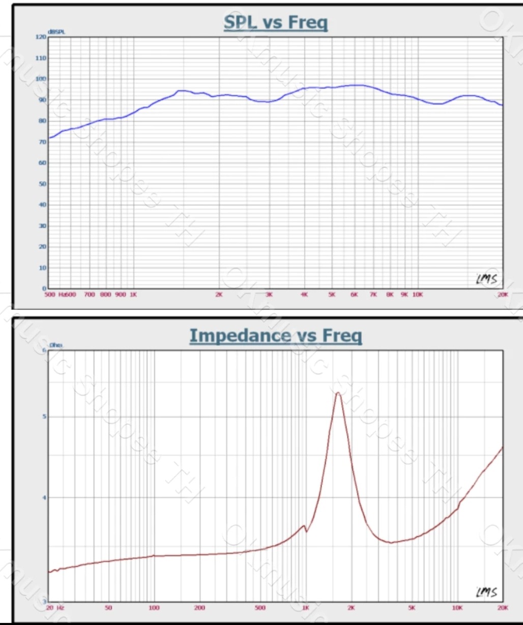

The new tweeter has resonance frequency at 1600Hz, so I think I can cross at 3000Hz using simple first order design? Based on my calculation, I can keep L1 at 0.4mH and some how increase C1 value to 13uF? Can I've just parallel a 10uF cap to C1? The new tweeter SPL is at 91dB so I guess I can left R1 at 3 ohms for some attenuation?
Good thing that I think I found the spec of the new drivers and I can physically cut off R2, L2, R3, C2 from the tweeter network to simplify things.

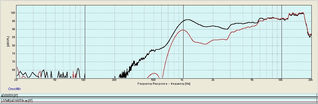

Textbook crossovers are almost useless. The 6dB tweeter filter works by adding a capacitor that add more and more resistance the further down from 3 kHz you get (if the tweeter has a constant 4 ohm resistance.) If the tweeter has a peak at say 1600 Hz way higher than the resistance of the capacitor at that frequency the crossover will not attenuate.
I tried a philips 1"dome crossed over at 4 kHz (resonance at 1 kHz) The cap should reduce the output by 12 dB at 1 kHz in theory, in practice it was soemthing like 3 dB or so. If you want to use a first order network you must have a LCR trap for the tweeter peak!
