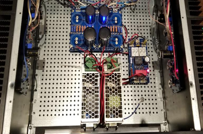

Phoenix Contact Quint-PS/1AC/24DC/5 is selected for the test because of seeing and using them a lot. Its output voltage is 18-29.5VDC adjustable, very handy for future testing and different amps. The output current is 5A, but it has a boost mode, which allows 7.5A at 24VDC if the ambient temperature is not over 40°C. The residual noise is 40mV P-P, which is very low. They can work in parallel to increase the current or series to double the voltage. It is very well built, metal case, 105°C Rubycon and Nichicon capacitors. And all other components look very solid.
The most important feature is the build in protection function. They have built-in protections.

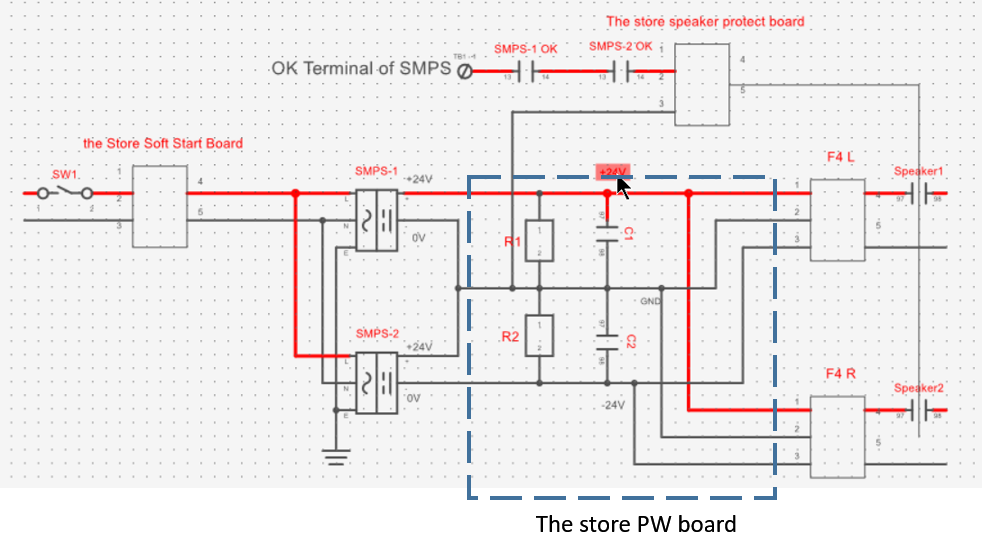

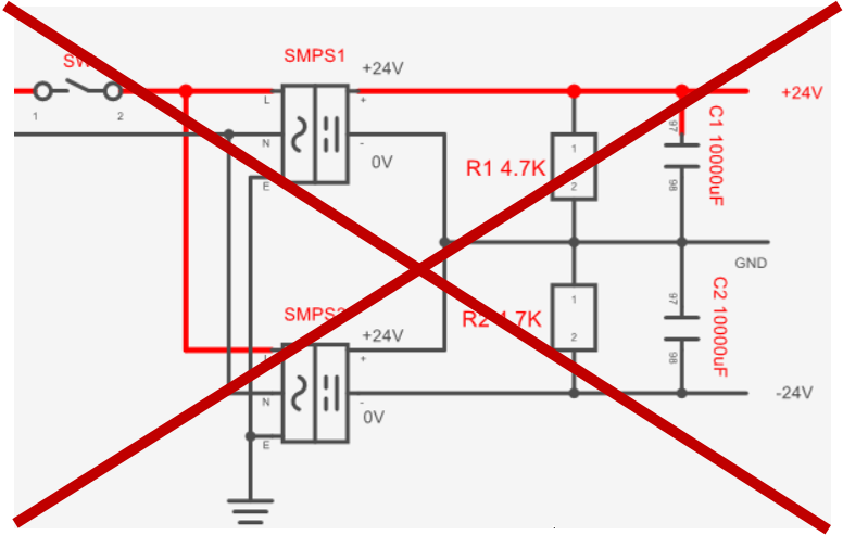

Two in Serie, Turn On Test
Hooked up two SMPS as shown in figure. Turn on SW, two SMPS not on at same time. Putting this circuit on F4 without speakers, and a turn-on voltage 8.5VDC on the speaker terminals is detected for a half second. The two SMPS cannot be just simply put in series to get +/- power supply.

Money paid and the SMPS received. No returning. After the initial tests plus the working experience with the SMPS, the final wiring schematics is shown in the Figure. The SMPS with longer switch on time is used as the positive rail SMPS1. The SMPS with shorter switch on time is used as the negative rail SMPS2. The work sequence is like this: 1) line power on, two SMPS start; 2)when its output gets 90% rated voltage, its OK terminal will get 22VDC; 3) this 22VDC of the slower on SMPS will be used as the power of the speaker protection board; 4)this power also go thru the OK relay contact of two SMPS. It will cut off the power supply to the speaker protect board in case: 1) any SMPS fails; 2) any SMPS shorts; 3)fast disconnect if line power fails; 4)overload protection. Since this circuit turns off speaker very quickly, lower the volume before turning amp off is recommended.

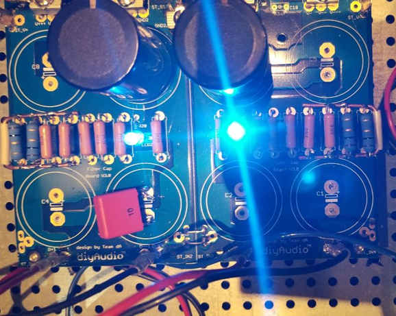

Sitting on floor and watching Pass-style blue bright LEDs on the power board, something hiding in the shadow, 14 resistors. Is that the problem? Two jumpers in. Turn on power, music flows. F4 sounded better. But I felt something still missing.

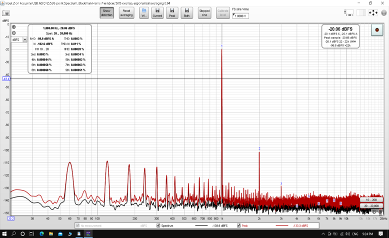

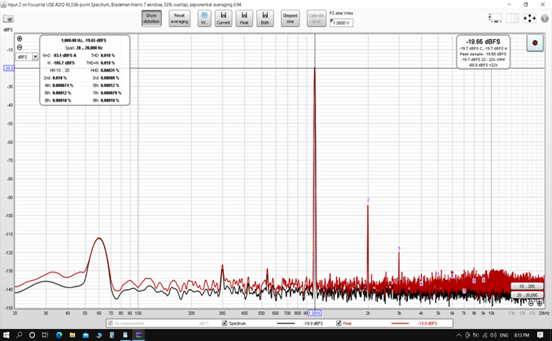

How Is It Measured? No Big Difference.
Beautiful F4, main 2nd harmony and very little 3rd harmony distortion. High order distortions are not visible. It can be seen the SMPS has even less interference from the power line.
Left traditional linear PS, 32VDC. Right SMPS at 24VDC

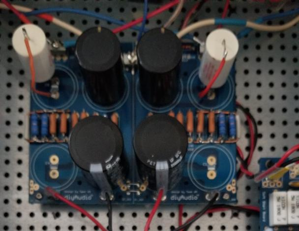

As a believer of big capacitors, two more 22000uF capacitors are back. The SMPS can still start. 2x10u Mundorf MKP film capacitors added to the capacitors army.
The sound improved somehow but felt still not as good as before.

The big capacitors behind SMPS lost its filtering function. But it might be still needed as an energy reservoir. Industrial SMPS have limited capability to dump big current at once.
For peace of mind, add a high frequency filter.
A even bigger SMPS with 10A output capacity with more capacitors but more cost.
I would say that the linear PSU has what I call the “forest of noise” problem and the SMPS has a much lower noise baseline. You may have a ground loop somewhere with the 60Hz peak, but overall noise baseline is much improved.
