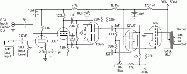

Awaaaaaay back in 1974 I built this amp that had a 6N7 (actually metal VT96) output valve. I was fascinated with it because the output stage consisted of a driver / phase splitter tranny, the 6N7, and the output tranny. That's it!! No capacitors, no resistors, no bias supply, no nuthin. Just iron, copper and vacuum. The driver tranny was driven by a single 6A3. I just had to build it to see what it sounded like. Given the signal sources of the day
it was really clean and smooth. Way, way better than what I could have expected given it's underwhelming simplicity. Has anyone around here ever built one of those?
I was thinking the other day about 6C33's - now there's a honker of a valve if ever there was one - and IIRC it has two triodes internally, but do they come out separately or are they paralleled inside the bottle? If they are separate then I reckon this would be a good candidate for this kind of setup. Of course the plate voltage would have to be significantly lower than normal. One drawback is the need for a driver transformer because the grids draw current when driven positive wrt the cathode (22mA peak at +41v wrt cathode for 6N7) and so I was thinking you could drive the grids from a normal RC stage with the help of a fet source follower. Not the purist approach but you probably wouldn't get put in jail for doing it. Ahhh.... if only I had a 6N7 and an output tranny nowadays...

I've drawn up a few 6N7 class B2 stages before. It doesn't take much grid current, especially given how far up the grid goes, so it's pretty easy to drive (compare to 12AU7, I dare you!).
- At the time I figured it would only be good for guitar use due to crossover distortion characteristic of class B operation... but we'll see! (Actually, with the load seen there - I think! - it's more like class ABB2. 🙂 )
Tim
