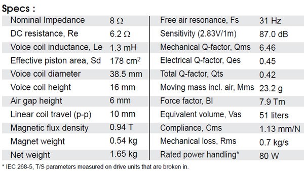

I would like to build a MLTL enclosure for the SB Acoustics SB15SFCR39-8 racetrack driver.
Initially, I was hoping to simply make a bass reflex speaker, but the dimensions I have in mind have sort of disqualified that enclosure style, if I'm not mistaken. I am aiming for a very slim tower speaker, with an external width no more than 6". Likely, I will use 1/2" thick wood for the sides of the speakers, to allow 5 inches internal width. I am less particular about the depth and height dimensions, but I have in mind something along the lines of 7 inches deep and 35 inches tall. This sort of extreme box ratio, if I understand correctly, necessitates a transmission line style design?
I like the idea of an MLTL, since it still utilizes a port like I was initially hoping.
Perusing through online resources, it looks like my best bet is to use a software called Hornresp? I am wondering if anyone can point me towards a resource that would help me get started on learning how to use this software, and hopefully specifically in the context of designing an MLTL enclosure?
Thank you in advance. I also posted the driver specifications of the SB woofer, if anyone has an opinion on the suitability of this driver for the application I have in mind. I like it because it has a good bass response, while being slim enough to fit in a tiny enclosure like I have in mind.

I used the racetrack for a MLTL.
It is a very good driver, and like you said, mounting it vertical makes for a nice slim tower. You can then add a little 2~3" wide range driver in a sealed cone to handle higher up. Works very well. The SBA will go down as low as 35Hz in the MLTL.
Plenty of Youtube videos and instructions on the net, a short Google search will bring out a few. HornResp will also come up with a basic design if you follow the System Design, once you selected to edit a design, and it will help you start your design.
You will need a bit more than 5" internal. Not much, but it will need a little more room to breathe

Thank you for your reply! Indeed, it is my plan to add a midtweeter to cover the rest of the range. At what frequency did you cross over your speaker may I ask?

Also, what would the consequence be to ignoring this advice? If I was absolutely set on that width, would you say I would be better off choosing a different driver? Or would the SB still be suitable, just under less than ideal conditions?You will need a bit more than 5" internal. Not much, but it will need a little more room to breathe

I am with perceval in recommending a WAW. We often use 3” (sometimes 4”), favorites are Alpair 5.2/3, FF85wk, CHN-50 on the cheap. These, in the approproate mid enclosure are good to about 250 Hz How low you cross is a compromise between:
1/ At or below the quarter wavelength of the centre-to-centre of the drivers. The closer they are the higher the XO can be
2/ bafflestep: At a certain frequency the sound goes from 2∏ radiation to 4∏ and, if in an anechoic conditon, a 6 dB loss on axis. In a room is is a much different case, and one has to weigh falt on-axis with flat room response. If you cross somewhere between 0.707-1x the bafflestep F(-3). This is related to baffle width/shape. It will be higher with a narrower baffle. This roll off has a shape.
In a WAW you can get the XO low enuff that a pair of woofers cam be mounted push-push on the sides completely eliminating bafflestep (from the woofers), as well as creating a situation where active reaction force cancelation dramatically reduces the vibrational load on the box.

Interesting. What is the highest frequency at which you would still recommend this side mounted method? I was under the impression that anything above 100Hz or so and it would still be required for you to front mount the driver, where the sound would become noticeably directional?In a WAW you can get the XO low enuff that a pair of woofers cam be mounted push-push on the sides completely eliminating bafflestep (from the woofers), as well as creating a situation where active reaction force cancelation dramatically reduces the vibrational load on the box.

Wow, that does sound high. You achieved good results though at that frequency? I don't think I would cross nearly that high, but if it sounds good at 450Hz that encourages me that I could get away with 250HzWe used SilverFlute W14 up to 450 Hz

: you can easily figure this yourself in that sound is round (spherical) and expands/contracts exponentially, i.e. if the baffle is 6" and and the driver around the corner is 3" away, then CTC spacing is 6" = ~13543/(pi*6) = ~ 718.5 Hz and since we want to overlap the baffle at least ~ a half octave = 718.5*0.707 = ~508 Hz max XO.

Myself, I believe I crossed at 300Hz. a bit higher or lower will depend on the driver chosen on top.
