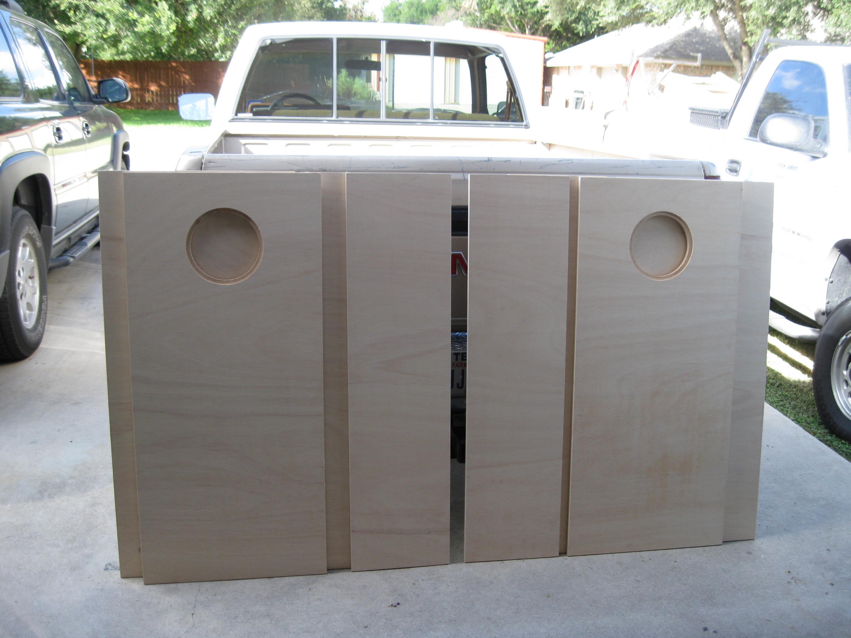

New project. Woods cut and assembly has started. It's 6.226ft^3 cab. 21x13.5x48 od.

Thats them. Thanks for putting them here. The main part of the cabs are done. Need to figure out the bracing inside. Still waiting on the ports from PE.

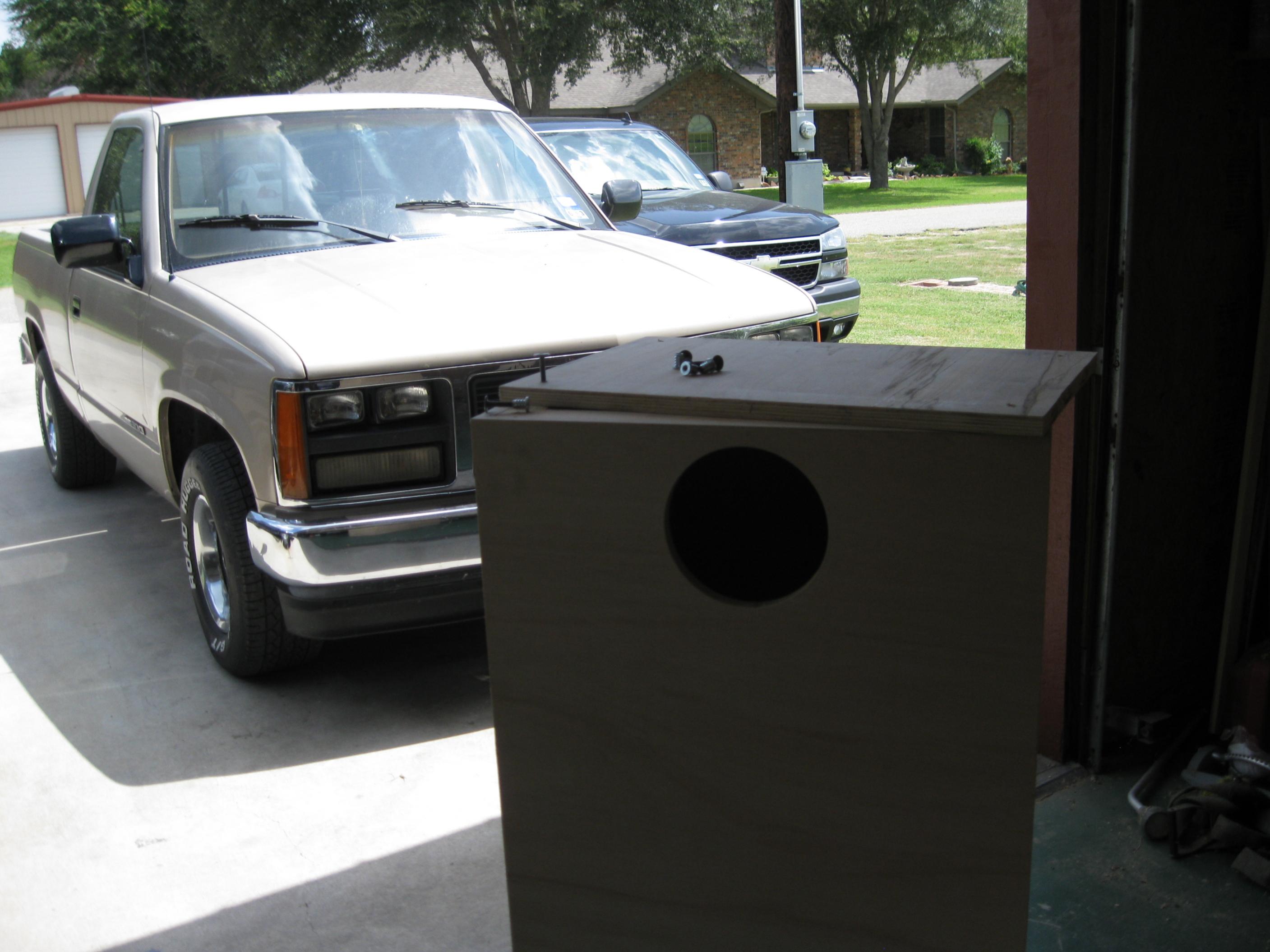

There birch ply. I think I'm going to put x braces just below the driver and then about 14" up from the bottom. I'm going to make the bottom bolt on with a gasket to seal. That way if I need access to stuff, it will be easy.

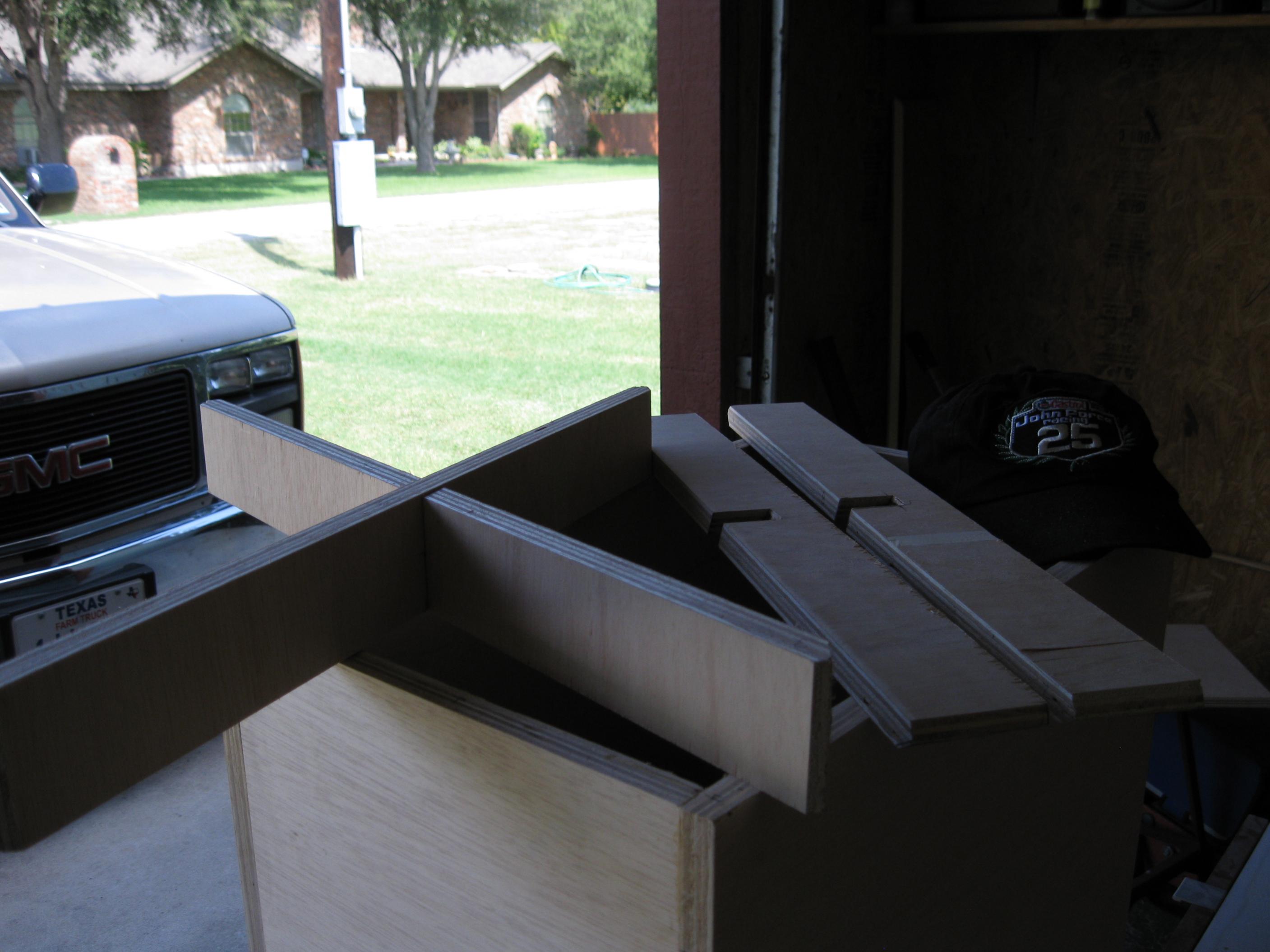

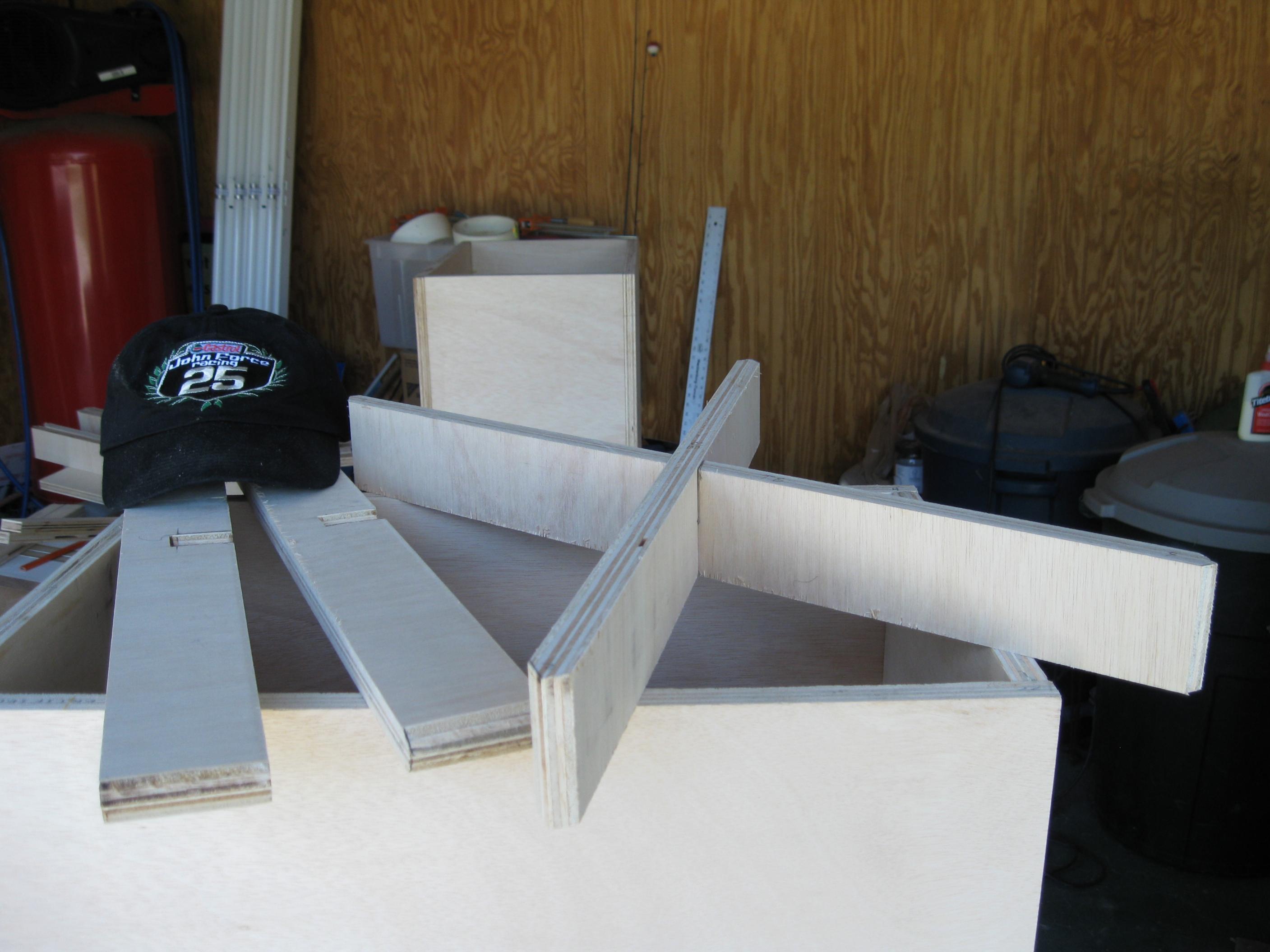

Made some interlocking x braces 2.5x 3/4". Cut top covers.
Made new braces today. Two 3.75x3/4 from top to bottom with 3/4x2.5 cross braces. All interlocked and glued in. Still waiting on ports from pe. Going to need a hand truck to move them.lol

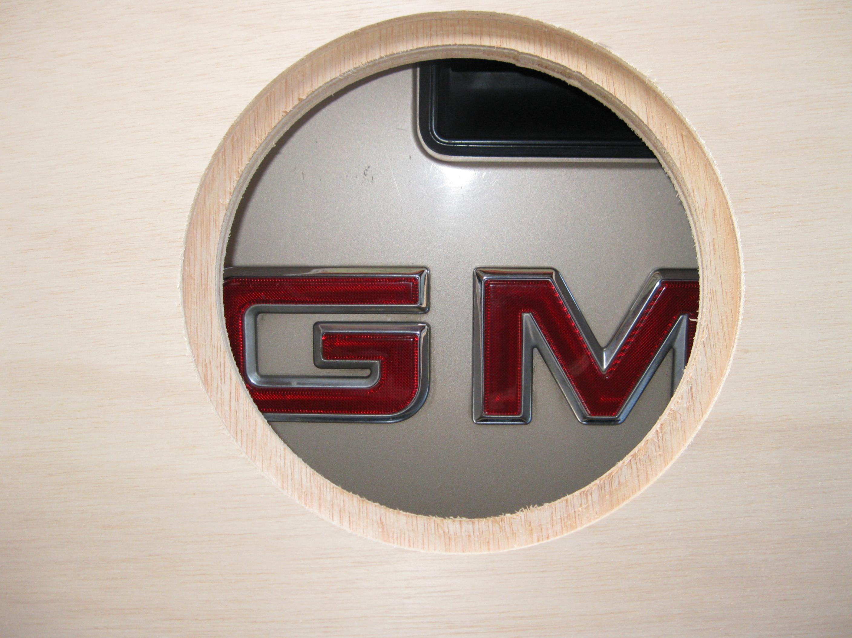

The cutout for flush mounting the BestyK is 1/4" deep x 8 5/16" dia. The cutout for the speaker is 7 3/8" dia. Metric is .625 deep x 211.138 dia. Speaker cut is 187.325. I cut the recess for the flush mount 1/4 deep. Then kept moving the jig smaller until the recess was 1/2" wide. Then cut the 7 3/8 cut.
I had to buy alot of tools. I bought some second hand. The jig I bought for the router sure made it easy to cut the port and speaker holes. Hope that helps.

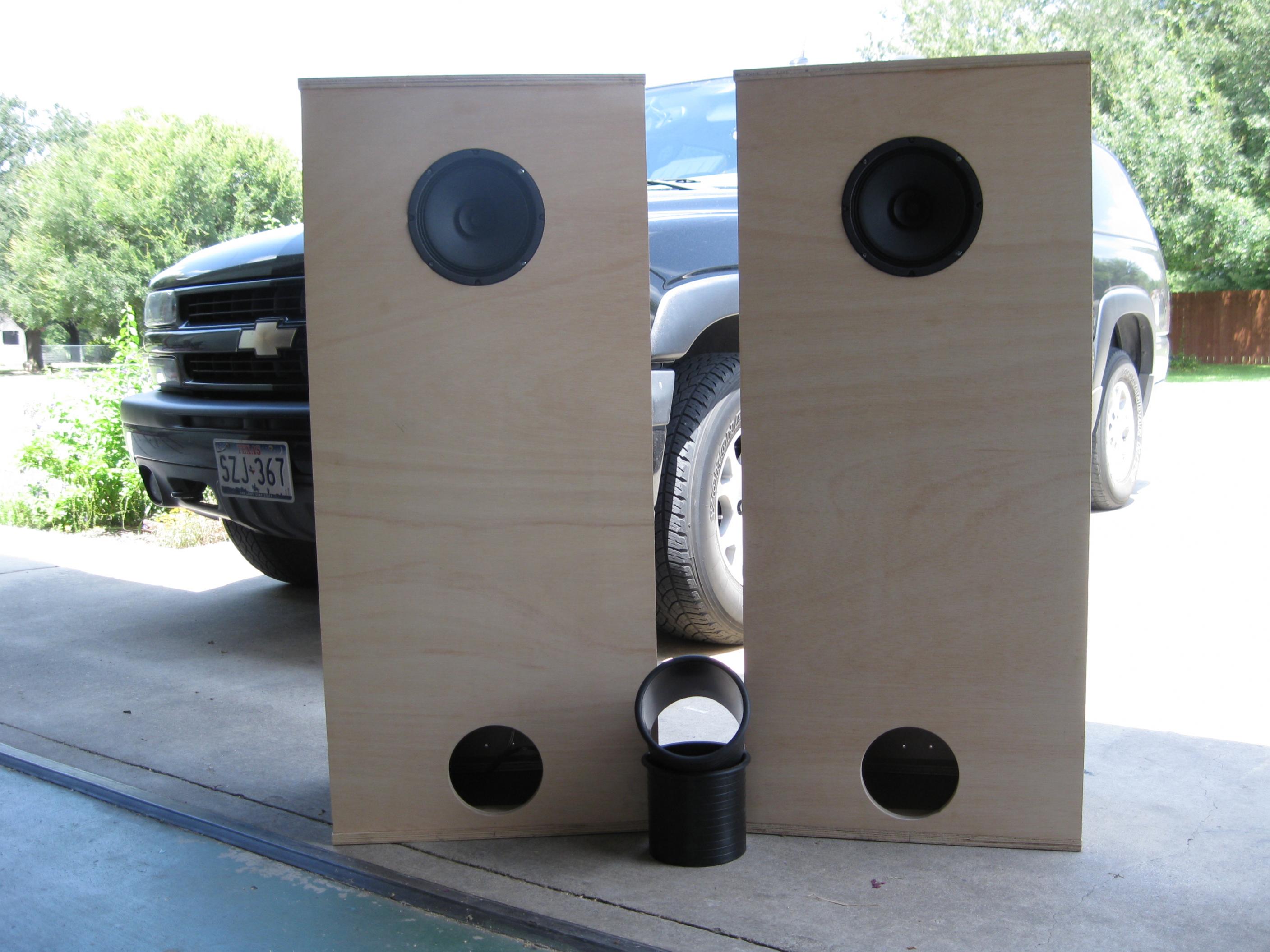

Got alot done today. Ports came in. Wires are run. Looks like a test run tomorrow. Still need sand and finish. Pics later.
