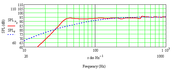

Hi guys, I like the shape and stance of this enclosure:
mjk's project 2 ML TQWT -
http://www.quarter-wave.com/Project02/Project02.html
Now the nearest info I could find on the driver was this sheet🙁click on it and zoom in in picasaweb)
and another that say Fs was 55Hz.
Will this go in one of these? I mean I'm going to give it a go anyway, but I'm not sure of the dimensions of the enclosire, nor the position of the driver.
Cheers, stevo.

Looking at that, I have my doubts. That page indicates that they were used when new in slotted (nee ~resistive vent) boxes, suggesting to me they're a high[ish] Q design. If so, you'll likely get an uncontrollable bass response as-is.
FWIW, I just ran a check on that box with the high Q Visaton B200 just to see what's going on with a unit of that sort. As-is, response is what you'd expect (vile). However, if you damp / stuff the entire cabinet, and stuff the vent too to make it a quasi aperiodic alignment (while keeping the aesthetic of the cabinet), it does passably enough down to about 50Hz or so.
So, basically I'll be just using the design as asthetics only, and won't be helping the driver.
and is probably better of in a 2 way simple sealed/small ported enclosure being a high Q driver? correct?

The metronome is simple conceptually, but depending on how anal you want to be about your construction making all those non-parallel cuts can be a PITA.
I'd bet the BIB is a simpler build.
stevodude said:Metronome
simplest to build, 4 sides, top bottom, port. - can't find a plan for the fe206e
Use the 207 dimensions. You might need to add more correction. You might not.
BIB
the calculator doesn't have the fe206e listed...
Yes it does. And anyway, that's why they call them calculators: you can enter specs into both sheets yourself you know -all you need to do is type in the driver Vas, Qt & Fs. 😉
stevodude said:or bruce
Decent but superceeded as-is by Chang now.
If you want quick / simple & have corners to load them into (they're corner horns) then the BIB would seem to a bit of a no-brainer.
Alternatively, as you like Martin's ML TQWT, why not use that. Using accurate 206 specs (average of 8 drivers) measured by Dave, from a technical POV it should work OK in that box, no modifications required, as shown below. I think it should squeeze in, physically.

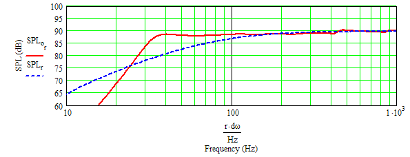

I've done a basic model of the metronome for the fe207, which will fit the fe206e in no probs.
I've modeled it on 3mm Plate steel ( as I have quite a few large sheets lying around over at the farm shed. ), so once I finish weilding up my ride on mower , I'm going to build a pair of steel metronome's , if anything it will give me some more experience with the weilder. 🙂
I've seen a BL horn built out of steel, and i want to give it ago, as all it will take is my time for welding, no other cost, so nothing to loose.
I've uploded my metronome sketchup into 3d warehouse if anyone wants it. Dimensions I just checked are slightly out :-/ but only by a couple of mm, soe probably won't make any difference.
Port I guess will be 3" (75) x 3"(75) long?
and basically line all the walls with some sound deadening, may not need any cotton fill?

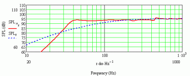

So what would the difference between:
a: Metronome project06 http://www.quarter-wave.com/Project06/Project06.html
b: MJK ML project05 http://www.quarter-wave.com/Project05/Project05.html
assuming both made out of the same material, and using the same fe206e drivers...
My understanding would be that the MT ML design would have more bass?
The link you have posted which you titled metronome is not actually a metronome. Though they are both tapered quarter wave tubes, they have different tapers.
The metronome has a quadratic taper. This can be seen because all sides are angled and all sides dimension expand from top to bottom. The link has a linear taper since only one side is sloping.
As for bass output you will have to wait for the experts for that one. I don't have any experience simming anything yet.
ah yea, my mistake, should have been http://www.frugal-horn.com/metronome.html

Anyway, I don't understand what you're agonizing over. Why not just scale up the Metronome to match MJK's net Vb which yields not only the same tuning with his vent, but has a theoretically better frequency/impulse response, especially with the smaller diameter vent, though doubtful it's audible enough to matter.
Using Scott's dims except SO = ~18.65"^2, SL = ~147.8"^2 and either a 3" dia. x 2.5" or MJK's 4" dia. x 6" vent (5 ohms series R added):
