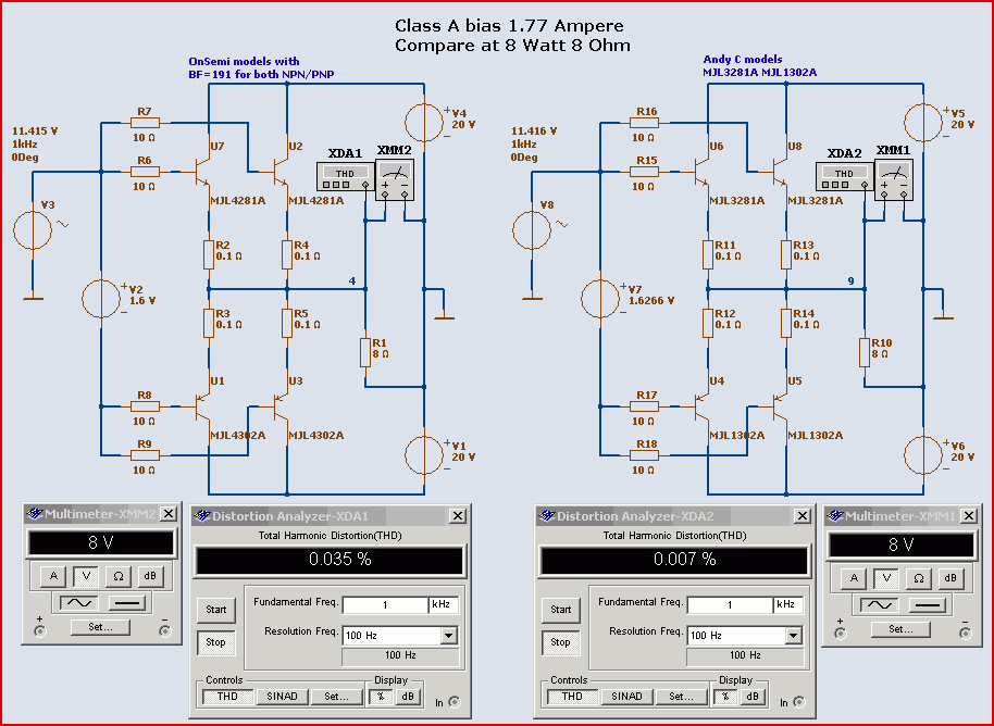

Mambo said:I noticed a great difference in the BF value of their models, with one = 191 and the other = 505.
From the datasheet they should be very similar;It seems another OnSemi error
My question is, as I do not know what BF is:
Can BF be as different as 191 to 505 for two NPN, PNP in the same class?
MJL4281A NPN has BF=191
MJL4302A PNP has BF=505
Both models were done August 2003

I did a run of on-semi spice of MJL4281+MJL4302.
VBE vs. Current looks very good.
But HFE base current vs. collector current is very bad.
The PNP MJL4302 has way too high gain. (Should be lower than the NPN)
When I changed to BF=191 (from 505) and so using same BF for both PNP and NPN the curve matched much better.
Judging from the datasheet the BF for the PNP should be a bit lower.
But how much lower I do not not know.

Here is my test to see how Andy C models simulate, compared to current models for download at OnSemi
http://www.onsemi.com/PowerSolutions/supportDoc.do?type=models
This setup uses 2 complementary parallelled pairs for Push-Pull output.
Class A biased at 1.77A (0.88 A per transistor). Supply is +-20 Volt.
Test level is 8 Watt into 8 Ohm.
Andy C models gives a bit higher -3 dB frequency, too: 27 MHz vs. 21 MHz
THD 0.007 % without feedback.
The 3rd is higher than the 2nd harmoincs, in this output stage
Do I have to tell, what spice models I will use, from now on 😉
