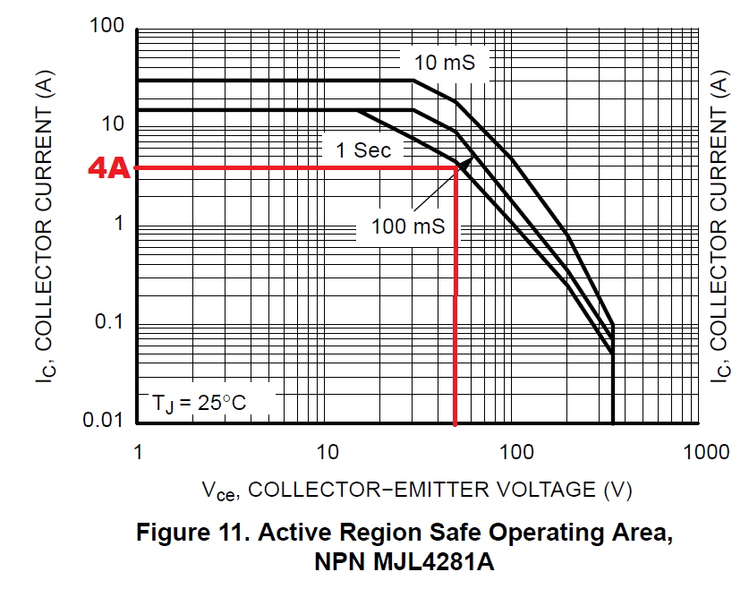

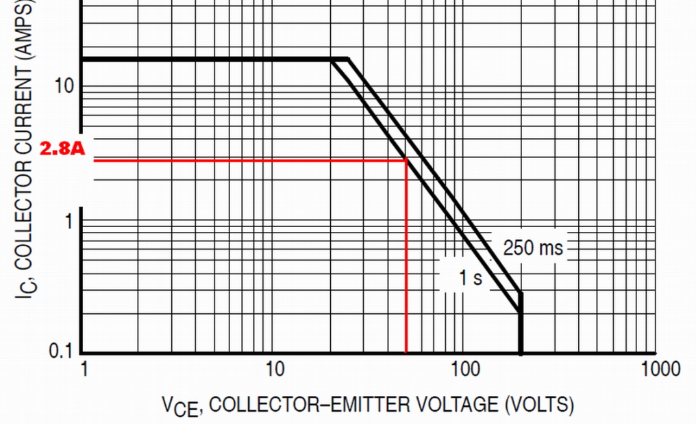

MJL3281A/MJL1302A vs MJL4281A/MJL4302A, which will be better?
I'm building my power amplifier. I'll use ON-Semi power output transistors. I'm using Sanken LAPT 2SC2922/2SA1216 in prototype versions, but i like ON-Semi's transistors.
In my country, the prices of MJL4281A/MJL4302A same MJL3281A/MJL1302A, about >6.5$ each.
In datasheets, MJL4xxx have more Hfe, higher Ft. But MJL3281A/MJL1302A have symmetrical characteristics in complementary pairs and matched Hfe (within 10%) from manufacturer.
Characteristics show MJL3281A/MJL1302A look very symmetry between NPN & PNP, more than MJL4281A/MJL4302A.
So, which are better? I'll use 6 pairs in output stage, matched gain complementary pairs are very important!
Please tells me what you think. Thank you!!!

Comparison of these transistors can be made considering several aspects... because of power my vote goes to MJL4281A.... it looks more powerful... and this is very obvious, because it is more modern and they do not release worse new models if you compare to previous models.
Sanken 2SC2922 seems to play more treble.... it looks to me, but i have not made A to B comparison...so...it is just "i think so"...and i think so is not science.
The one i trust the most is MJL4281A and it's complementary.

So, i agree with Destroyer's comments. MJL4281A/MJL4302A are modern devices with parameters better old devices. The symmetrical characteristics between NPN and PNP what i want comparison, and the MJL3281A/MJL1302A seem to be better.
So, if i buy MJL3281A/MJL1302A i must be match Vbe. Gain not needed, because the manuafacturer did it. 10% is good number, we're not commercial manufacturers, can't buy a tons transistors to match.
MJL 4281A/MJL4302A they'll need match Vbe and Gain.
