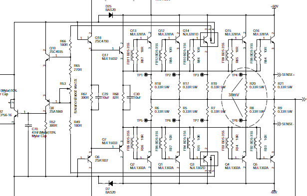

Harman Kardon do absolutely the same in their HK990 amplifier, using 5 pairs of output devices, where only one pair is Thermaltrak:
Sajti

There is no fundamental problem mixing NJL and MJL devices. The power transistor die are identical, and many commercial amplifiers that use ThermalTrak devices use one NJL and the rest MJL. Depending on your concern about beta and Vbe matching, just be aware that the die in the NJL and MJL parts you have most likely cam from different wafers, just as they would for MJL devices bought at different times.
If you are using Triple output stages, beta matching is usually not as important, as there is plenty of current gain. However, if you are using relatively large base stopper resistors and relatively small emitter resistors, current hogging among paralleled devices can be a concern of beta among the paralleled devices is significantly different. If you use 2.2 ohm base stoppers and 0.22 ohm emitter resistors, this should not be a problem.
Vbe matching is pretty good these days due to overall process uniformity. Nevertheless, it does not hurt to check Vbe between the MJL and NJL devices and see that they are not too far different, perhaps within 10mV of each other.
Finally, although there is no evidence of a difference in the spec sheets, it is conceivable that the NJL parts could have a lower junction-to-case thermal resistance if there was something about the construction that required a larger structure inside to make room for the diode on the header. I doubt this is the case.
Bob
Bob

Hi Jan,
In principle that works, i.e., just make one NPN the ThermalTrak and use only one diode for thermal feedback. There is a caveat, however. Depending on the details of the bias spreader and how picky you are, using only one ThermalTrak will give a thermal feedback voltage that is potentially rich in second harmonic at low frequencies. Using one NPN ThermalTrack and one PNP ThermalTrak tends to cancel out this dynamic effect. I could be wrong, but I seem to recall that the thermal time constant from BJT die to the diode is fairly fast, maybe as little as 20 ms. I just don't have my book in front of me now. This consideration may be in the "everything matters" category for highest quality audio performance.
Bob
