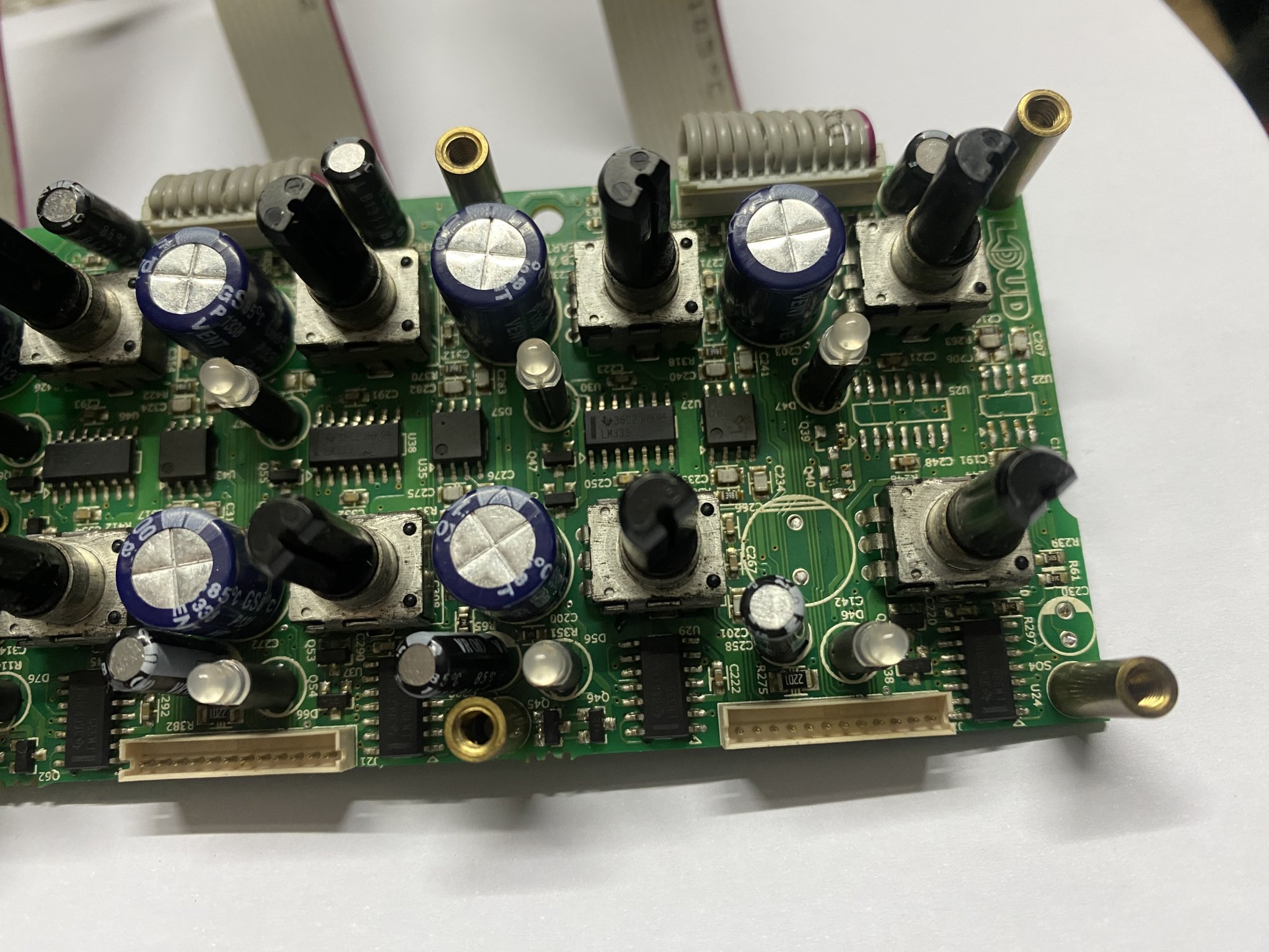

I have a Mackie DL1608 digital mixer with analog preamps with a weird problem.
The problem lies within the preamp circuit.
The hiss is common to all channels at very high gain, close to max all of the sudden a hiss appears, even without anything connected to the preamp.
Could this be mitigated or eleminated?
But one of the channels has a different problem,
With a mic connected if I increase the gain to the noticeable hiss zone and grab or excite (talk) into the mic, something that will light the signal led, it produces a kind of humm effect that latches and does not go away unless I reduce the gain out of the hiss zone.
I will post the schematic for the preamp
Any ideas?
I have swapped op amps U21 and U22 on channel B-1 with other channels and also electrolytic capacitors C142 and C230 but the problem did not go away or migrate.
Thanks for any help!
Update!
The sound is not a hum it sounds like switching noise.
I removed u24 ic, q37 and q38 which are responsible for lighting the signal led d46 and the noise goes away, still don’t know what could be causing it.
With these parts installed from a good channel the noise is still there
The noise only occurs when the signal led is on!

The schematic shows that there are many different internal ground nets. Could something have gone wrong with the grounding, causing excessive crosstalk from the LED driver to the signal path? Increased ground resistance due to a dirty connector, for example?
In old-fashioned big console mixers, the design was usually so modular that you could easily swap entire channels. If that should also be the case in your mixer, you could take out the module for channel 1 and swap it with some other channel to see if the problem moves with it or stays in channel 1.

OK that is all good info. If I inderstand correctly the noise only occurs once an input signal is high enough and that results in the signal led staying on? I'd suspect this (LED stays on) is simply a result of the noise signal being present and constant which means there is probably nothing wrong with that part of the circuit.
A switching noise would originate in the power supply, there would be filters for that but a failing capacitor could leak some onto the ground which then finds it's way into the audio circuitry. Do you have a schematic for the power supply?

Attached is the preamp section image and a link to the full service manual

Check the +/-15V supplies and ground in that channel are correct (and have low-ohm connection to the rest of the circuit), and test the transistors that drive the LEDs for that channel. Look very carefully at any solder joints for dry joints or hairline cracks, especially on the potentiometer legs which will see mechanical stress in use.
I fear there are many ways it could fail and it may take some hunting down. For instance it could be a fault at the other end of the ribbon connectors too...
