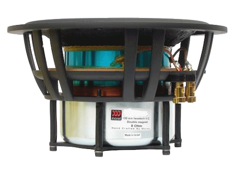

Almost makes the 12" Morel cheap 😀
5" voicecoil on a 12" driver, thats a monster

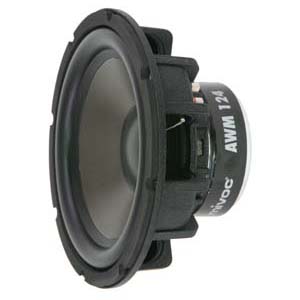

The AWM104 is a great value driver in 10-14 liter closed.
Good enough to have a -3dB of 30Hz and a maximum of 100dB.
