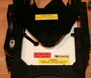

Just come across this site and wondered if anyone could help me. I have a Mission PCM7000 which I have owned from new (purchased for £800 in 1987). The laser has finally had its day and now skips. I have it inot a workshop who confirmed this stating I need a new CDM 4/31 laser assembly, but are not able to source one due to its age. Would anyone have any idea where I could get one of these?
I understand the CD transport is the Philips CDM 2/10, but I could be wrong with this.

cdm4/31 is the replacement unit for the cdm2 unit, complete with pcb. Finding a 4/31 will be difficult.
A better option would be to find a cheap playing philips (based) player with cdm2 and swap the transport. They are still around.

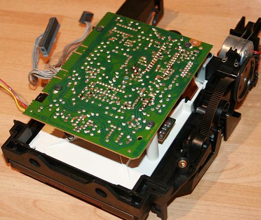

So get it back and open it up. Then take a picture and post it here. See what's in there.
And if you can do measurements, take a philips service manual from a player with that cdm and first find out what the problem is.

The cdm4 is a later version after the cdm2 became 'obsolete'
I think the servo components are different but effectively they are indentical.
I would have to see a photo to check on any differences.

A cdm2 has a hall motor. The 4/31 does not iirc. I've seen claims that the hall motor is better (gives less pollution, electrically speaken).
There are cdm4's with hall, but not so many (4/11 and the metal one)

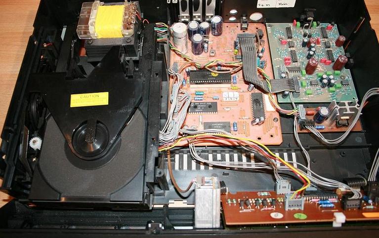

Mission PCM7000 Cd player
All the way from the UK to the Indian Ocean and back ( actually to Norway and back via satellite )
As can be seen, this is a standard Philips player modified by Mission with the addition of the extra audio board.
For drive details and info :-

Yep,
Looks like it's based on the philips cd650. Instead of the additional filter board, it's the mission pcb. With connection to front, so i guess it has volume control (?).
Main pcb looks similar, even the i/v opamps are still there.
In the us, it's a magnavox cdb650 (i've got one of those myself). They sold the old stack long ago in the philips shops (for staff).
