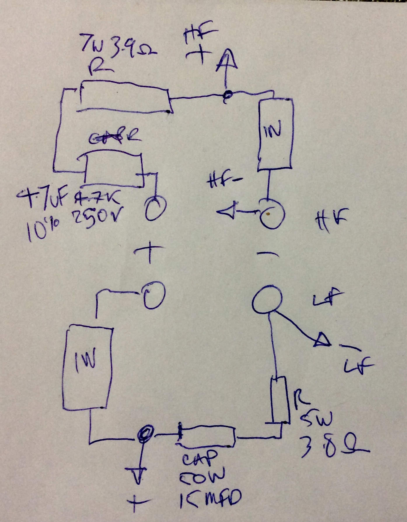

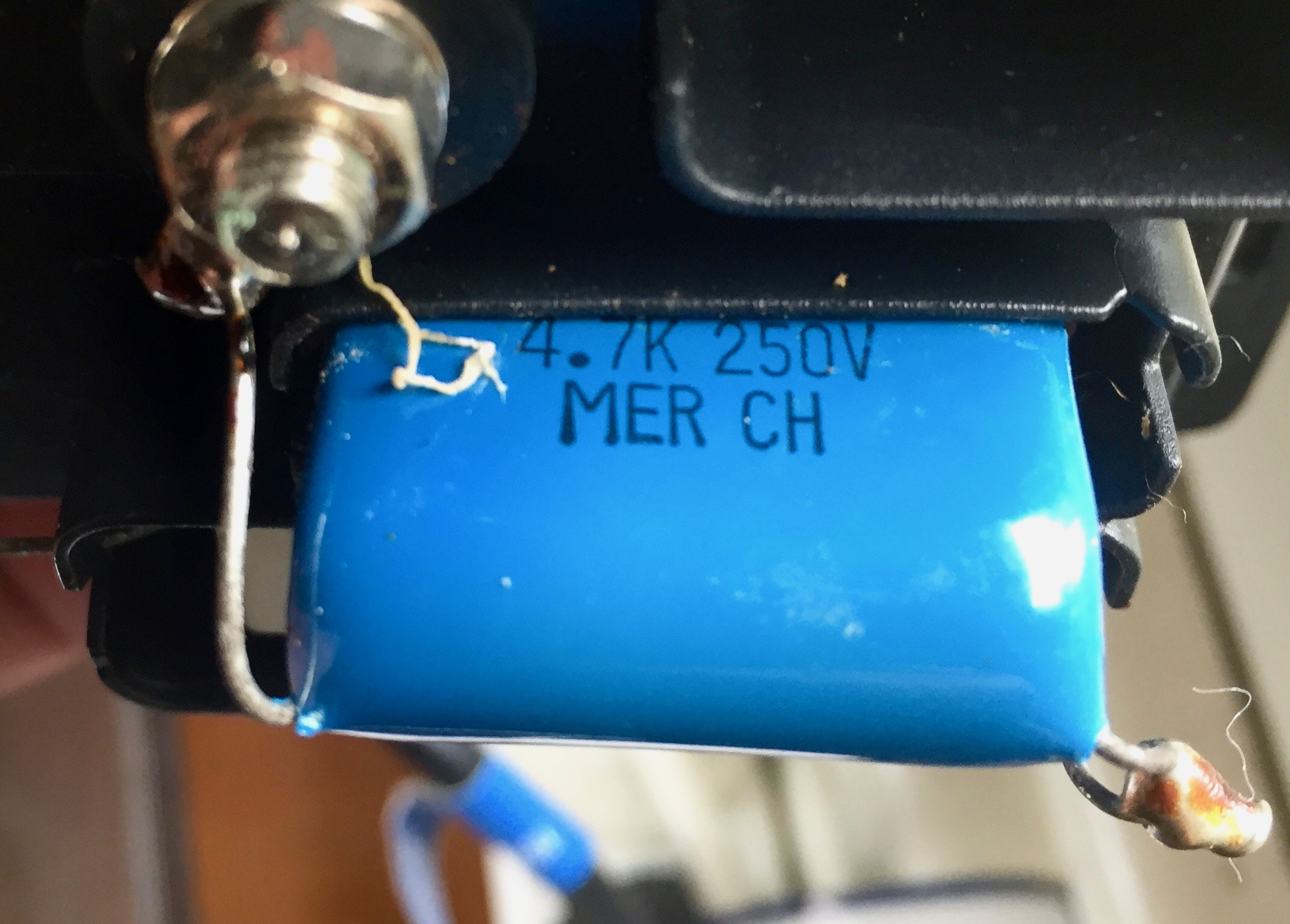

While I'm waiting to re-glue the baffles I'm taking a look at the xovers on these older Mission speakers. This is a total noob question, but am I right in thinking that the large blue item labelled 4.7K 250V on the HF driver side is a capacitor? What kind of cap would this likely to be?
