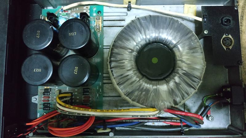

Mission Cyrus 2 psx power supply build
You do realize the PSX-R power supply is fully logic controlled and senses conditions on the Cyrus audio equipment its connected to ?
I have Cyrus power supplies as well as their XTSE+ CD player also their older DAC although I now use a more modern Chord DAC.
On checking with Cyrus website the PSX-R is not compatible with the Cyrus 11 (2)--it starts at Cyrus 111, you are therefore looking for the older power supply ?
This is +/-41 volts DC ( approx ) and +/-18 volts DC.
The Cyrus 11 power supply diagram ( internal ) is available on manualslib website
