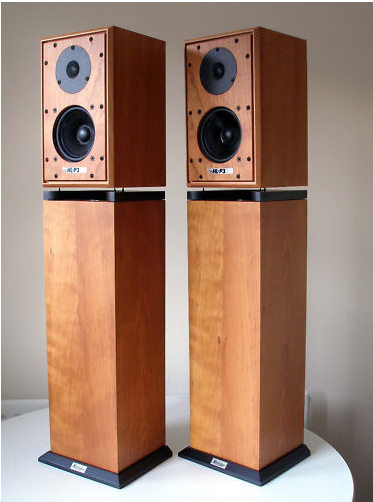

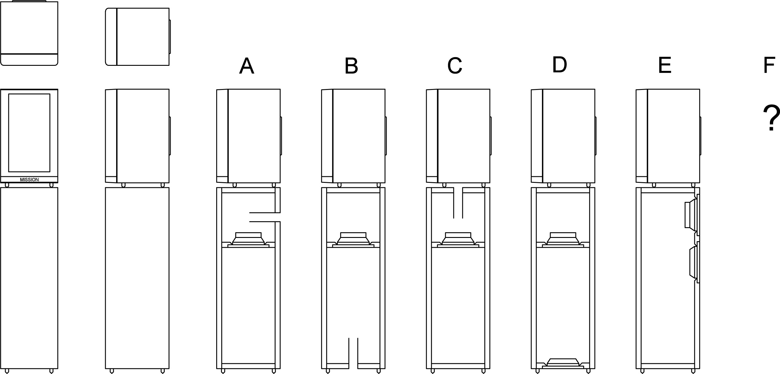

I like to own a pair of LS3/5 speakers but they are too expensive for me. But then it hit me! Could I build a AB1 like “Bass extender” (see attachments) for my 760i speakers?
This is not my territory of knowledge…so there a “few” questions. I also don’t have software to see if it would even work.
The dimensions I (now) have are: Height 570mm, Wide 180mm, Depth 200mm and I want to use 18mm MDF so that would result in 20,5 litres.

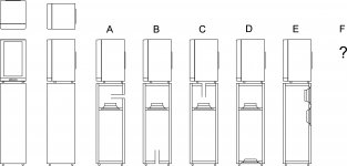

I have sketched some ideas in the attached picture, “A” is like the original AB1, “C” is like the Harbert version. The other versions are just ideas but I must admit that the idea of a passive radiator is high on the “try it out list”.
I had a look at some 5 inch (130mm) speakers but it is a bit pointless if I don’t have a clear idea of the design and final dimensions or vice versa.

The AB1 and clones incorporate filters for the mains and
a precisely tuned high pass in the the style of A and C.
B and D are both useless without the low pass ports of A and D.
A and C are 4th order - 2nd order, sealed high pass.
B and D with top ports are 6th order - 4th order reflex high pass.
Its doable but complicated with a vented top speaker -
that would probably need to be converted to sealed.
The bass driver is 60-lfc13/bk, and given its vented
in the 6.5L 760i, 20L is plently for a 6th order.
TBH adding a powered sub is a lot easier, along the
lines of E or F (which is E vented) with a plate
amplifier in one of the boxes driving both.
Alternately just bite the bullet and accept the
760i is a cheap speaker, not worth the effort,
and simply build something like these :
https://sites.google.com/site/undefinition/diy/amiga
They would certainly sort out the bass issue, though I
personally I'd tune them lower than 39Hz to improve F6
and give tighter bass, say 34Hz, at the expense of F3.
rgds, sreten.
