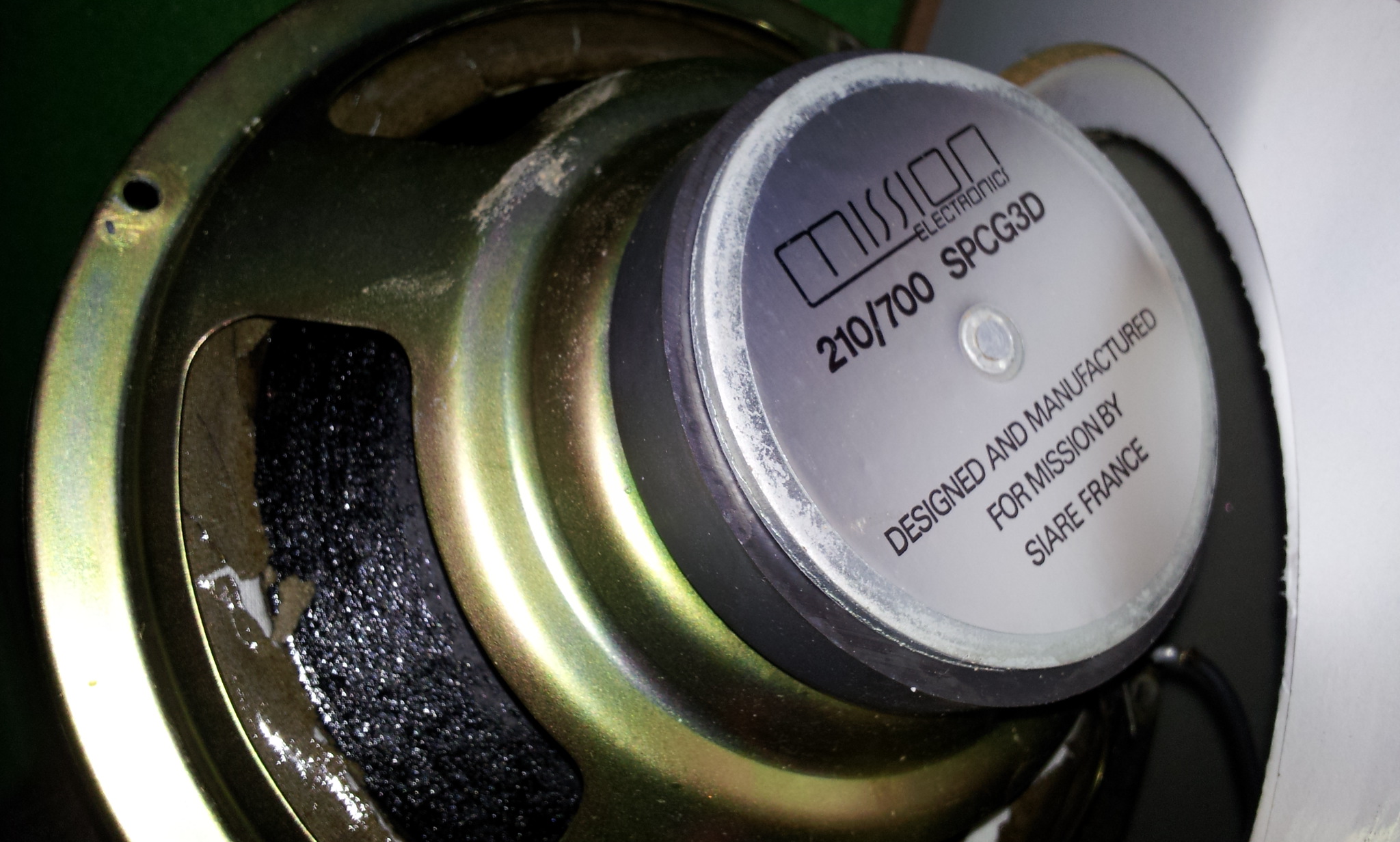

Trying to source replacement woofers, as the pic shows the orig was made by Siare model number SPCG3D.
My old man has already tried years ago of taping splits up etc with predictably bad results but say no more.
Tried to contact Mission but the webform doesn't send so Ill try again later. Also contacted ampaholics to see what they have.
I don't necessarily want an exact replacement if something cheaper/readily available will do the trick.

Thanks but it's the driver that's broken not just the surround unfortunately.
I'm tempted to try and salvage the cabinets and ditch the crossover and see if a full range driver will work, but bow to the forums better judgement first.
If not I'll have a look for a replacement woofer.

That link is perfect thanks!
I was also looking at adapting the cabinet for some Fostex FF165K as they are higher sensitivity and not too much dearer that the Monacor SPH 210.
thanks again, Im new to speaker building and hate to see old items left ruined really but at over £80 to repair i could prob buy some from ebay and re foam theirs.
converting to full range drives would work perhaps?

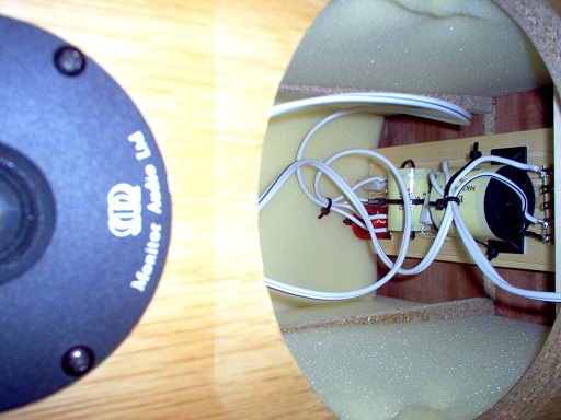

Hello,
I'm trying to find out if my driver is broken on a one Mission 700 speaker I want to restore. The speaker part itself looks in very good shape. The driver itself too.
Still I only hear the tweeter vaguely with no mid or sub at all.
Is there a way to find out which component is "broken" on the driver board?

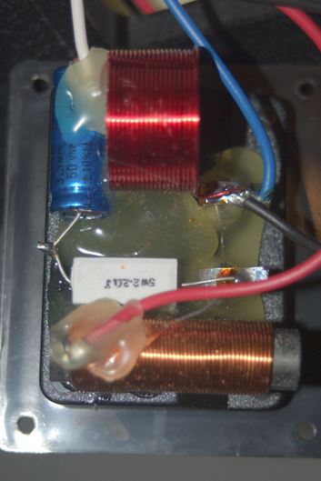

Bloopler, make sure it's from the driver and not the crossover. Connect the faulty () driver to the other speaker crossover and check if it stands.

Sure there is. Connect a 1.5V AA battery across the woofer terminals and you should hear a scratchy noise if it is still working. The woofer should move forward with + to + polarity on this test.
Or measure what you like with a multimeter on the low ohm scale and you should get 6R from a driver.
Not rocket science.

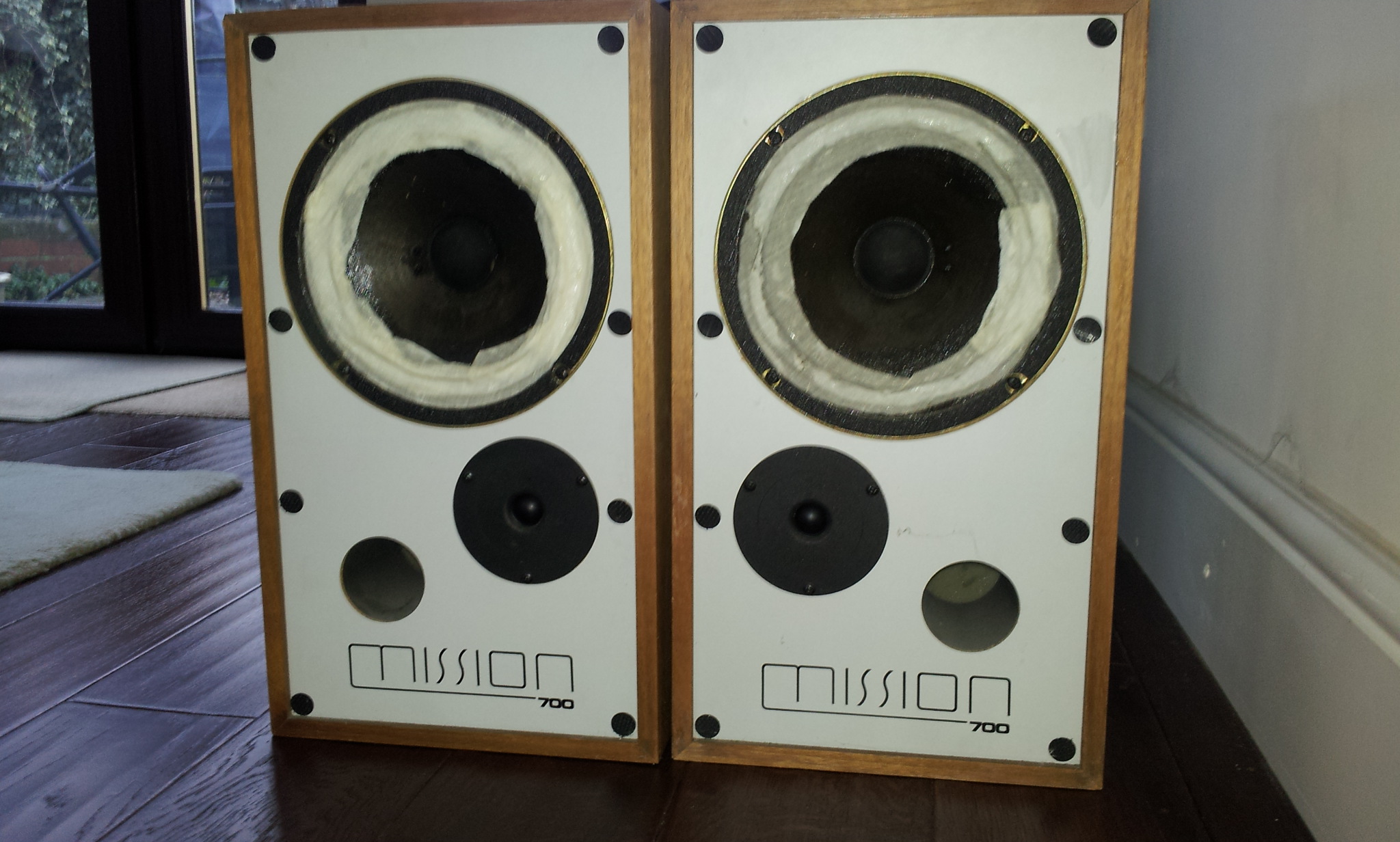

Hi all
I've got a pair of Missioni 700s from the early 80s. The woofers' foam is all eaten away and I'm pretty sure that they are not functioning properly. I contacted Mission who say that they only have replacement tweeters not woofers. So this forum suggests that the Monacor speakers are best (at https://www.monacor.com/en-gb/monac...gy/speaker-technology/hi-fi-speakers/sph-210/).
However they're not cheap and I'd be interested in finding out for sure if they are blown or whether the driver or crossover is damaged. But how do I do that? You can't access the cabinets other than via the speaker holes as far as I can see and the inside is lined with foam. I couldn't see the drivers or crossovers. Where are they?

Hi Trickyrf, Steve, probably best by refoaming. After saying that make sure everything is fine, crossover and tweeters

Fixing this speaker, whatever ails it, should be quite straightforward. There's really not much to it. Woofers are woofers, tweeters are tweeters. In this case it seems to be an 8" plastic polycone in 20L, which for noobs translates to a 6" cone, and what looks like a 94mm ferrofluid 3/4" soft dome.
Make a note of what wires go where as you disassemble, though this sort of speaker is always positive polarity anyway. Then measure the cutout holes to see what will fit, then just replace with new screws in new holes:
