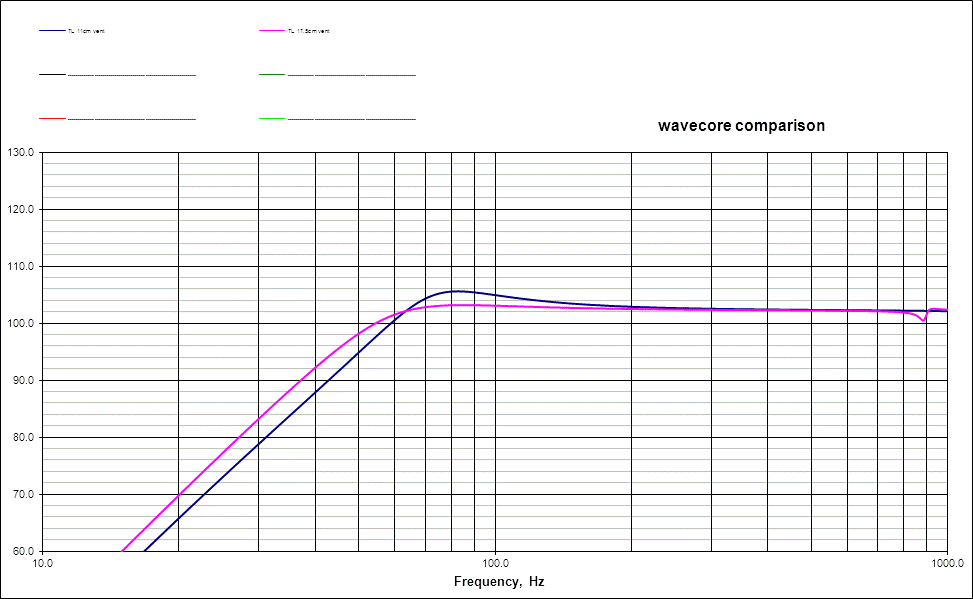

Hi Dexter, as the parameters for the two 4 1/2" drivers are fairly similar I averaged them and put them into unibox. I figured that with the drivers volume taken into account, + the electronics you were probably down to about 7L volume for the two drivers.
The 11cm vent will give you a tuning frequency around 65Hz. Dropping the tuning to 54Hz (17.5cm vent) looks like it will give a better response. See attached. dark blue is with the 11cm vent. violet with the 17.5cm vent.

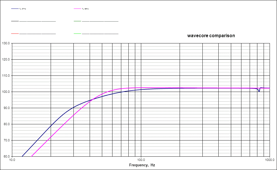

37Hz seems low considering the port size and length... However the modeling I did yesterday was wrong (I have just realized) 😱 . I actually had two ports configured so please ignore my previous post!!
The model says about 17.5cm for 37Hz. so if it is actually 11cm then perhaps we can work out an approximate length to try for a higher tuning.
49hz tuning (which looks good) calls for a 9.8cm port. so if we use the same ratio our port comes out at about 6.2cm. So you could perhaps try shortening the port to that and see how it goes.
New graph attached. dark blue is 37Hz tuning. violet is 49Hz tuning.
As dangus said ports don't always behave the way you expect, I found that with a little box I made for a 4" driver as well... I think probably the bigger the box the closer it is. My 70L vented cabinets are pretty much spot on. I don't know whether you can just cut by the ratio I have suggested or not..... I guess its a case of try it and see. perhaps just cut a cm off at a time and remeasure and see how it goes.
