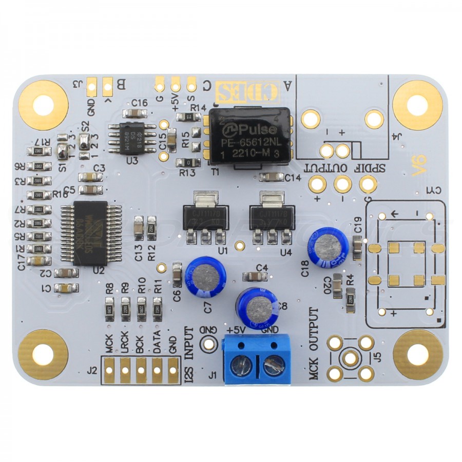

I used 2x WM8804 spdif transceiver modules from Twisted Pear Audio for my Minisharc solution. Super short wires are required for the i2s signals (less than 1 inch). Other implementations of wm8804 could also work as I understand TPA is winding down operations.

thanks a lot for sharing your implementation! It seems as if this device from Audiophonics may be what I need, i.e. four pieces for 2x 4-Way:View attachment 1171357
Interesting is that this is a transmitter only board, so no inputs are "wasted"!
So, I'm quite happy!
Thanks so far!
Winfried

I've decided to locate digital (miniSHARC based) 4-way x-overs and the DACs at the speakers (rear side), so I only have one (SPDIF) cable per speaker, and 4 short cables feed the 4 power amp boards (inside the speakers).
The miniSHARC based "preprocessor" (e.g. for Acourate based overall linearization) now has two BNC coax SPDIF outputs by using/adapting the two available SPDIF outputs of the Tentlabs masterclock/reclocker on the XO-3.2 (which I use as miniSHARC low phase noise clock upgrade). The preprocessor uses the openDRC 2x2 plug-in.
The 2 x-over processors are miniSHARC based openDRCs. And because the 2 Khadas Tone boards (each) fit into the cases, I can use the miniSHARC's SPDIF coded logic level signals (normally feeding the output transformers) and directly connect these to the DAC's logic level inputs. The x-over processors use the miniSHARC 2x8 plug-in, but implements only one 4-way chain per speaker (which provides more FIR Taps for each speaker).
