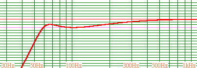

Are you using these as standalone speakers, or as satellites to be crossed over to a subwoofer?
I can give you a configuration that will give you actually decent bass. It is ported. If you are going to cross over below 140 Hz to a subwoofer then I would recommend a sealed.
This ported configuration has a group delay of 14 ms, which is a little high. Still, for a 5 inch in such a pint sized box, it will give surprising punch under higher power levels than you'd think you could drive a 5 inch.
One thing. I do not know if this has a symmetrical magnetic field in the magnet structure. Sometimes the voice coil of ported speakers, near the resonance frequency, will travel all the way back to the end of their excursion limits and just move forward from there.
Assuming it does not do this, though, the Beyma can, in a ported box, put out 106 dB at 60 Hz, with 65 watts input. For a 5 inch in a 1/3 cu ft box, that is kicking.
The volume of the box is 10 liters, and the tuning is 60 Hz. It is not a classic response where the level is flat until the end, where it dives down. This gradually moves down 3 dB, then dives at the end. Not a bad response, though.
It should be noted that most PA cabinets that DJ's use-the ones that are about 3 cu ft, (80 liters)-have a 60 dB cutoff. They play much louder, of course, but it is an illustration of how deep 60 Hz is if professional DJ equipment has the same bass cutoff.
Again, if you are going to use these as satellites, I would suggest a much smaller sealed enclosure.

Thanks a lot for your reply and your nice volume study!!
They are going to be not satellites but a simple speaker system for "kitchen" and non critic people stereo purposes, but as it is my first design (don't tell anybody...) I want to include all I've learn in the net.
With the same kind of response you gave me, I was thinking of a 7,7 lit, and F3 is 71 Hz, that I think is good enough for the time being. I didn't consider the group delay effect because I don't have the point cleared: Does this mean that (due to the port mainly) some frecuencies are delayed i.e. not time aligned and the bass might not sound "clear"? I imagine that because of that, if the system is crossed to a sub it "needs" to be sealed, am I right?
About the power managed, you stated 65w, I think this has to do something only with the excursion, right?
And what if I want a plain flat response until the cutoff? my winisd tells me that 3 l are to be needed, is there any minimum volume to respect? Does this make appear any problem due to the high pressure inside?
Right. I was dealing with excursion only with that figure. Isn't the maximum electrical power listed as 50 watts? Close enough.
If you don't mind the higher cutoff-well over 100 Hz sealed, about 100 hz ported-then you can get a flat response.
There are all many, many varieties of commercial loudspeakers that have a 5" in a small, 2 or 3 liter subenclosure installed into a larger enclosure with a 10" woofer. The 5" bass/mids-that is what you have-cross over to a 1" tweeter between 2,000 Hz and 5,000 Hz. This is a very popular design.
I am somewhat surprised that Beyma listed the volume range as 10 or 20 liters because it looks like the speaker is made to go into one of those subenclosures with with a low cutoff of between 200 or 400 Hz, depending on the size of the subenclosure and whether the designer wants to use the natural rolloff of the 5" speaker in his crossover plans. Some designers like to have a speaker entirely flat to an octave underneath it's cutoff, and then use electrical cutoffs exclusively.
It just so happens that this speaker works reasonably well in a ported cabinet up to 10 liters.
Not generally. I saw an Infinity system once with an array of 8" cones in a pipelike structure. The volume was so small that the speakers could only use 1/3 of their excursion.
However, I think you are okay with this. The smaller the encloure, the higher the cutoff, which means the less the speaker has to move. At 200 Hz, your speaker would only have to move about one tenth of an inch to produce a whopping SPL of 112 dB. You would have to feed it over 100 watts to do this. To produce 106 dB, the speaker would have to move only .025 inch and would require about 45 watts.

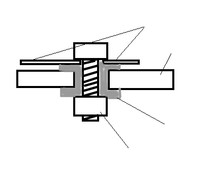

I have another question: The tweet is going to be in it's own enclosure, but if it wasn't, should I cover any space to avoid the pressure get the inside of the driver? Will this eat the space needed for the performance?
Hi Raka
Just about all tweeters are designed as sealed enclosures, so manufacturers can mount them straight into a box with other drivers for budgetary reasons.
But you can improve on this by mounting tweeters on a soft neoprene ring to isolate them from box vibrations, in wich case you need a sub enclosure to prevent back pressure from other drivers pushing the whole unit in and out in response to back pressure.
I never thought of that. What an excellent idea.
The sub-enclosure only has to clear the back of the tweeter by the narrowest of gaps. So the sub-enclosure should take up only a tiny amount of space.
