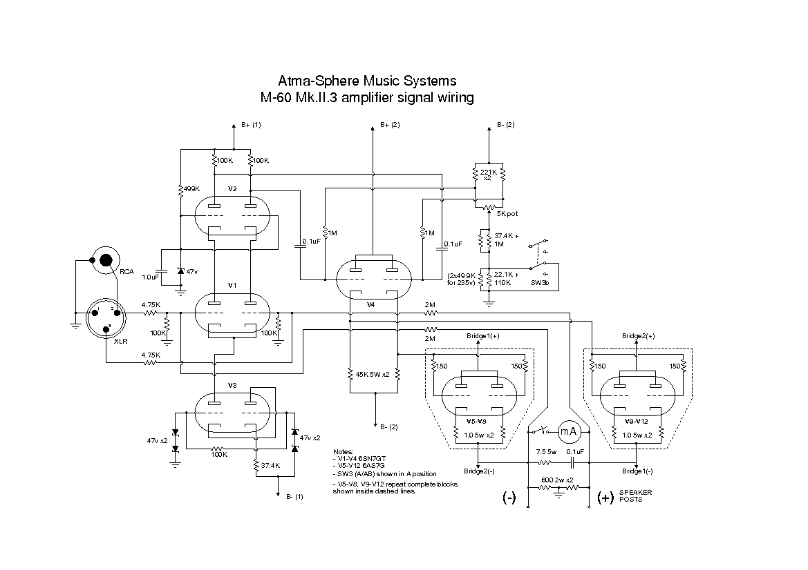

I built a guitar amplifier based on nearly the same circuit, which looks like this. It runs 16 ohms with about 20 watts and about 50 into 32 ohms. Very nice tone and does bass really well. Instead of PL519s, it uses 6AS7Gs (which are cheaper and easier to find) but you could use PL519s in triode and it would work, though not with as much power. You would need a few more PL519s (six, I think) before they would make more power than the equivalent number of 6AS7Gs.

Any specifics on yours? I figure I may as well duplicate a known-good design. 😀
Also, yours uses a single 6SN7 with two smaller tubes, which is very much different from the standard Atma-Sphere design.
The 6SN7 is the driver tube, direct-coupled to the power tubes as you see in the schematic below, from the other thread. The smaller tubes are 12AT7s, arranged in a differential cascode as seen below, only without the CCS, and of course there are only 4 power tubes. I raised the power tube B+ to nearly 200V, and reduced the plate current to about 30 ma, to allow the amp to take advantage of a higher impedance load. It makes about 50-55 watts into 32 ohms.

If you don't mind my asking, what, exactly, is a CCS?
Also, did you use the full-fat Atma-Sphere PSU, or perhaps something simpler?

CCS= Constant Current Source and is that bottom tube, V3, in the schematic. In my little amp it is replaced by a single 1 watt 110K resistor.
For the power tubes, I have two 2200uf 200V snap caps that I am using for each of the bridge supplies, so there are 4 total as you can see in the photo. I use a 1 ohm 5-watt resistor between the input and the output of each supply.
For the driver, I am running +/-300V with a power supply that is slightly trimmed down from the M-60. I have only 100uf on the plate of V4. That way if the amp is overdriven, there will be some modulation on the plate of the driver tube, which increases distortion, allowing the amp to cut 'through the mix' a bit more.
