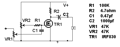

Having been a reader for a fair while the forum has encouraged me to try building an amp again - the last one was a valve amp in the 60's 🙂 this is based on various ideas on the forum and Nelson Pass's thoughts on Mosfets.
Having read the pass lab and solid state posts a Mosfet amp was in order from the parts bin (junk box) This is my attempt at a minimalist class A amplifier, 10 components per channel on veroboard. I'm surprised at its quality given the simplicity.
Some notes, I run this at 9 volts though 8 to 25+ seem to work with variations in R2, Testing seem to show the mosfet matters little, various IRF and some odd switching mosfets out of bust PSU board work.
Set the Bias current with VR2, at 9 volts on V+ 1 amp produces a good sound. set with an ammetre or measure accross R2. As its Class A a decent heat sink is needed, and an old CPU one worked well for me.
Thanks to all the posters for reviving my interests in audio electronics, its been fun building this and I'd like to share the results.

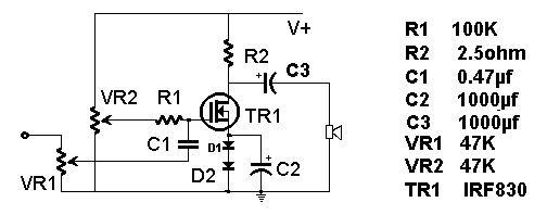

Nelson
I did try without diodes, Clipping distortion without the voltage lift from the diode junctions occured, I originally designed this with a resistor in place of the diodes but the power disappation was to much for the junk box 🙂 so a pair of diodes went in....
why 9v (9.8 actually) is due to a scrap 8volt 4 amp toroid I had in the junk box.
I read as many of your insights and thoughts on audio as I find, finding them inspirational, you are one of the reasons I have come back to real audo after a long break,
Alan
yaron said:
Hi Nelson
The diodes give 1.2 v to the source of the FET. He needs the gate to be in lower voltage from the source, so he put the diodes (and the capoacitor filter ac changes).
The IRF830 appears to be an enhancement mode device, not depletion. The Gate will need to be more positive than the Source.
The load resistor (R2) is 2.5 Ohms. At 1A bias, that's going to give you a 2.5V drop. At that point, the amp will clip asymmetrically. You could increase the bias, but that would likely blow the MOSFET in short order, as it's only rated for 4.5A, or increase the value of the load resistor to the point where the Drain of the MOSFET settles somewhere close to half whatever rail voltage you choose. That will (within the limits of the MOSFET) give you better clipping performance. Assuming a 9V rail and 1A bias, a 4.7 Ohm resistor will come pretty close. Use at least a 10W resistor and ventilate it well. 20W would be better--you'd be less likely to scorch your fingers.

thank you for all the observations, The parts used were what was to hand, designed the old fashioned way - scope and meter 🙂 I don't have a simulator 🙁.
Grey, I will acquire a suitable pair of power resistors and play, maybe I can drop the diodes that way, without them I got asymetric distortion far to easily.
The fun in building this and your comments have encouraged me to continue to see what it will do with a better set of components now on order.
Currently its playing music from a FM tuner and has been doing the last few hours through a pair of fairly sensitive home brew speakers - even the better half agrees it sounds good.😀

Having acquired a couple of 4.5 ohm 20 watt resistors - I too don't like scorched fingers - and clamped them to a small finned heatsink, dumped the diodes and set the bias to @ 5 volts. Actually best trimmed with a scope and a signwave the result is a bit better - quality the same but more headroom.
If anyone builds this you need a clean power supply - eithor lots of capacitance or a regulator 🙂
