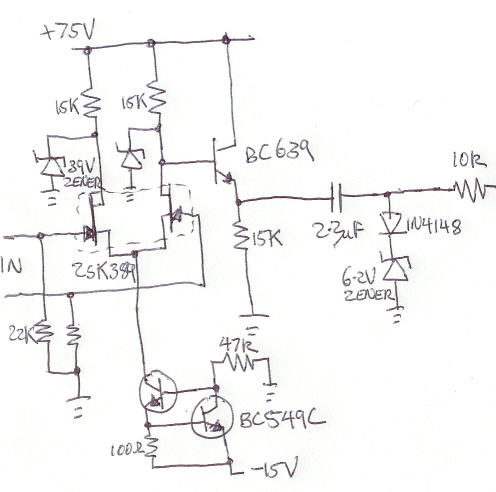

I did quite a lot of searching through prono preamp schematics today, both here and on Google, hoping to find what I was looking for: an SS minimalist balanced MM phono preamp. Either discrete or opamp would have been fine, I want it to be balanced and low parts count. Believe it or not, even with the dozens of designs out there, I could not find a single example of what I was looking for. Plenty of balanced discrete designs, but BIG parts counts. Plenty of opamp designs, but all single ended. I'm just hoping someone here knows of one that missed my long search.
I have just recently built a preamp with a balanced phono section. It has a FET differential input stage, with CCS, functioning as simply a gain stage. The FETs are low noise (2SK389), which combined with the stages gain gives good noise performance of the preamp. The output is then converted to single ended (taking the output from only one of the drain resistors - a proper balanced to SE convertor could be used, but the way I have it works fine for me). An emitter-follower stage is also used here to give low output impedance to allow the gain in the next stage to be set easily.

Please note also that the input FETs require about +75VDC rail, in order to be able to use a high enough drain resistor to get high enough gain (without using a very low current which would sacrifice noise performance). To get this, as well as the standard +/- 15V rails, I used a voltage quadrupler on my transformers 15-0-15 VAC output to get ~90VDC which is then regulated to 75VDC. You could use a separate transformer, but this may not be convenient.

I'm not sure I understand the benefit of having a differential gain stage only and then immediately converting to single ended in the proceeding stage. Does the differential gain stage alone improve common mode noise rejection? With or without a transformer?
leadbelly said:I'm not sure I understand the benefit of having a differential gain stage only and then immediately converting to single ended in the proceeding stage. Does the differential gain stage alone improve common mode noise rejection? With or without a transformer?
Given that your line stage is differential, as is your planeed power stage, it makes no sense to collapse a balanced phono stage to SE.

As requested, I have attached the schematic. To avoid any possible copyright infringements I did not include the active equalisation section - it is just as in the link in my previous post. Note that the zener diodes provide protection against exceeding the 50V drain-source voltage of the FETs and also against the high input transient to the opamp at turn on.
To leadbelly: the purpose of having a differential input to me is to improve the CMRR and also to prevent induced hum on the line from reaching the output. Because of the amplification the FETs provide, any further induced hum or noise will be much smaller in comparison to the signal, hence a high SNR. I converted to SE here because I could not find out how to actively equalise in a balanced fashion - very little information is available on this (after much googling). I don't really like passive eq that much - I don't think it has as good noise performance (someone please correct me if I'm wrong) - so I switched to SE for the equalisation (the system that the preamp is for is SE anyway, so I would have had to convert sooner or later).

Using the Barry Porter design myself. But it is a balanced input stage only using LM394. Guess you will have to rework the feedback networks to differential ones. Not impossible, but a lot of work for a lot of components more. Expensive components in this case.
But a differential input does indeed provide all the cmrr you need. And it is substantial. In order to get everything out of it you will very likely need to rewire your arm. Having a single twisted pair straight from the cartridge to the preamp makes a difference.
