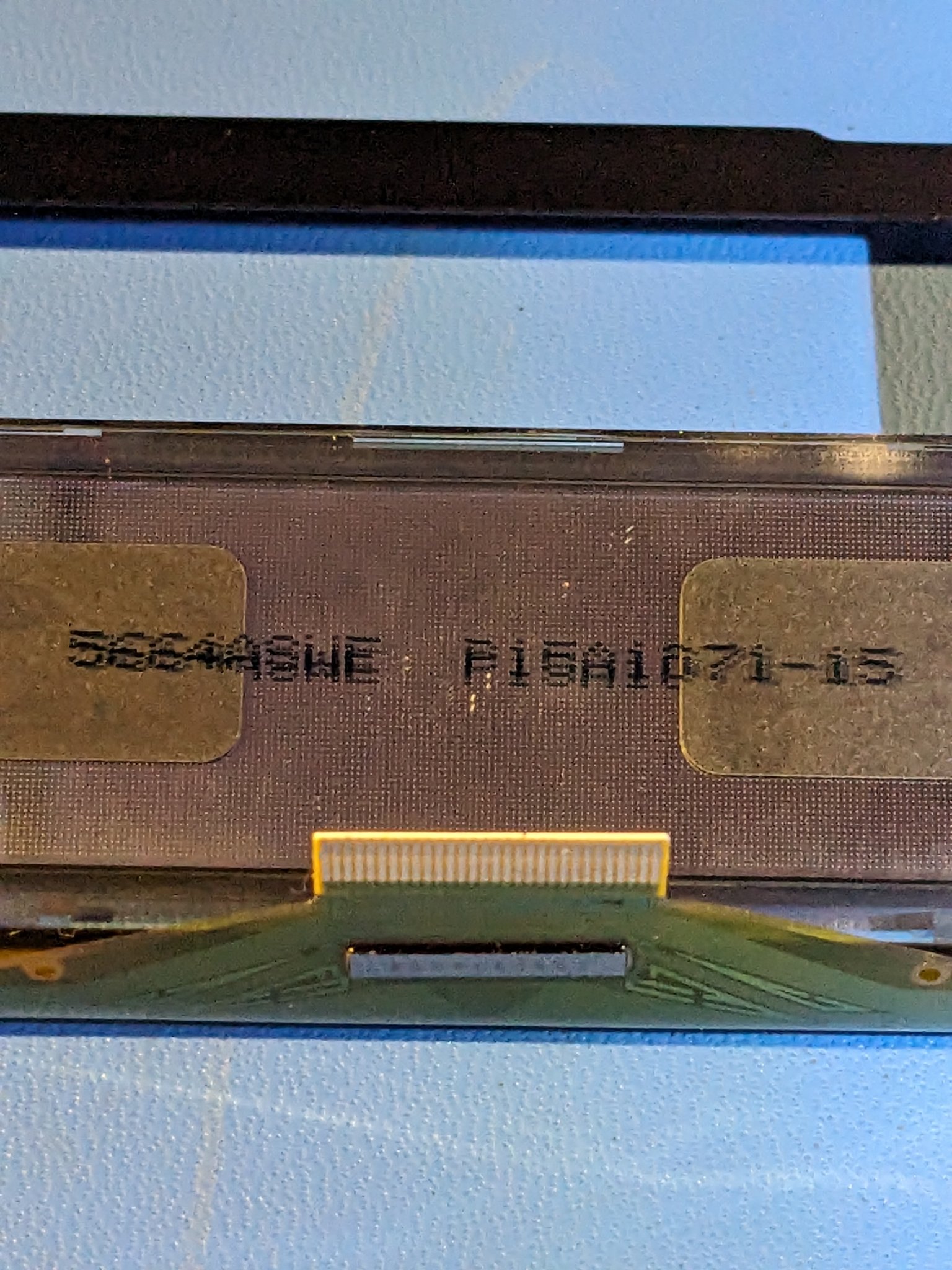

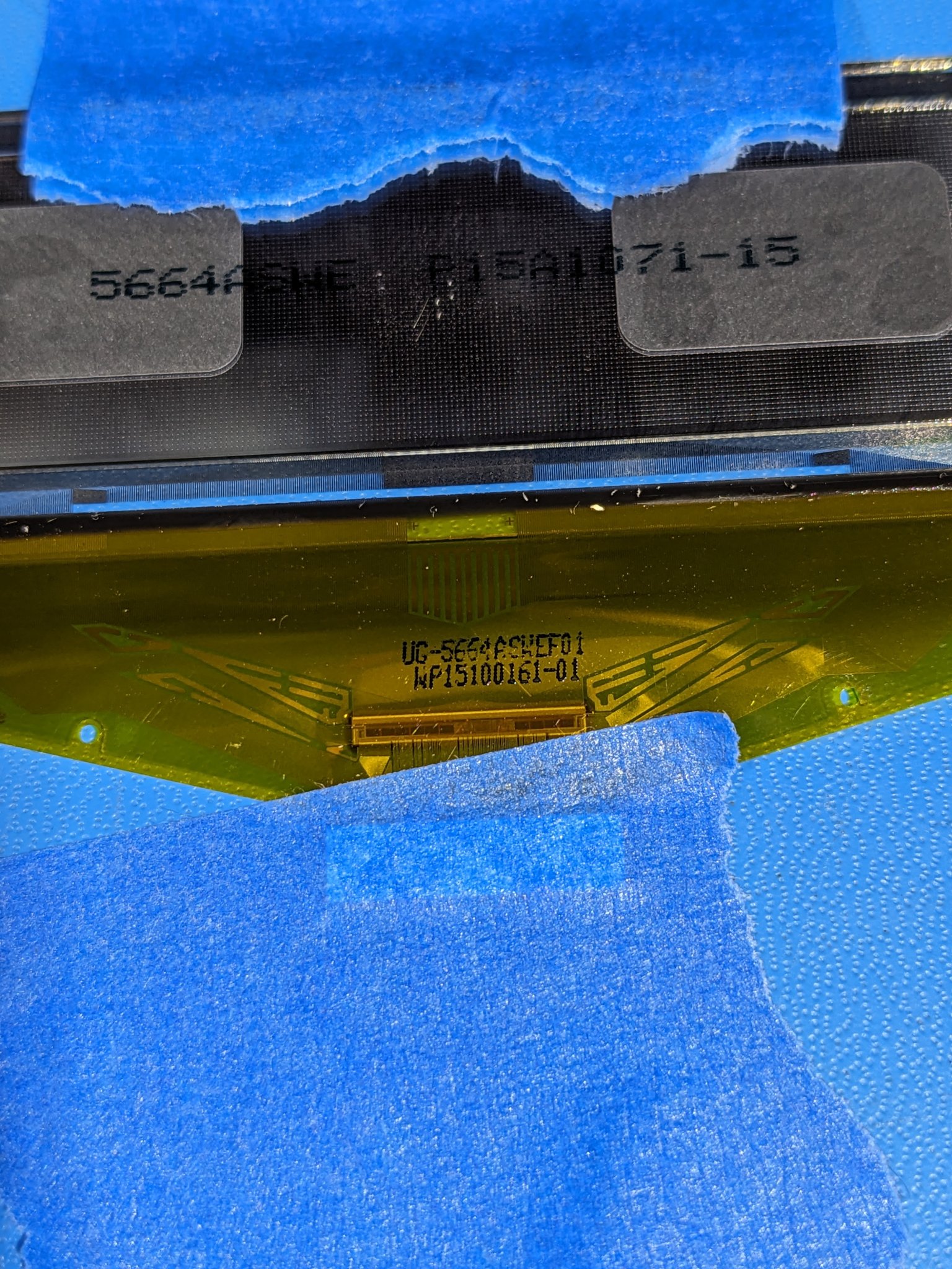

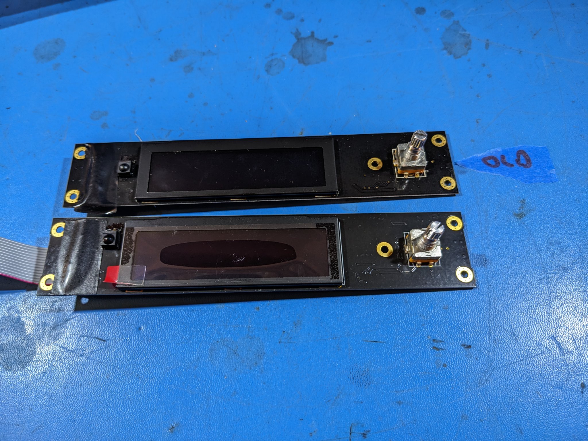

I just replaced the front panel board on my 1st generation SHD, the OLED display pixel fade had gotten really bad. miniDSP sold me a replacement module out of warranty.
Here are some pics of the actual OLED part in case anyone wants to hunt for a second source.
Seems to be a fairly inexpensive, readily available part. Can even get them in different colors. This is just one example (need to remove it from the PCB)...
