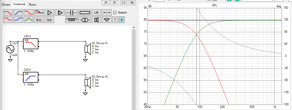

1. LR24 includes 180 degree phase shift at the knee. High pass and low pass at LR24 at the same frequency are perfectly in-phase at the crossover frequency. Not taking into account acoustic delay between drivers, the pair of LR24 filters will sum flat.
2 and 3. Generally one would set up delay values relative to the tweeter, so tweeter include 0ms delay, any delay of other drivers would be entered relative to the tweeter. Required delay will vary by driver, location and acoustic frequency response, so should be determined by acoustic measurement. It is not as simple as taking a ruler and measuring from one driver VC to the other.
Dcibel, thanks for the response on this. I will definitely be doing some measurements to verify everything, I just wanted to see if my thought process/reasoning was solid. I think I understand; even though there is an electrical phase shift at crossover, it's not really inducing a delay of a full cycle...JUST an electrical phase shift, correct? Thanks again.
Phase is derived from the frequency response. Electrical frequency response is directly transferred to the acoustic output, which is often referred to as the "transfer function". That is to say that a phase change in the electrical function is also a phase change in the acoustic output.
LR24 high pass will be 180 degree shift at the knee, but LR24 low pass will also be 180 degree shift at the knee. So even though there is 180 degrees of phase shift, the two filters remain in phase and sum flat, which I've shown above. Given this perfect theoretical example, no delay in either driver is required. This of course doesn't take into account driver location and actual driver frequencyt response, which is why real acoustic measurement is required for any accuracy, and you'll find that these basic "textbook" filter transfer functions are rarely the correct solution.
I mentioned previously, all the DSP functions and resulting response can be easily evaluated in VituixCAD using the active filter blocks, just set miniDSP as the DSP system in the options. The blocks can be directly transferred to your DSP with accuracy when doing this.
