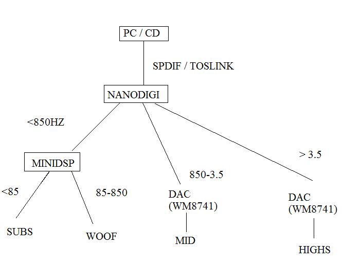

At it´s price range the minidsp is the best option , i own both minidsp 4x10 and nanodigi. I use the nanodigi as 3 way crossover and the minidsp as crossover and dac for subs and woofers.
