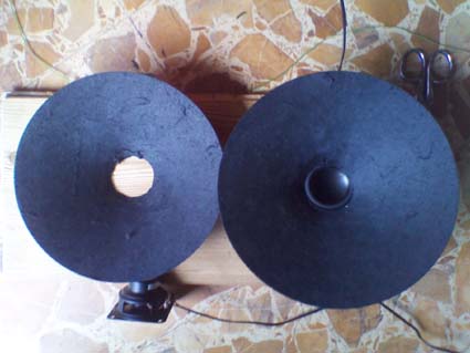

Well , the price of about 15 € might seem high , but nothing compared to his brother SPX-20 that costs double ,which has a larger VC diameter , 25 instead of 20 mm of the SPX-21 , but less Xmax . It also has some less power , but I plan to use
it as a mid-tw , coupled with a wave guide , which raises the pressure level of about + 3 dB !
I just received them the other day so there's still a lot of work !🙂

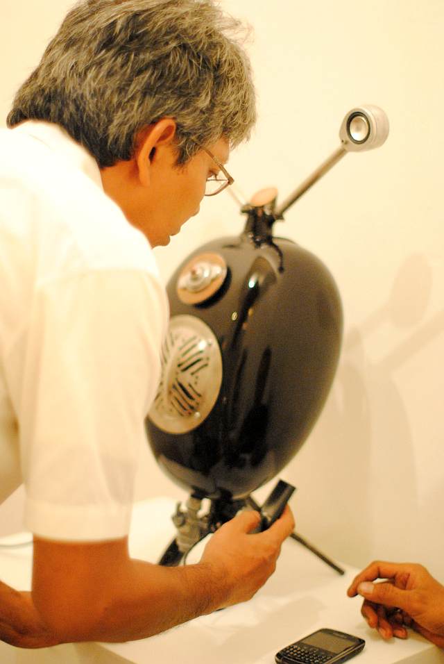

Well, I've worked with a pair of that small TB's on my friends sculpture. Square flanges made round, placed inside turning light housing and I can say that you'll be nicely surprised with the sound quality of these tweeters. They can go quite low with nice non intrusive highs
