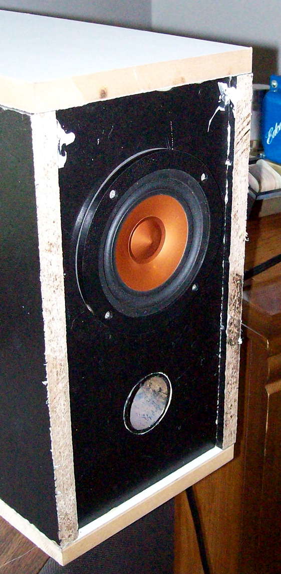

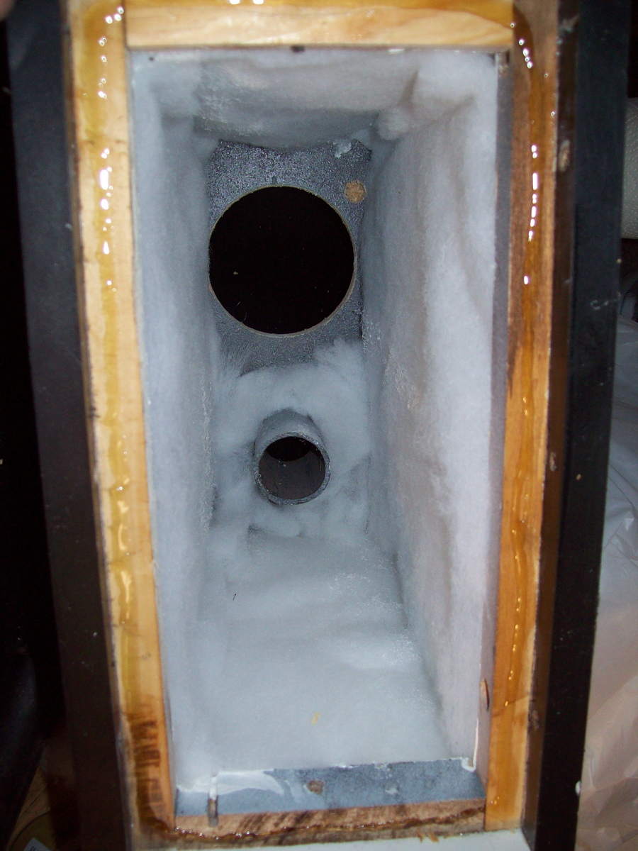

Cobbled together a 1/2 cubic foot ported enclosure from scraps on hand and lined it with poly batting...
attachment.php
attachment.php
It worked quite nicely and extended the response solidly below 50Hz but 4" just seemed like it was working awfully hard to get the output.

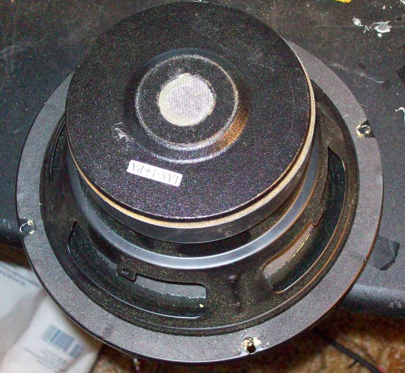

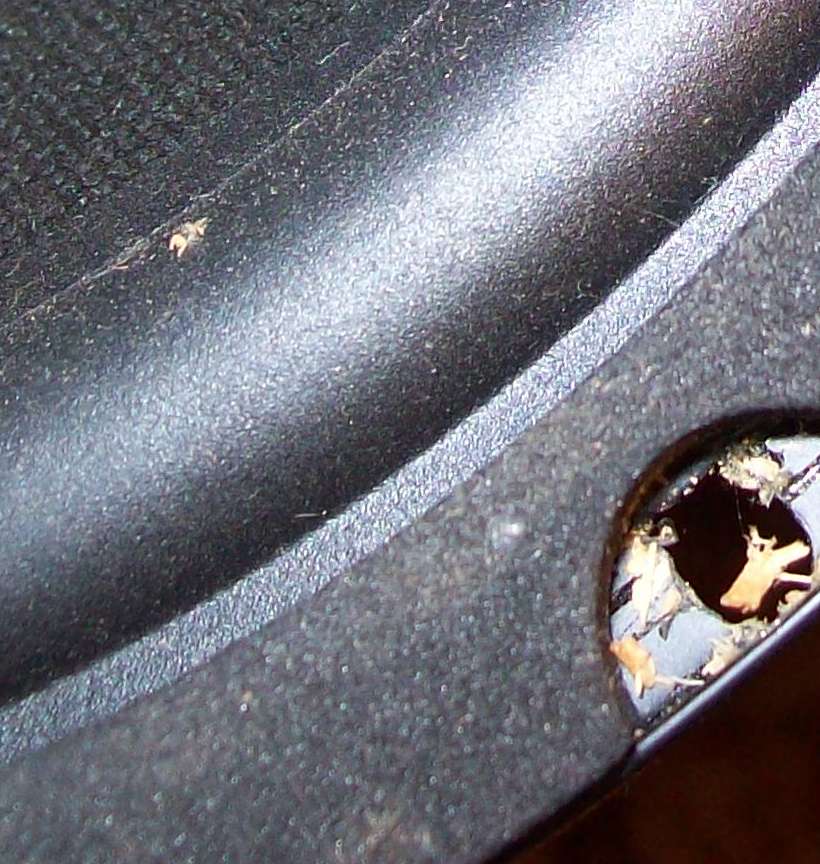

Other than microphonics my main concern had been the added cost and weight of the integral sub. I went back and looked at an 8" subwoofer driver that I had on hand. It was removed from an AR powered sub that I got over 15 years ago and so I dismissed it out of hand as too old to be used in a gift. I took a look at it today and I am having second thoughts.
I had assumed that the surround would be getting long in the tooth but as I look at it it I see no indication of deterioration and I am tempted to give it a try. Buying a small plate amp would really cost no more than the passive crossover and if I didn't have to buy the driver too... maybe.

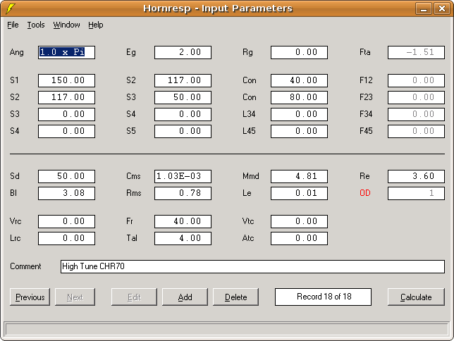

Ported alignments don't seem to be very well behaved for the amount of gain that I get however several TL approaches looked promising. Some time in the next few days I will try to get around to rerunning some of the sims and saving the results to post here. One of the most promising was a TL tuned to around 70Hz IIRC. The output levels shown were much higher than the sealed (and even higher than the ported).
If I am remembering correctly it was approaching 100dB in the pass band at just a couple or three watts. I estimate the amps capability at around 8 watts but again in the bass we are Xmax limited to this level. Of course stuffing and the real world will probably shave off some of that output but that should still be adequate.
Going strictly from memory it was a 120cm long tapered line with the closed end at 150cm^2 and the terminus at 50cm^2 driver located 1/3 of the way from the closed end. After converting to inches it looks to me like a two fold (three segment) line of this length should be small enough to work.
IIRC the response begins rising at around 120Hz till the tuning point of around 65 or 70 Hz where it is about 3 or 4dB higher and the of course drops precipitously. If the filtering were placed correctly I suspect that we could get the response to be essentially flat down to the tuning frequency. I could use passive first order in combination with the second order line level filtering to get ultimately a 3rd order response for additional protection.
I have been able to get nice looking responses with longer TLs down to 50Hz or lower but I don't like running it that low as you simply must have a lot of displacement to get usable volume (thus the subwoofer) and the size gets to be problematic.

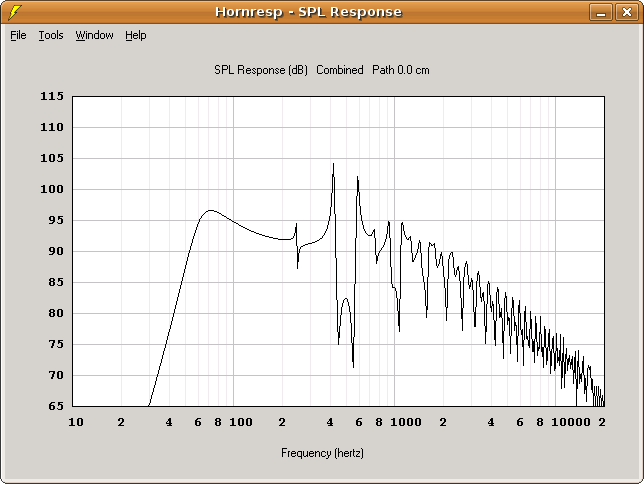

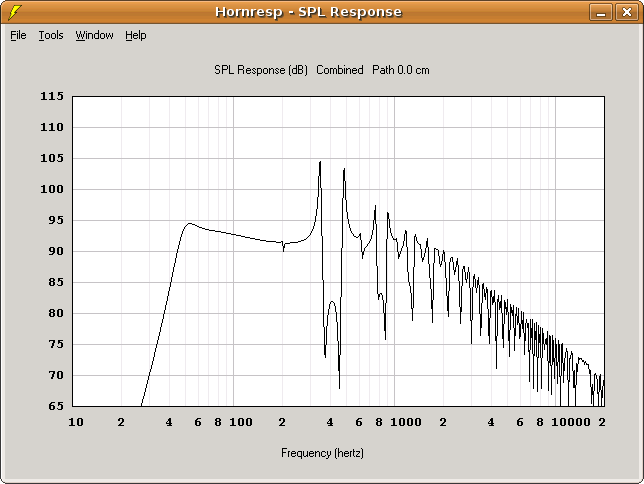

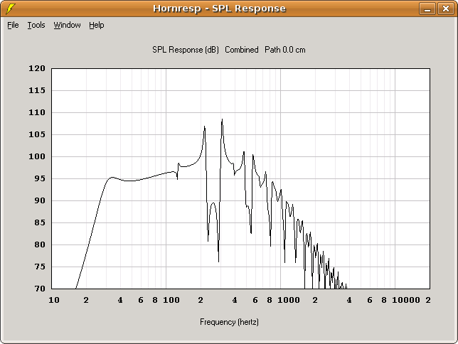

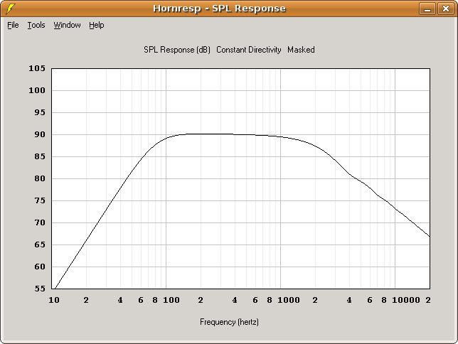

OK, got energetic. 🙂 Will compare 10 liter sealed with 3:1 TLs of length 98, and 120cm in length. I did sims at 108cm also but forgot to save some of the screen shots. Results were intermediate between these two however.
Will look first at 1 watt response graphs.
attachment.php
attachment.php
attachment.php
Clearly we gain a few dB of efficiency out of the TL and even in the shortest one we have useful output to 60Hz and even 50Hz in the longer line. Below 100Hz the sealed box is rapidly losing ground. It rolls of more slowly of course but to make use of that fact would require large amounts of EQ. which would stress the amplifier and no doubt destroy the drivers.

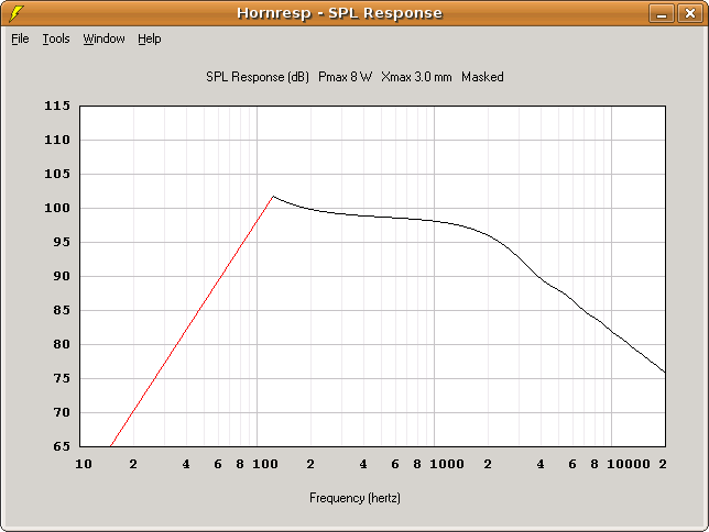

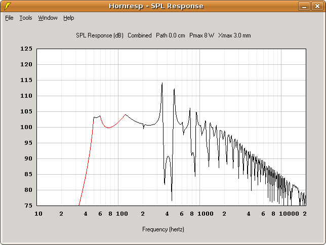

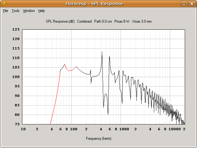

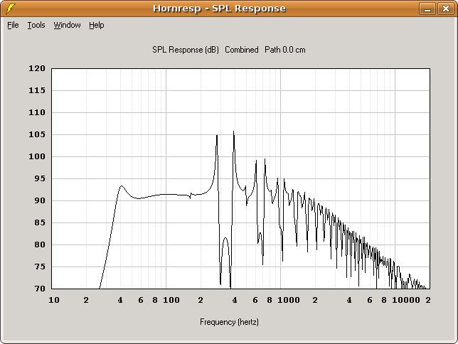

Here we look at the maximum SPL with 8 watts and 3mm Xmax available. Again order of screen shots is 10l sealed, 120cm TL and 98cm TL. NOTE: the segments in red are Xmax limited.
attachment.php
attachment.php
attachment.php
Both of the TLs provide higher maximum output all the way down to 60 Hz than the sealed can do at around 100Hz. The longer line holds 100dB all the way down to 50Hz. The shorter line give higher output all the way down to 60Hz than the sealed can do at any frequency given the limited power available.
With the tip up in response that the TLs provide we should be able to provide enhanced performance and acceptable safety margins with proper application of filters.
Right now I tend to favor the shorter line for its higher overall output (reducing the temptation to push its limits) and the greater up turn in response which allows for more aggressive filtering.

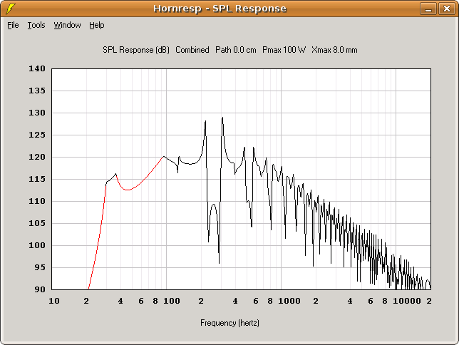

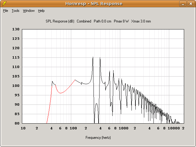

And just for giggles a look at the subwoofer in a 30Hz line.
attachment.php
attachment.php
Nice smooth output down to 30Hz (good enough for the 16' pedal stops even if we miss the 32s 😉). Guessing at 8mm Xmax it is holding 112 dB down to the cutoff. I just guessed at Xmax on this driver but I think that is a conservative estimate. Output could go higher if I am underestimating.
Will have to see how it acts in the real world.

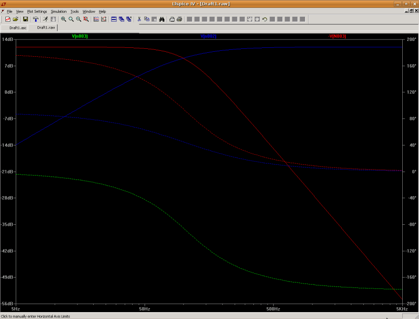

I got the parts for a passive crossover using 2nd order on the woofer and first order on the FR which brings up the issue of phase. If both drivers are using 2nd order than one usually inverts one however in this case it is somewhat less clear.
attachment.php
The dotted red line is the phase of the woofer when inverted and the green is with it connected in the normal fashion. If connected inverted the remaining output from the woofer above the crossover point is in phase with the FR and would add to the output in that region. If connected "in phase" it would be 180 degrees out of phase and subtract.
In either case the phase below the crossover is about 90 degrees out of phase no matter which connection is used. So in the bass region the resultant is probably going to be about the same so the choice comes in how we want it to behave above the crossover.
At first blush it might seem that one would want the phase equal so that the sound is as coherent as possible in the mid range, however, given that a TL enclosure will probably be used for the woofer the spikes and valleys that remain would either add or subtract from the overall output.
So in the end I might just need to try both connections. I have not yet purchased the woofers (next paycheck 🙂) but I will probably go ahead and build the crossover today or tomorrow and play around with some woofs that I have on hand.
