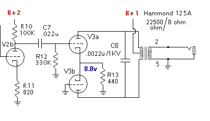

I found this schematic online and had a question about the output stage. It lacks a dedicated phase inverter and I don't see why this method of phase inversion was chosen over the option shown in the second image. Can someone explain? Any advantage to the design in the second photo?

That first design is a self splitting LTP/PA in one. This particular implementation is horrible. A 440R resistor isn't nearly enough tail load, and a CCS would be a helluvalot better (though it'll require a negative rail). It also enforces Class A operation, since the limit of plate current swing will be between 0mA and Itail.

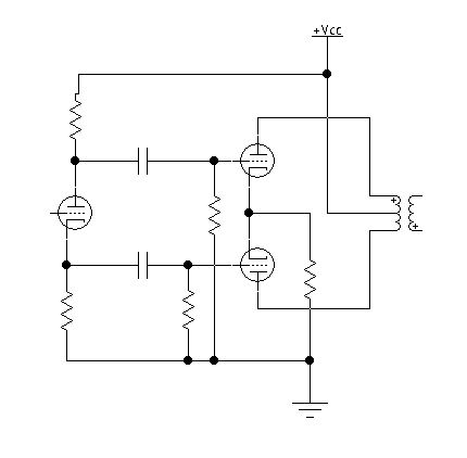

It will probably perform better than a cathodyne if your DC rail voltage is limited. (In that case, you could always substitute a MOSFET for a triode and use that for your cathodyne (sourceodyne?) splitter instead.
The phase splitter (first triode) in the first schematic has zero gain. The gain stage in the second schematic has a good deal of gain but the output tubes have less gain since they operate as an LTP with a shorter than usual tail. There are trade offs in both cases and the self split version (second schematic) will have a somewhat lower total power output and imperfect balance. This will cause it to sound somewhat like an SE amp, but allow the use of a P-P OPT.

I thought the 2nd pic IS a cathodyne PI.
The first tube in the first drawing isnt a phase splitter. It's just a gain stage. Shouldn't a plate follower have some gain?
The second stage doesn't have a gain stage. It's just a cathodyne phase inverter (from what I understand).
I'm wondering why that designer chose to build the output stages the way he did. My thought was he could have made better use of that first triode as a PI. If he required it for gain, he would have been better off paralleling the triodes of V3 and wiring it for SE to keep his first triode gain stage.

The bottom schematic is a conventional design and the first stage phase splitter has no gain. The unbypassed cathodes in the output stages will cause a mild gain drop as long as the tubes remain in class A and a rather serious gain drop if driven into AB teritory. The output impedance increases in both cases. Add a cap if you need more gain.
The top schematic is a self split output stage that acts as a rather imperfect LTP. The input stage does indeed have gain. The major advantage here is a low parts count, since it doesn't do anything real well. It does allow the use of an ungapped P-P OPT in a circuit that provides a somewhat SE like sound. I am exploiting this property in a guitar amp that has $40 in total parts count. The extra output tube costs $1. The difference between a SE and a P-P OPT is $7. The design works but I can't get the THD below 2% at any power level and it rises with power output. It's good for a guitar amp, but I wouldn't try it for HiFi.

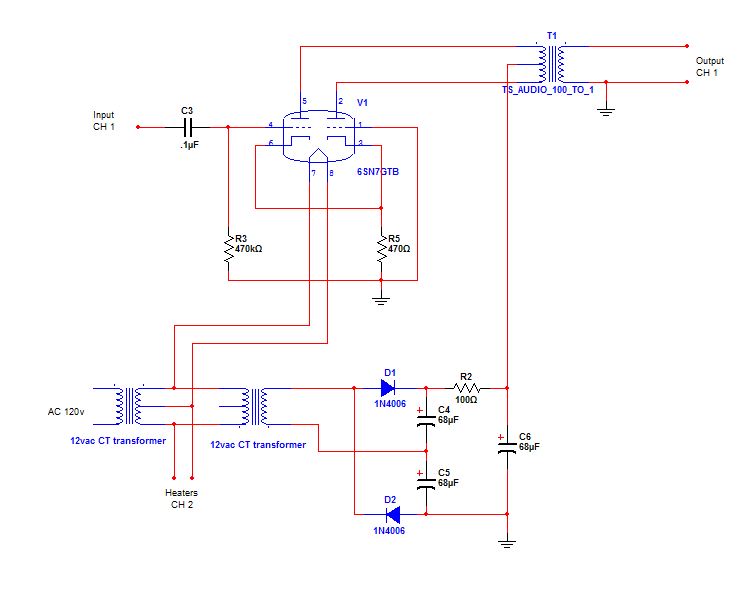

Not to bump an old thread but I did refer back to this a few days ago and built a self-split PP headphone amp with a pair of 6SN7s and some "too small for speakers" OPTs.
It sounds rather nice. Might be an easy starter project for someone. It's built with two 12v CT transformers.
